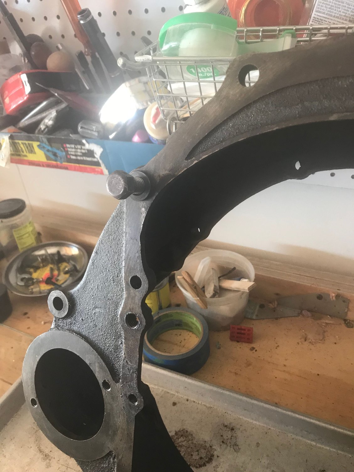

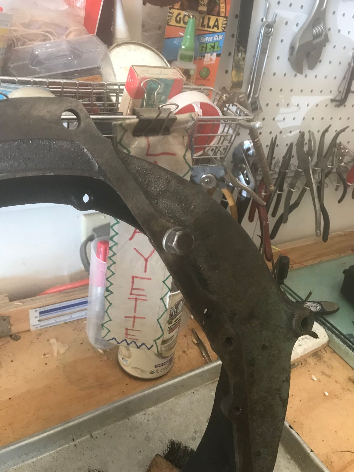

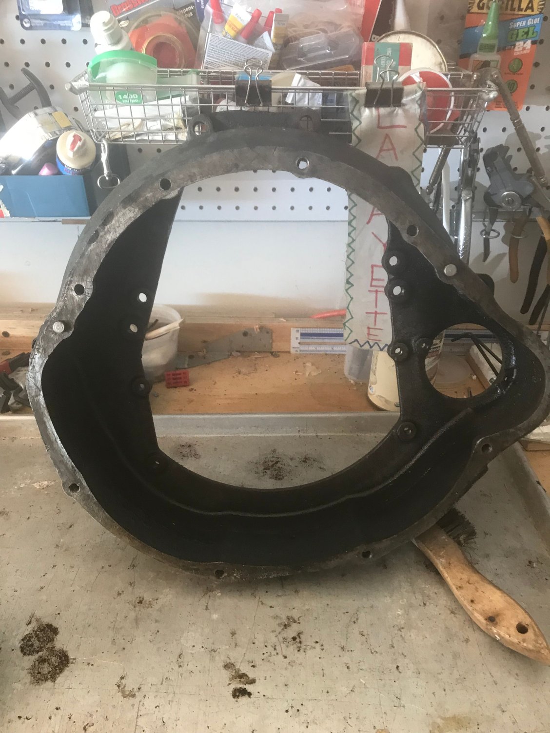

I stumbled on to this thread, not sure if anyone still cares about the topic.
I want to use a 49 H engine with a 47 g drive line.
I have everything from the bell on back, unfortunately a torque tube and banjo rear.
The bell fits the H crankcase except for 2 bolts, Both these spots the 49 case AND the 47 cast bellhousing are threaded at the joints, I was hoping it would swap. The bolts are 7/16x14, not a lot of room for bolts or for repair studs an nuts behind the flywheel as someone suggested to me, plus one bolt hole doesn't line up at all.
I was gonna go for the T-5 swap, but I'm kinda in love with the old stuff. I'm thinking about all kindsa ways around it, but would love to hear any comments or suggestions...

more on bellhousing
this is my bell, looking from the rear and right side up.
this boss is not lined up with my H which is a ‘49.
this boss will have to be relieved
this is my bell

I just went out and hung my bell, like the one that you have pictured, on the 254 cu.in. engine and I see what you are talking about. However when I bought my truck this bell and transmission was attached to the 254 and I drove it like that. Now, I have a 226 H series in my pickup with a later 3 spd. toploader and the pressed steel bell housing.
