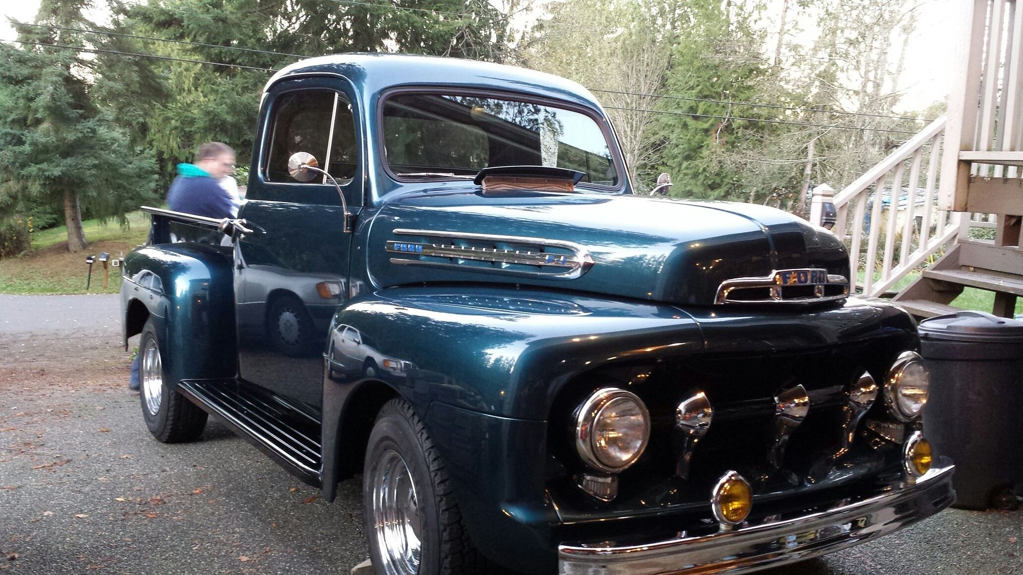

Here is the truck that I referenced in my previous post...

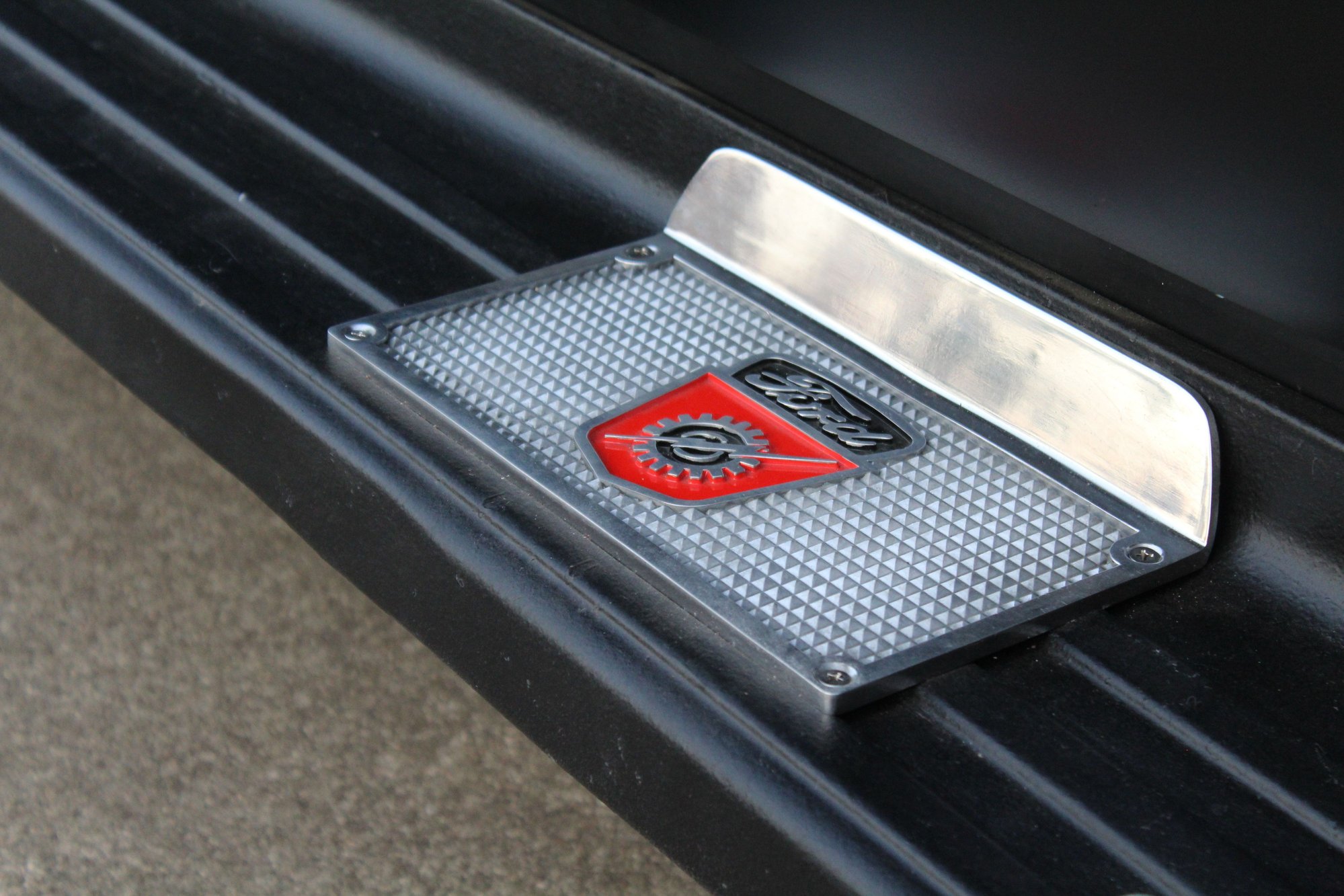

With mine I just used roll-on black bed liner. Works with the flat black paint. Only photo I currently have that shows it up close.
