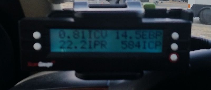

Think I may have a high pressure oil leak in my 06 F350 with about 122K miles. Last couple of days it has been taking about 8 seconds of cranking to get her started when warm/hot.
FICM: 47-48.5v recently done by Ed
Batt's looks good
Sync good
KOEOff:
ICPV: .22v
ICP: 0psi
IPR: 14.8
KOERunning (At temp)
ICPV: ~0.8v
ICP: 580psi
IPR: 22.2
Cranking when hot:
ICPV: 0.55v
ICP: 350psi (according to DTR, this should mean my IPR is good and not plugged)
IPR: 85
The SGII may not refresh quick enough to show that once it gets enough oil, she will start.

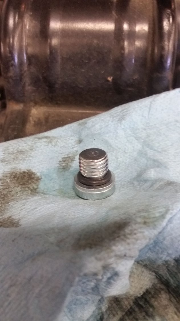

Is this plug for the drivers side icp port?
Old Feb 4, 2017 | 11:32 AM
WatsonR's Avatar
WatsonR
Joined: May 2014
Posts: 6,545
Likes: 13
From: Virginia Beach VA
Shouldn't matter on the side, that's the plug. Even the oil rails don't matter which side.
There's your problem.
