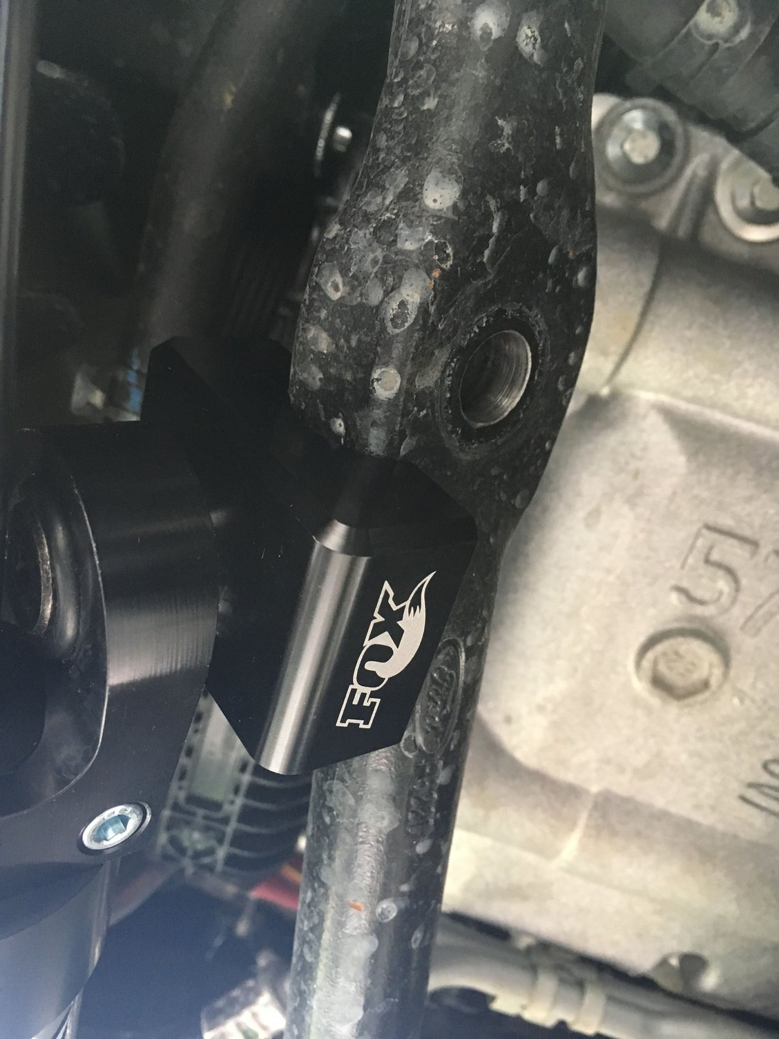

It's a billet type clamp with 4 allen head type screws.

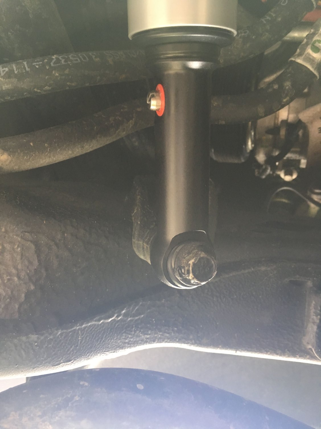

It the "eyelet" end long like in the picture? The one I had on a jeep looked the same but the black eyelet part was 1.5-2" shorter.

Mine has the same long "eye" end. It has the same part number engraved on the end as yours does.
My stock stabilizer was part # 24-19624
Measured 16 1/2" compressed and 28 1/2" extended from eye to eye
The Fox says 17.15" collapsed which is why it doesn't fit. If I put the clamp where yours is, my eye is sticking past the bracket by nearly 1". I can't tell from your pix how many threads that you have going into the other side of the clamp but our tie rods might be the same diameter

I like it better than the factory stabilizer, it's a noticeable improvement. I have the adjusting screw adjusted 4 clicks out from all the way firm.
The gap on the billet clamp might be 1/8" on one side and a little more on the other. I can get exact gap measurements if you need.
I would mount the eyelet in the factory hole, and clamp it on before the drag link hole like I did and cycle it back and forth. I bet it's good. With the shock shaft being a through design, I don't think fully compressing it matters. My steering cycles fully to the steering stops.

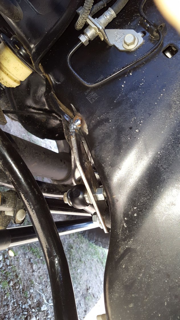

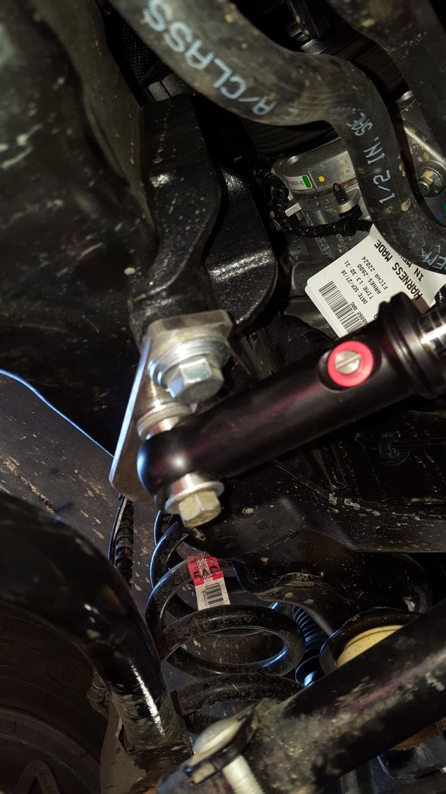

Just using the factory location I could not get full lock to the right because the rod bottomed out against the cylinder. So I built my own bracket to extend it about 1" farther. Due to the front sway bar I had to put it at an angle. So that it wouldn't move I welded the tip of my bracket to the frame. Mine is currently sitting on 21 clicks, any more and turning the steering wheel starts to get hard. I will drive it awhile and see if my 4 hours of work was worth it.
