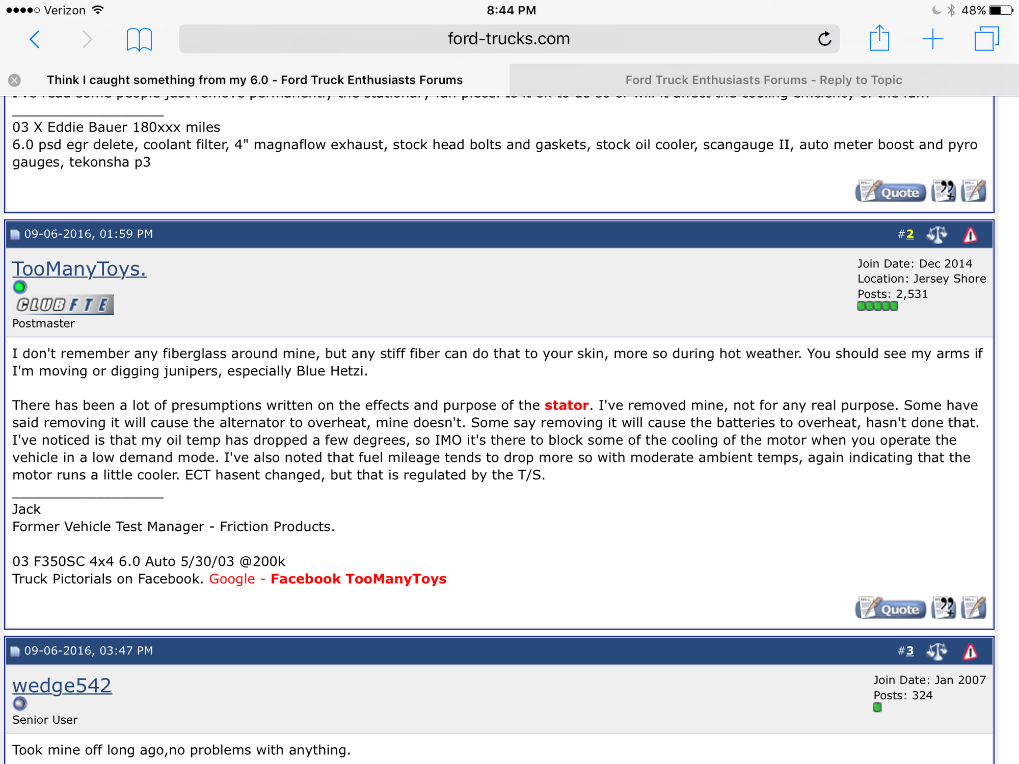

I noted this in another thread weeks or months ago, without the stator I saw a drop of ~3°F in oil temp.

TooManyToys.....
any link to the old thread? Searched but can't find it!
Old Feb 1, 2017 | 07:45 PM
TooManyToys.'s Avatar
TooManyToys.
Joined: Dec 2014
Posts: 17,829
Likes: 3,114
From: Jersey Shore
https://www.ford-trucks.com/forums/1...l#post16553193
