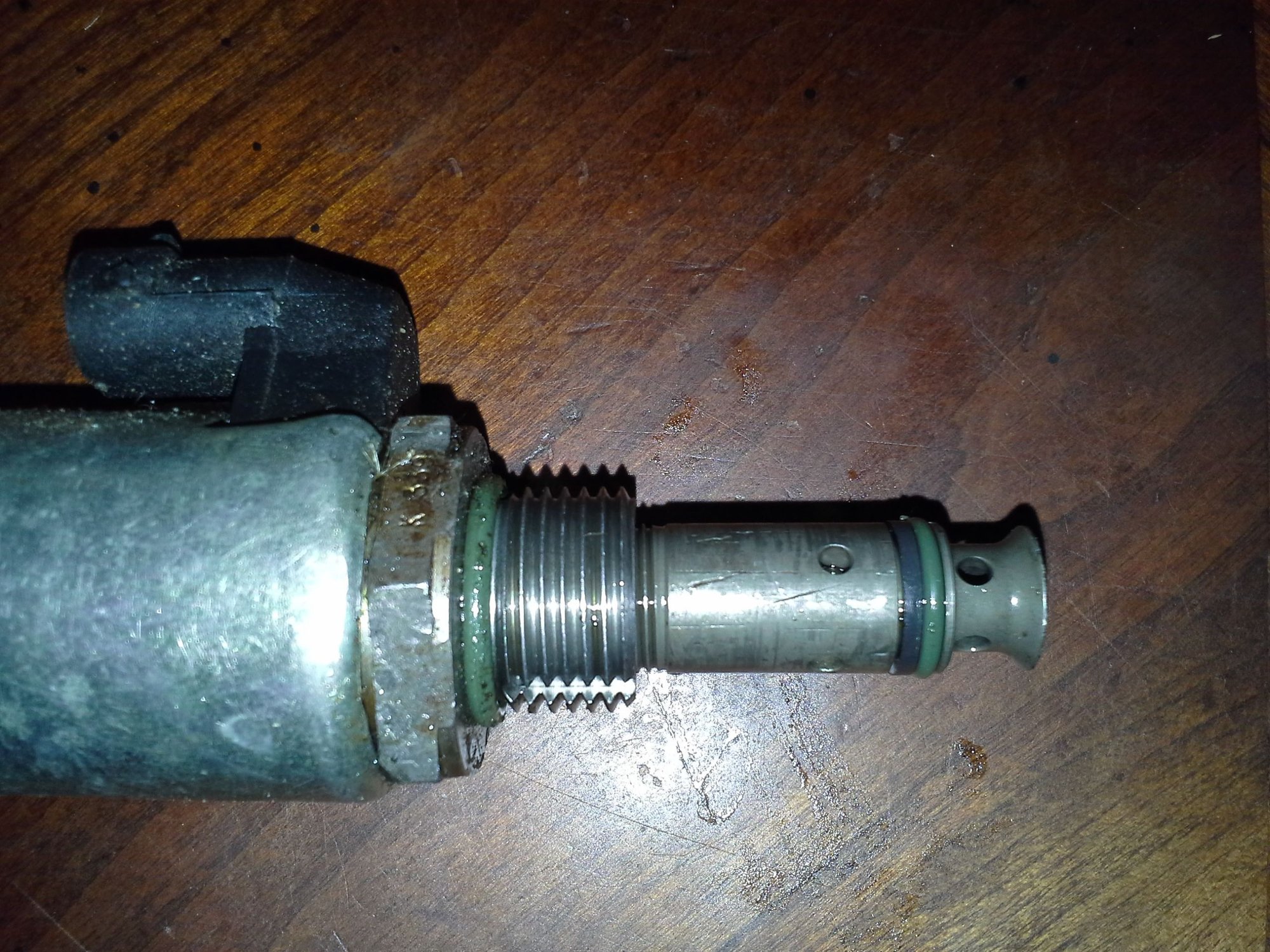

Here are some IPR photos to help you out:
There are two o-rings, but the one close to the end is critical to proper function under high pressure. the IPR comes apart (unscrews) and can be cleaned of debris internally

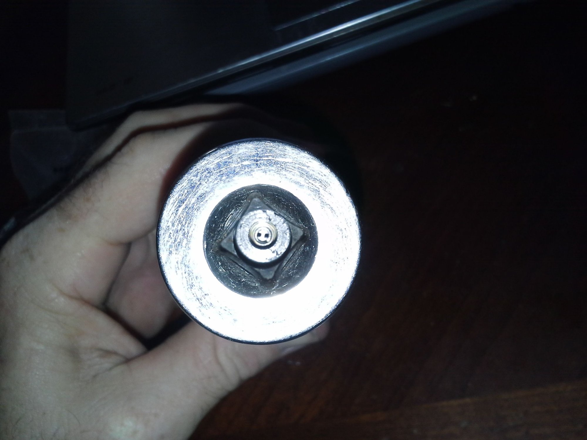

You will need one of these as deep as you can find. this one is just over 3 inches long and works great.
Drill out the base with a bit the same size as the IPR shaft. The drill bit I used was just small enough to not touch the square sides of the drive end.
Perfect fit and can still get the ratchet on the socket.
