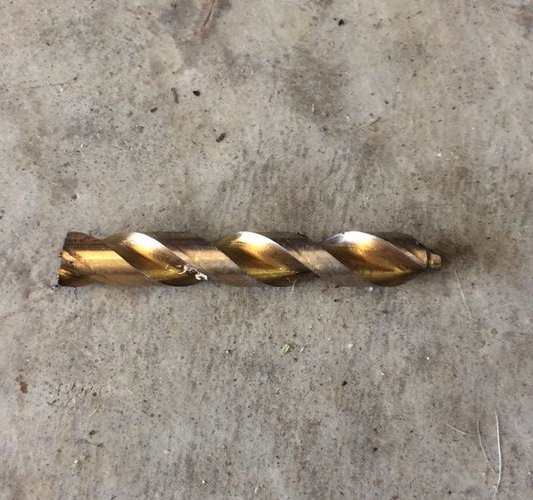

My truck did not have ANY wiring in the doors, nor any grommets for wiring, so I had to get creative. Using a step bit, I drilled the doors from the inside until a grommet would snap in. When it came to drilling for the cab side, I had to scratch my head. I do not have a right angle drill, but needed one. Not wanting to go out and spend $200+ on a drill, I grabbed my right angle die grinder. I grabbed a 1/4" drill bit, cut it off so that it would fit in the grinder and snugged it up. This worked like a charm.

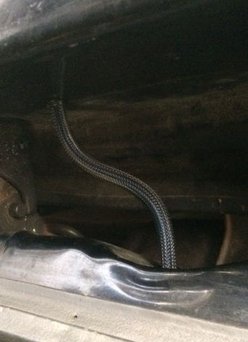

I plan on putting power door locks in the next time I have the door panels off, so I went ahead ran all of the wires in some fire braid, popped in the grommets and fished the wire with some TIG wire into the dash.
