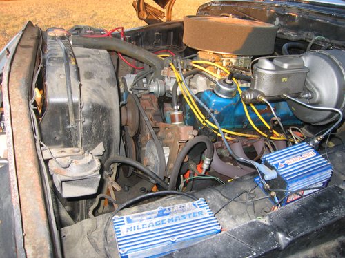

Standard Radiator, Manual Trans, No AC, 400M, 1977 F250 (19" Tall)
