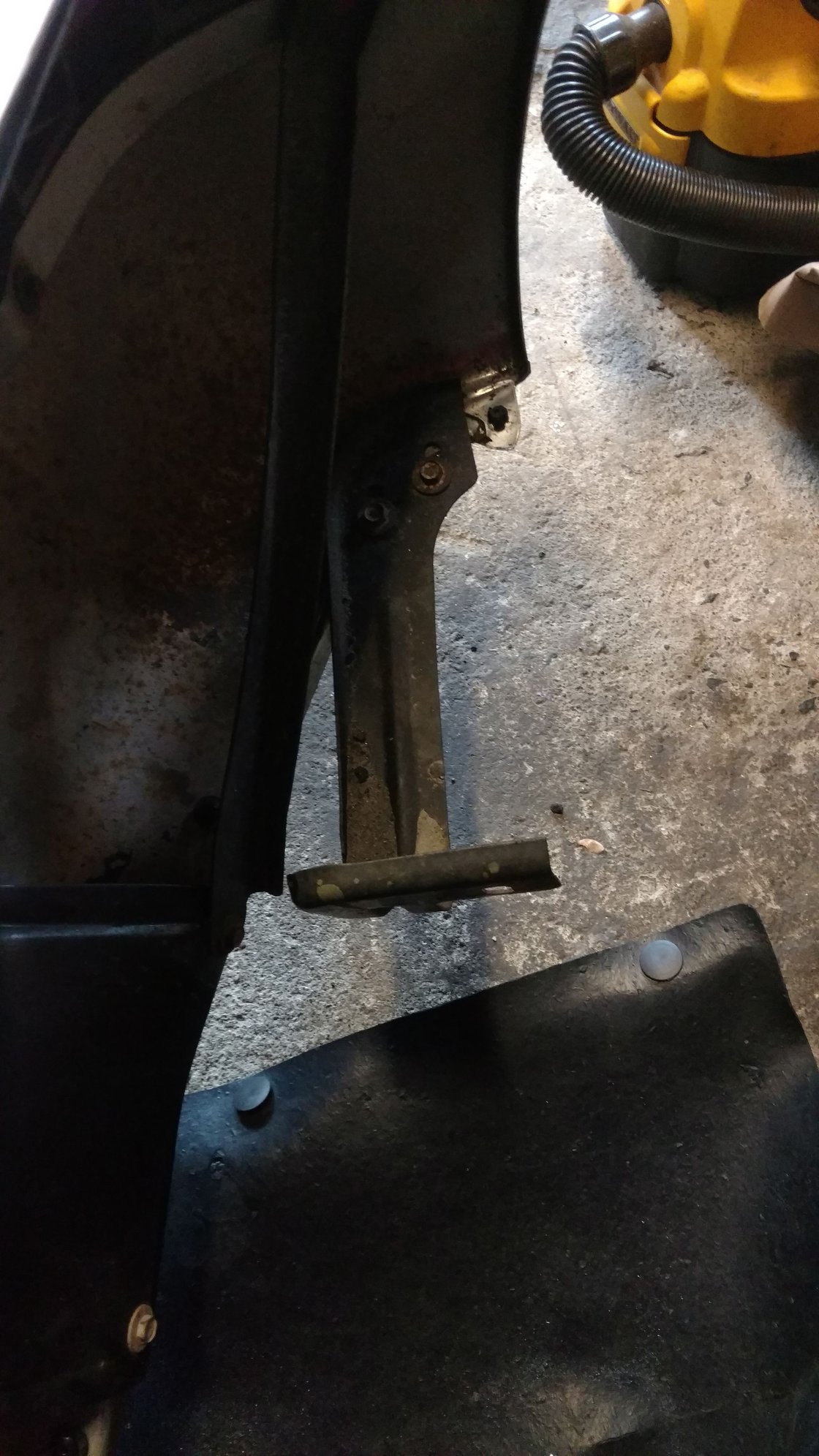

This is the support bracket from the 2011 bumper the bracket was originally flat on the left hand side of the picture but I bent it so that one of those holes will line up with the hole from the original bumper support.

In addition that bracket you have in the photo on the chair I have those as well but for the life of me could not figure out where they go? Could you share how those are installed?

Thanks and also if you don't mind explaining or sharing where that bracket on you chair installs. Without looking at another 2011 to 2015 I have not been able to figure it out.

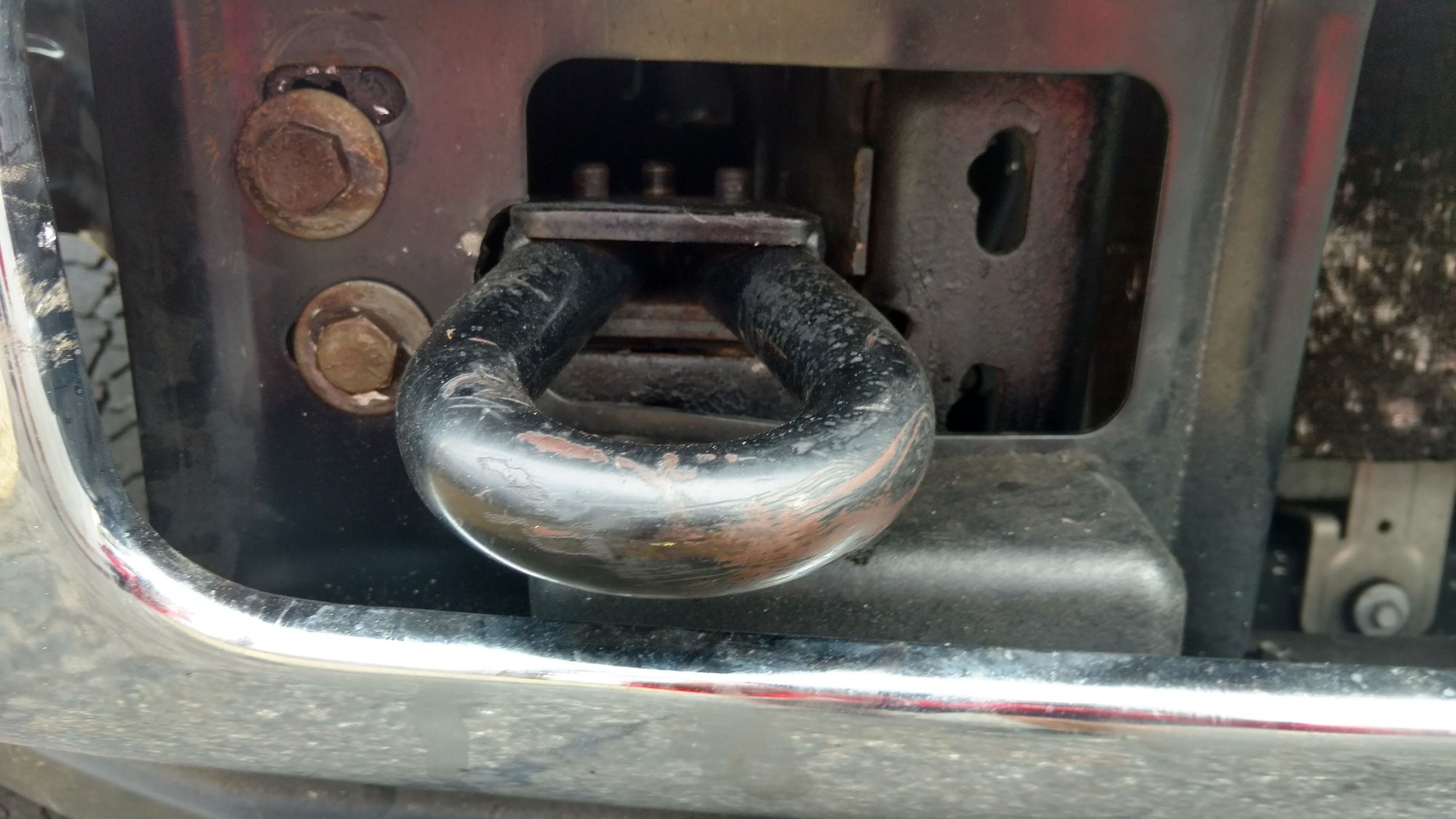

Here's the finished product

here are the tow hooks
Here's the bracket I showed in the pictures above it replaces the bracket shown below
Here's the bracket from the old bumper, there's only one hole on the frame so you could either add a hole or just do what I did and line the bottom hole up with the one already present.

It's a bit hard to explain but I believe the brackets are basically a support for the outsides of the bumper. it bolts up to the bracket on the very end of the bumper which you can kinda see in the picture and it runs into the bracket on the truck side of the picture

No I get the idea now and that is what I thought it goes to but just couldn't understand knowing the old brackets were not the same. I see how you made the Hooks fit so I may just do the same. Once I do the full conversion down the road that front plate that you cut to fit the hooks will be removed anyhow because you have to cut back on the frame rail.

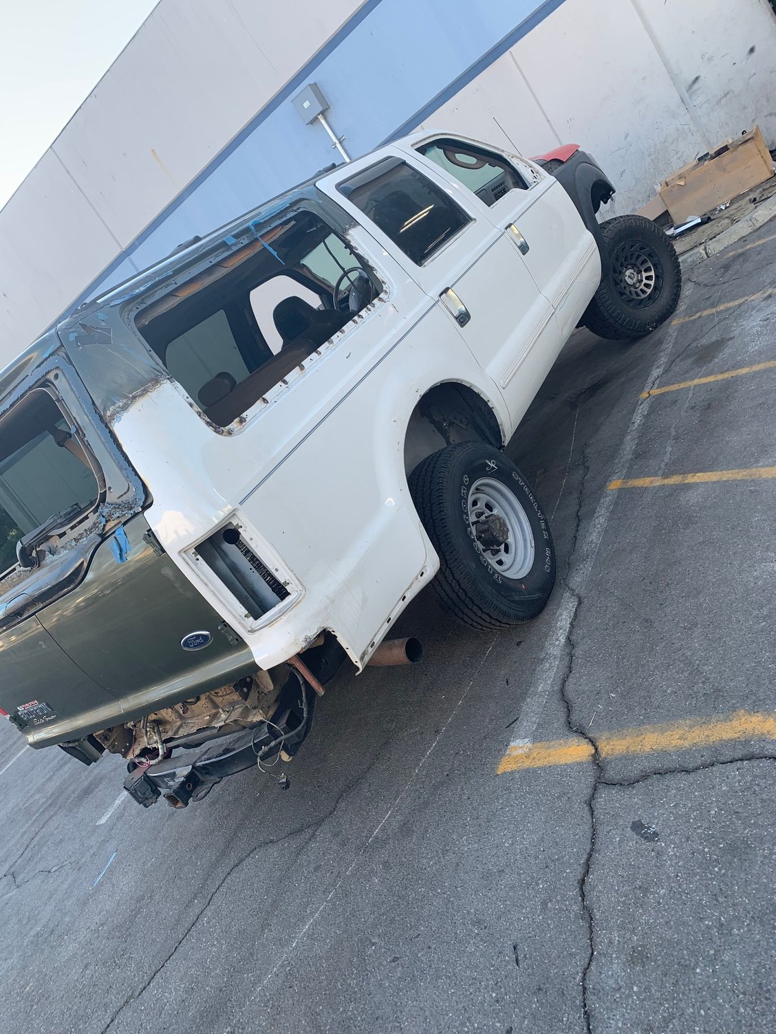

October 23rd update
Getting close. Body was welded this week.
