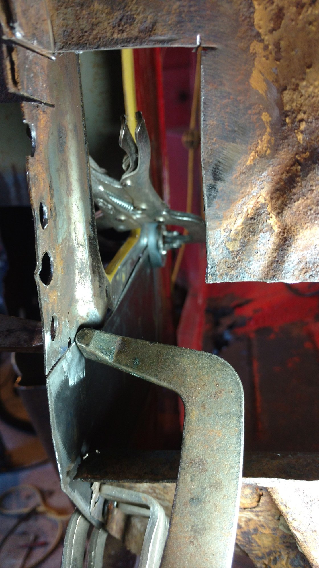

A little weekend update. I finished fitting the passenger side kick panel.
Got it welded in. Yeah
Still have to make small patch behind vent flange. I started working on the door pillar. I need to work on the hinge mount, there is a double thickness piece the goes between the hinge and the pillar. This piece will need be made in three pieces.

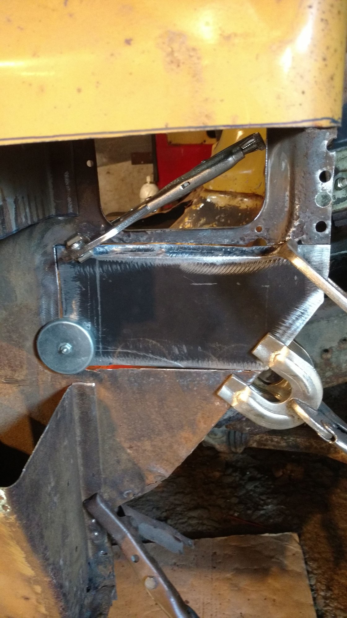

I got a little more done today. Been working on the door pillar to hinge. The gap between these pieces is a little more than 16 ga so I used 14 ga sheet metal.
I got the new piece made I put it in and out about ten times before I was able to get the holes drilled fro the bolt. Measure 100 times and drill once. I got it. Welded the nut on. Fit it all one more time before I weld the two pieces together.
Marked and drilled the holes to rosette weld the 2 pieces together. Cleaned and used some weld-thru primer.
Got everything pu together and cleaned up the welds. It all came out better than I thought it would.
I will work on the top part of the pillar before I weld this piece in. All in all another good day of progress.
