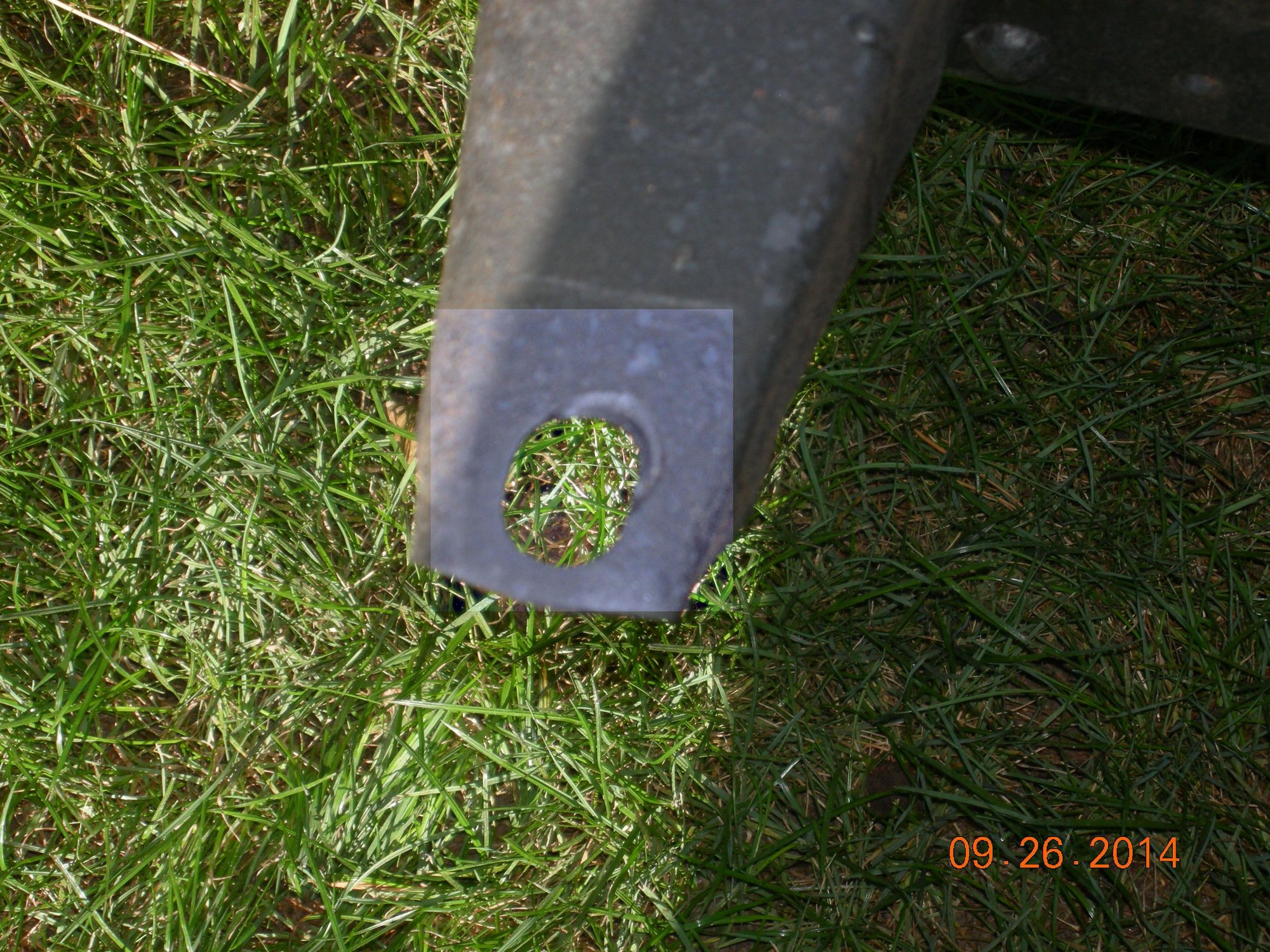

I would check your cab mount bushings particularly in the rear. Then check your 4 front frame mounting holes for wallow (see pix).
These mounts will impact a lot of things including hood closing efforts and alignment.
BJ is right about the availability of the adjustable rear mounts but you should not need them unless your frame is warped. I would check everything else on the cab mountings first.
