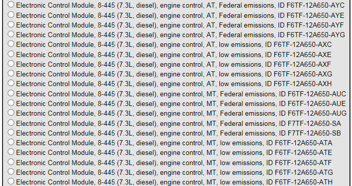

It all depends on what he has.. auto vs. manual, federal vs. cali. Here's a list of all the ECU part numbers listed on car-part.com

Spare PCM wouldn't be a bad thing to have anyway. This - PCM Codes - 1994-1997 Power Stroke FAQ - will tell you the correct PCM code, and that's the best thing to go by. Even with car-part.com, contact the yard to confirm that the PCM code matches.
