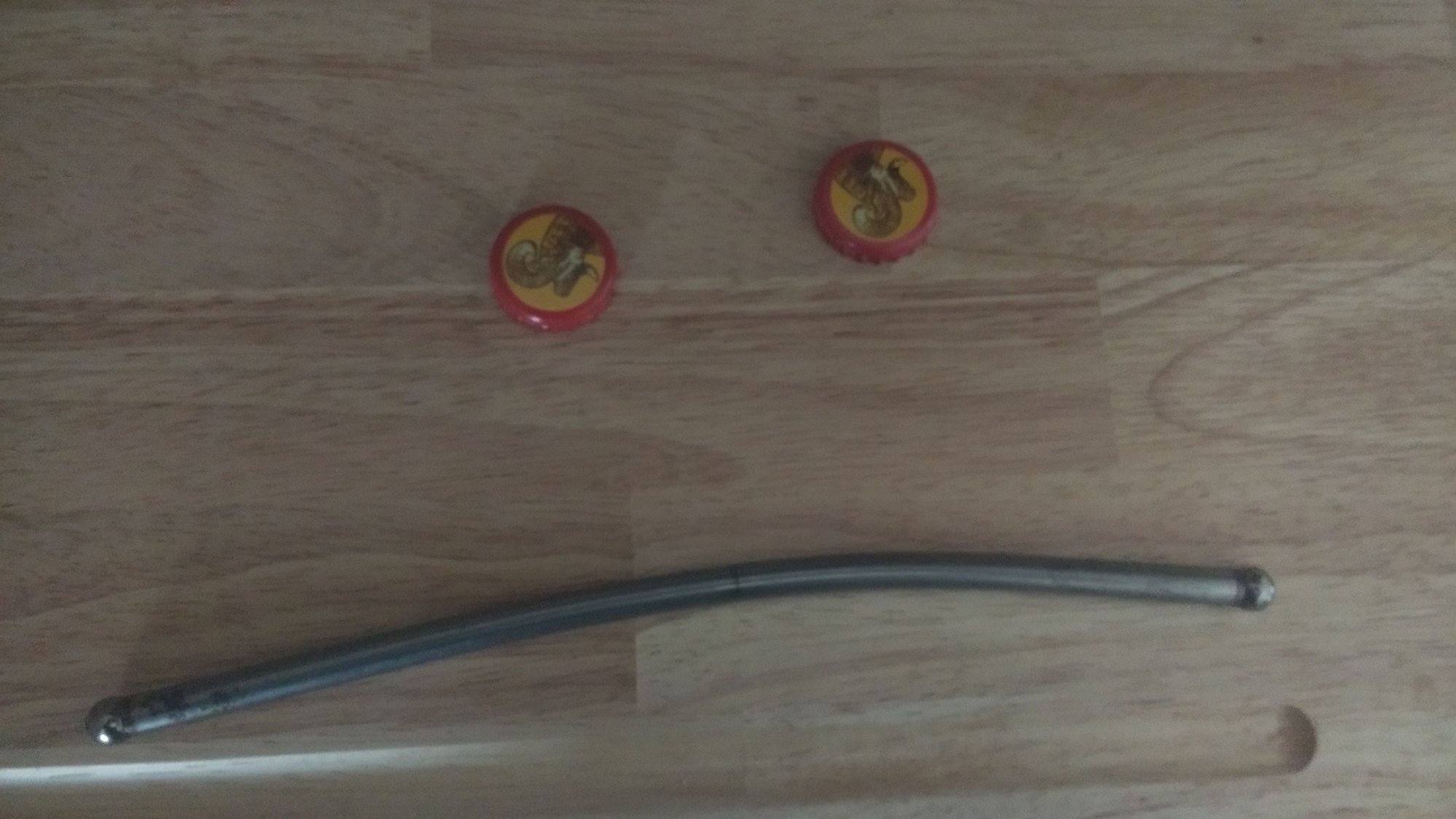

My guess was a dropped valve or slipped timing chain causing valve interference

Not sure what motor you have in there, but unless you have a really high lift cam you aren't going to have to worry about valve interference. It's not like a Honda Civic. I would pull plugs and see if it will crank over as suggested above.

A lot of bent pushrods a few broken lifters and a broken camshaft what would cause all that

Wow. Seized camshaft bearings. Seems like a loss of oil pressure
