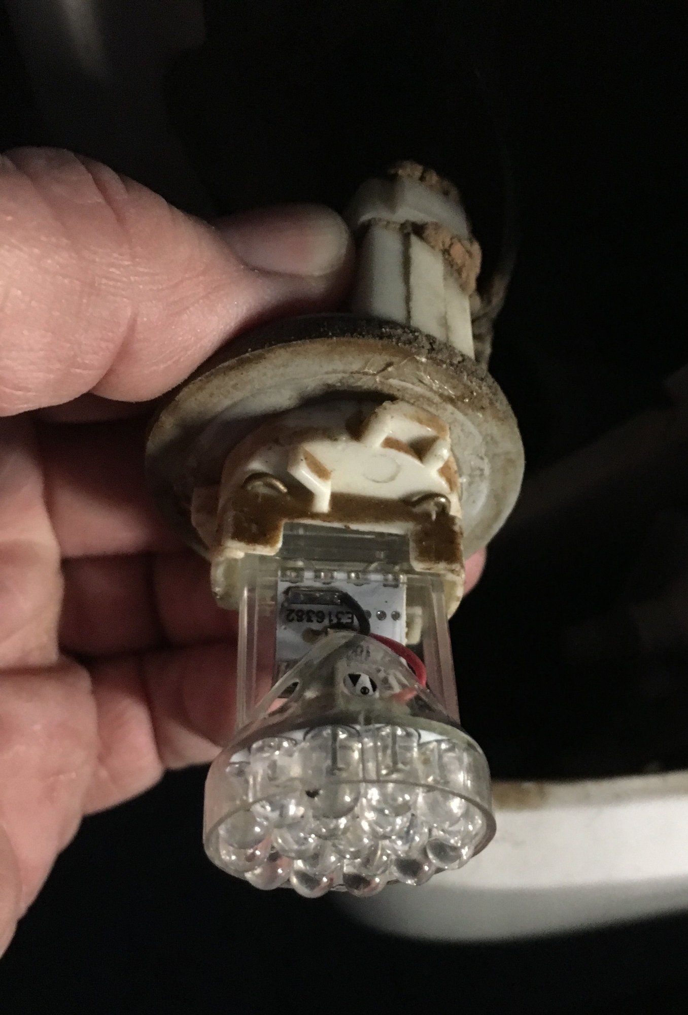

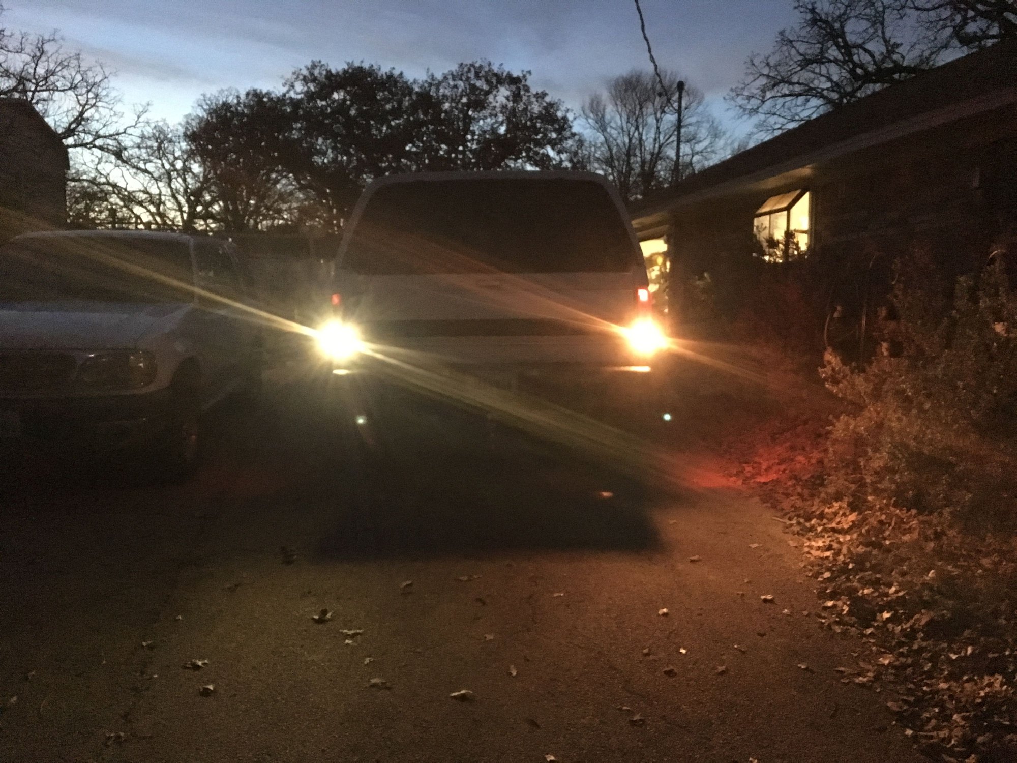

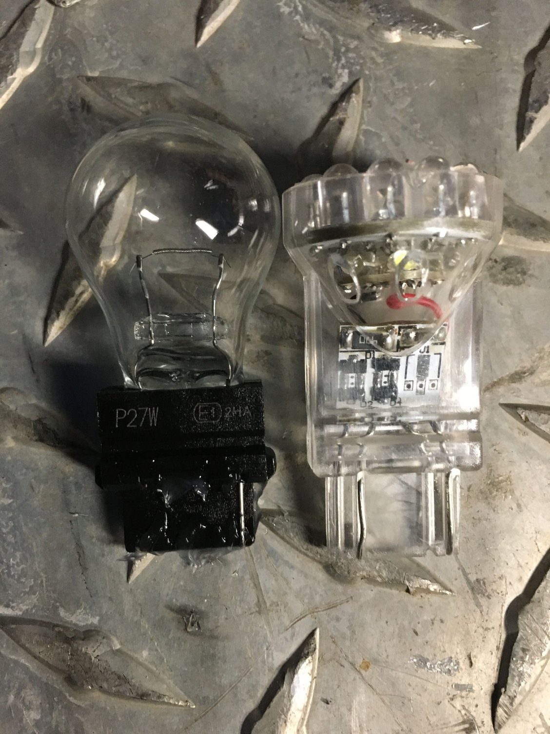

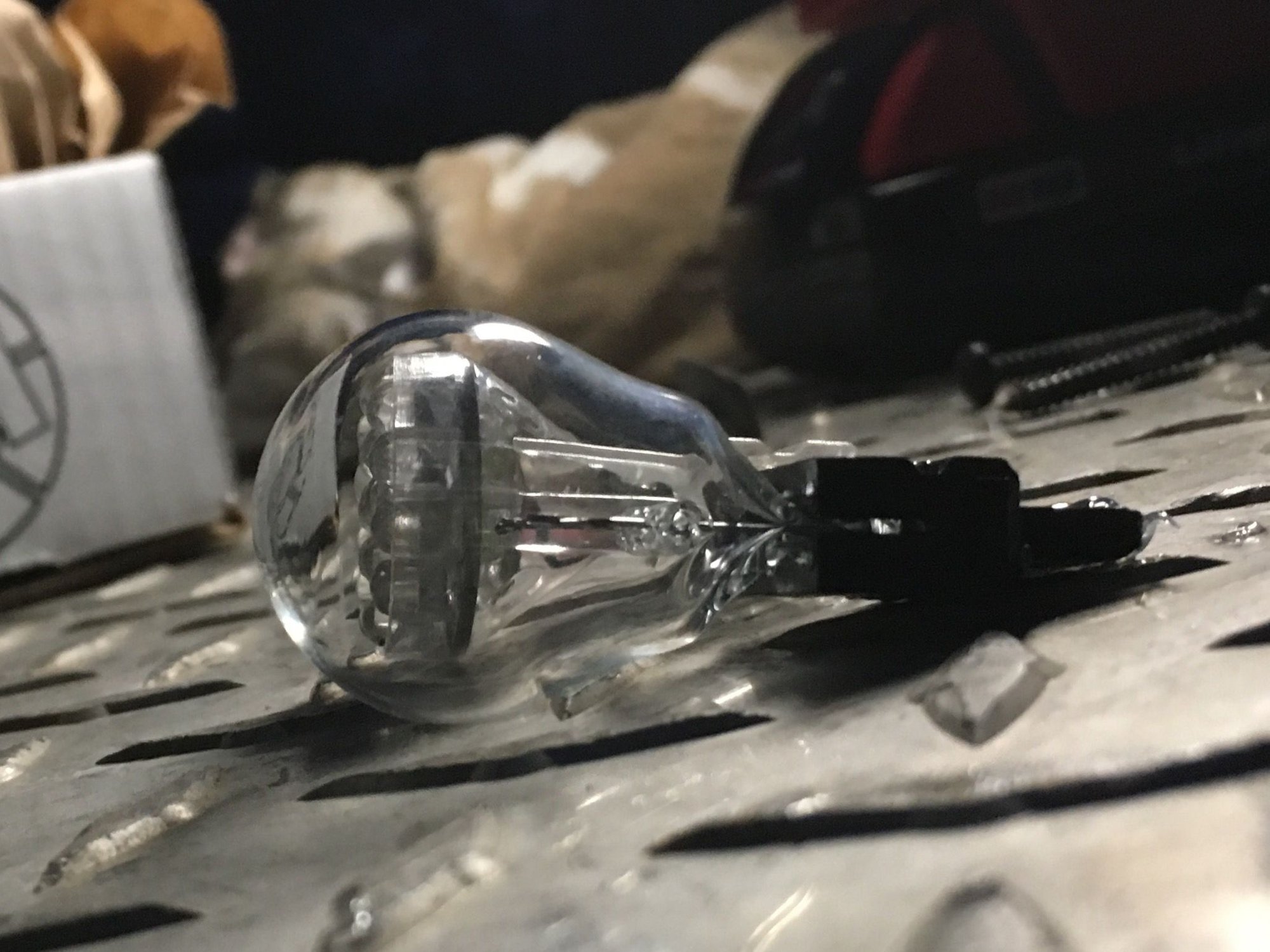

About the same girthThose that have taken pictures of lights know that it is hard to tell the difference with a camera. The difference here is not dramatic, but a noticeable improvement.
Installs in socket just like the stock bulb does
Part number
LED ondriverside
Standing on bumper, LED on the right
Stock bulb only
LED bulb only
