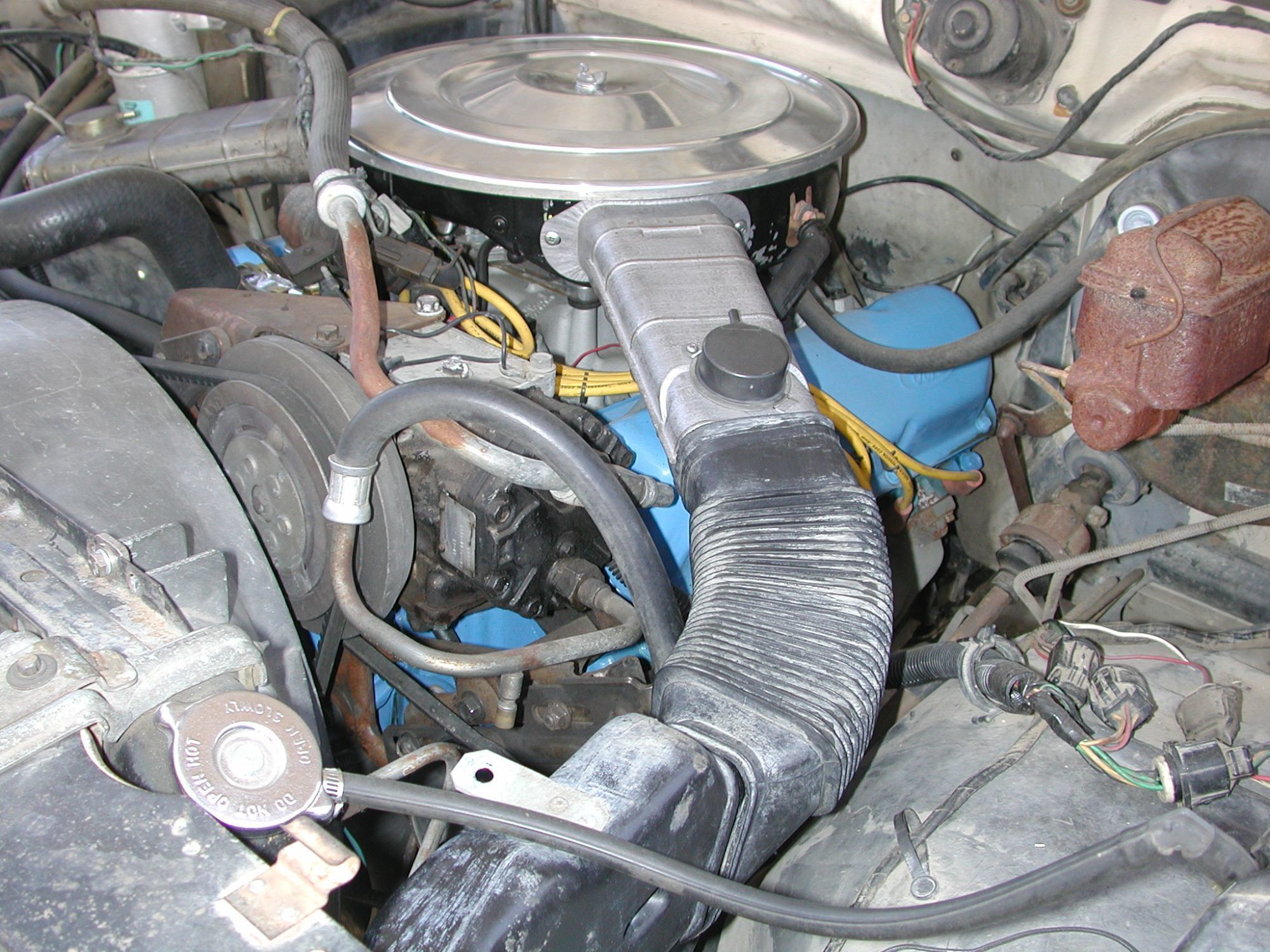

Here's my plan, using factory parts. Both sides are plumbed to the radiator support, so there should be plenty of cooler air than if an open element unit was used.

Thats exactly what I plan to do also. What inlet piece is that on the driver side?
Exactly the same factory pieces from the passenger's side, just turned upside down. Perfect fit.
