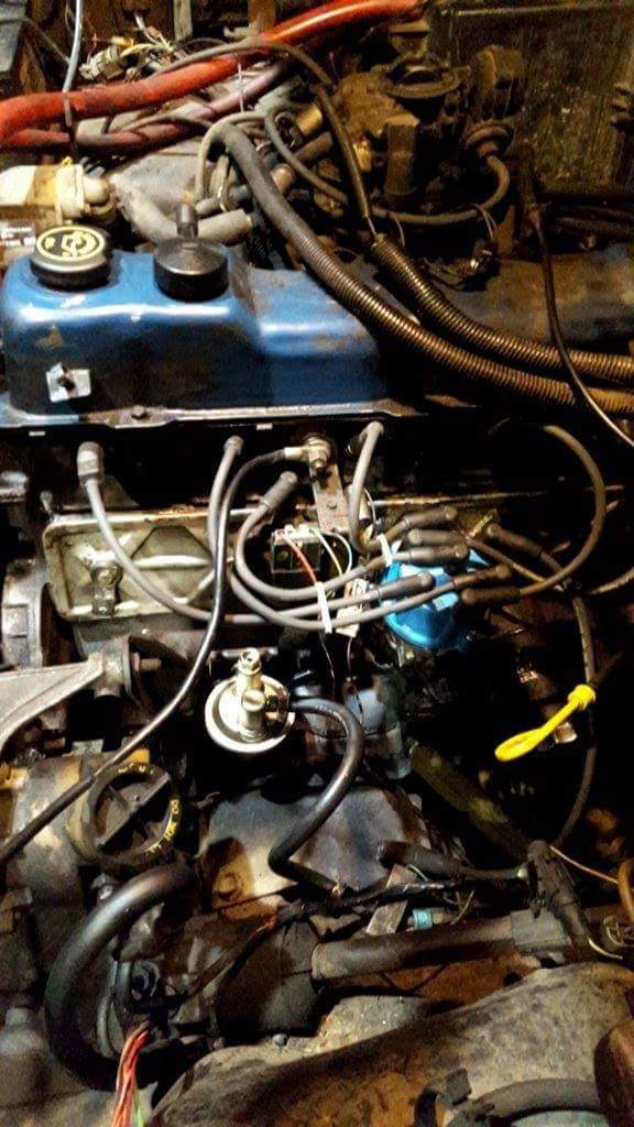

Hi, working on an 86 F150 for a friend of mine. It's a Inline six 4 speed 4x4 model that has rust but is solid. It's running real rough, sucks gas, stalls randomly and gets hot.
He tells me he has done nothing to it but oil changes, new tirea and a front brake and bearing job since 2001!
I immediately noticed that the water pump bearing had play, the rad is leaking at the seams, the distributor cap is loose and cracked. And I know the plugs are bad.
Is there any way to eleminated some wires without changing the distributor and carb? I know on 80s CJs with computer carbs there is a way to bypass. It starts right up now but there are a ton of vacuum line es and wires that don't plug into anything. Also the choke is unplugged, yet it starts up fine cold.
I also plan on eleminating the air system. Did this on a Jeep 360 AMC and plugged the manifold holes. Does this system connect to the manifold? Seems like it just connects to the catalytic converter (which will be changed to stand alone type with new exhaust).
Thanks very much for your help.

Hey guys just wanted to do a quick update, just finished the tune up, exhaust gasket, valve cover gasket, push rod cover gasket and motor mounts. Also cleaned up under the hood. Runs pretty good, but still stalls underload. Carb definitely needs to be rebuilt, but I told him I recommend the older carb/ dizzy conversion and the FI exhaust manifolds. This one seals OK, but is a little bit warped, the heat riser is gone and the surface is a bit pitted.
Old Jan 26, 2017 | 12:29 PM
AAubinoe's Avatar
AAubinoe
Joined: Jul 2014
Posts: 427
I cleaned up all the wires. Actually everything was in pretty good shape. Found a few bare spots at the distributor, and the wire that led from the alternator to the choke was broken off.
Needs a new cooling system, but first it needs the driveling gone through. Everything seems to have play. But it all works, and its a cool truck with a NP 435? 4spd, so I hope he puts some more money in it and keeps it on the road.
