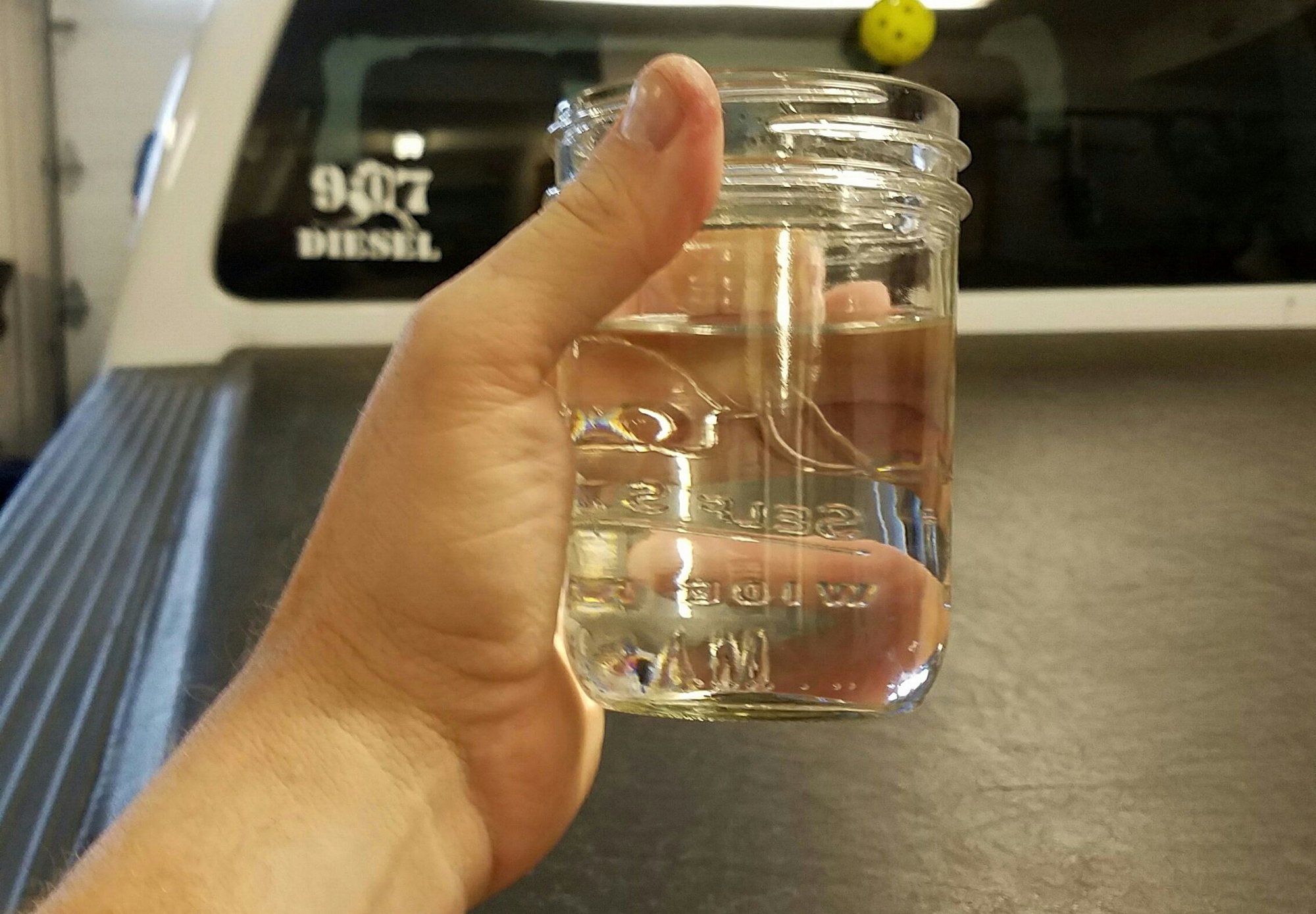

I check my water separator monthly; i just filled up yesterday at a Sam's Club (usually use Fred Meyer) and checked the separator today:. Got about 2C of totally clear liquid--looks like water but smells like diesel. Is this winter blend (clear) or is it water? No dash warnings and I've driven about 100mi since fueling up...

Hey bud water does not dissolve in diesel and is heavier so if it is water it will be at the bottom in a distinct separate phase.

Understood--but the jar looks like water (nothing separated but smells like diesel)

Do you have a volt/ohm meter?
Set it to read ohms and measure the resistance. If it reads a resistance, then might be water.
I do not have any diesel fuel handy but did just check the resistance of water, 70% rubbing alcohol (contains water), gasoline and cooking oil. Alcohol and water measured some resistance. Cooking oil and gasoline showed open or no conductivity.
Try it if you have ohm meter and report back what you measure for resistance.

Stick your fingers in it. Is it slimy like DF, or watery like water? Run a little tap water in to the jar of fluid.....does it go right to the bottom, or just disappear?
Only other thing would be to drop a hydrometer in it to check specific gravity. Pretty hard for us to tell from a picture on the internet.
If you drove it home with no problems you are probably OK, but it is always good to be sure.
Good luck!!

Add some water to it and if it separates your good. That looks more like jet or kero than the typically green colored diesel.

That's what my diesel looks like up here. D1-S15... crystal clear, no tint to it at all. It's winter blend... I'm assuming you filled up in a cold state and live in a warm state.
I never saw clear diesel until I moved up here, previous located was South Florida...

As previously mentioned, it is most likely kerosene - #1 Diesel. The easiest way to tell is just to take a small amount of water and add it to the jar. If the water falls immediately to the bottom of the jar and forms droplets, or a "puddle" in the bottom of the jar, you know that the stuff that came out of your tank is kero. If the water disappears into solution, the remaining contents are also water. As also mentioned, you can tell be feel, the difference between water and hydrocarbon. Feeling isn't necessarily the healthiest way to check the difference, but will work.
