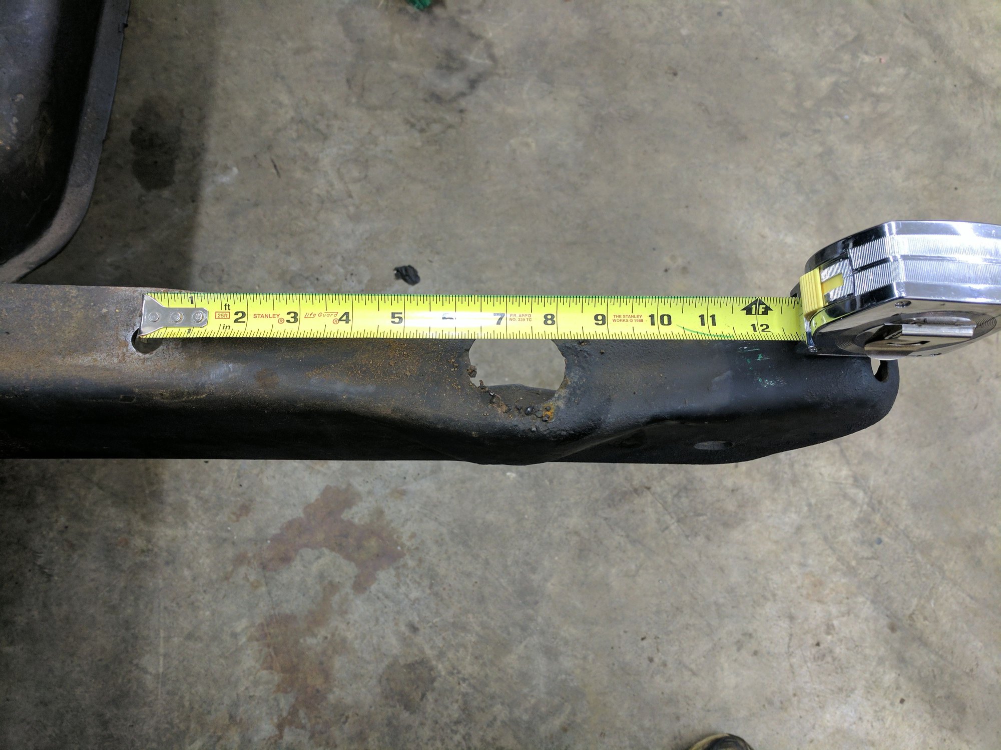

Mine are completely boogered due to rust and some old school 1970s body repair on the slightly tweaked frame horns. Anyone have measurements and or pics they can share so I can weld some patches in and cut holes in the right spots? Here is what I have now.

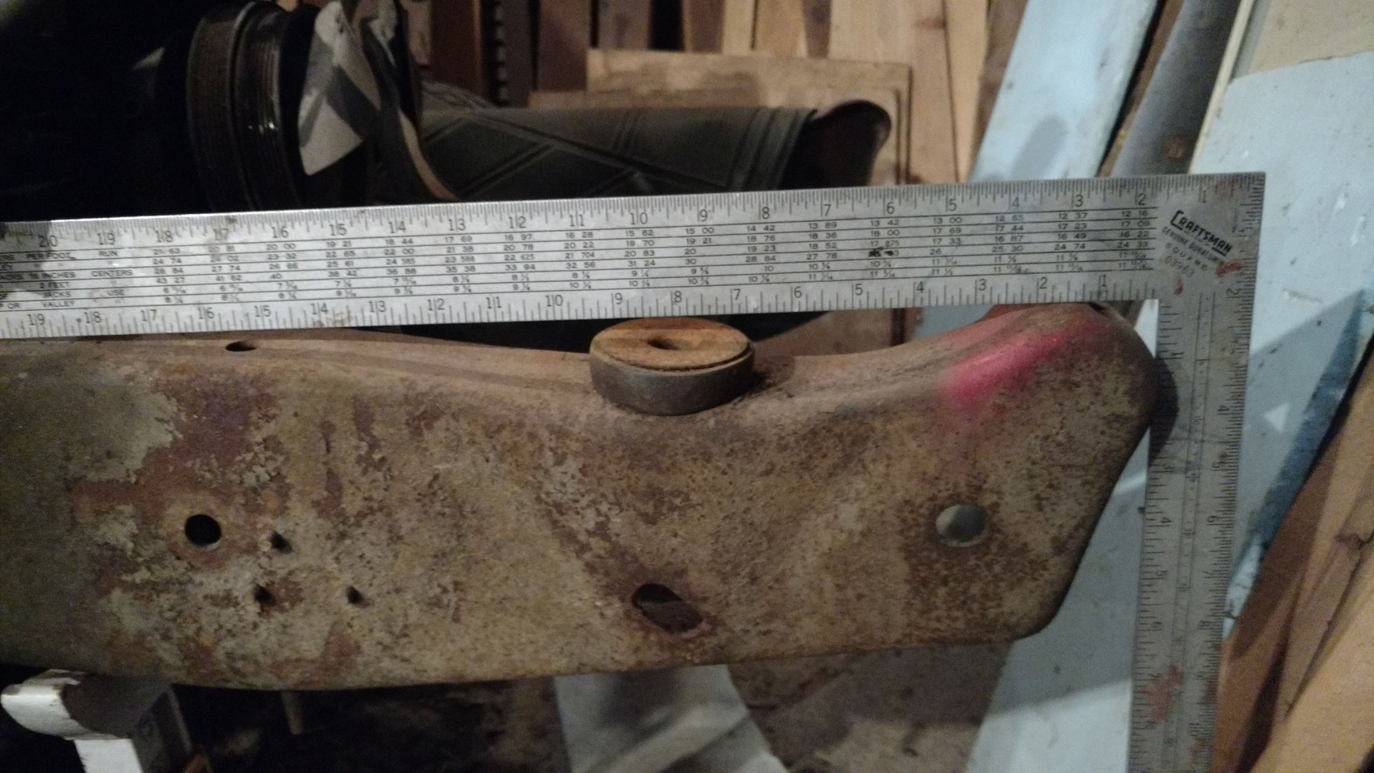

I will measure mine for you tonight. I will also measure diameter of the body hole.

From the frame horn it is 8" to the hole center. If you measure from the second hole forward it is 7 3/8". My core support bushings are still very attached as I haven't beat them off yet. I hope this is the info you needed.
Well there is a cool azz way to measure it. Came out an even 8" too. Rep'd ya for it amigo.

Figured if you use a framing square then it is easy to display. Thanks for the Rep's

Thanks everyone for pictures and measurements! Very helpful and greatly appreciated. If anyone figures out the diameter of the hole that would be great too. Thanks again.
