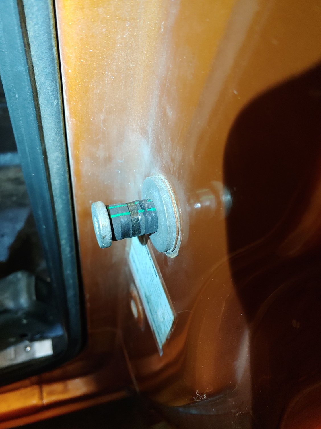

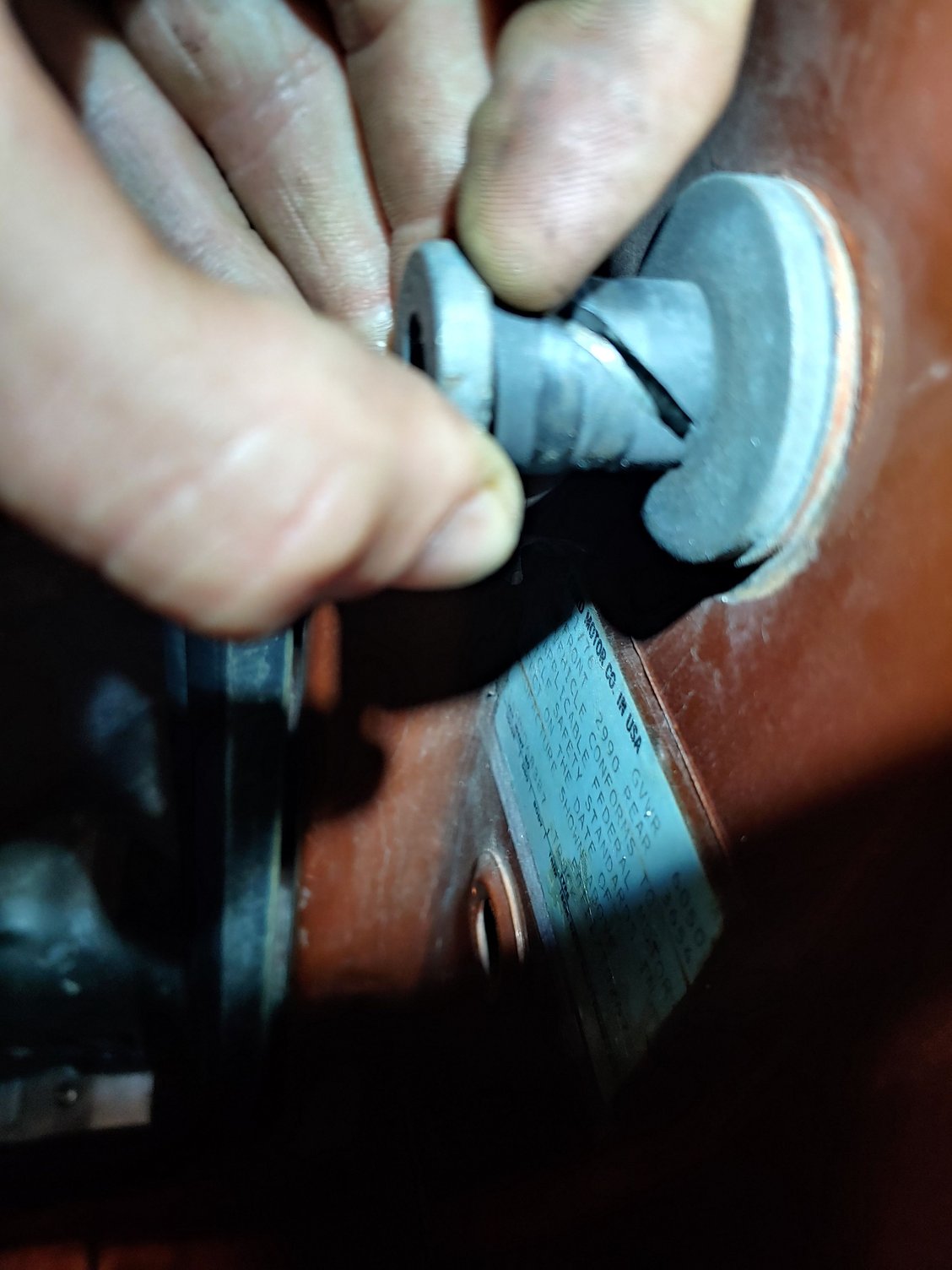

Originally Posted by JLawson93711
I didn't have to cut a slit in it, I just used the mallet and socket to tap it over the threads. Once it passed the threads, it spinned freely. I was worried that cutting the slit would lead to it falling off or shifting when the door was closed.
mine was done on the truck I'll get pic of it

To think, I’ve been driving around with a rattling door driving me nuts, figured I would have to order new strikers. Guess I know what I’m doing tomorrow!
1 Q- My striker has a deep groove worn into it, would that pose an issue with the longevity of this fix?
Mine have a groove too, I think you’ll be fine! The tubing just gives the latch on the door a firmer grip. It’s $0.25 worth of tube, nothing that isn’t worth trying!

Quiet as can be. They have been in place for over a year and used every day
