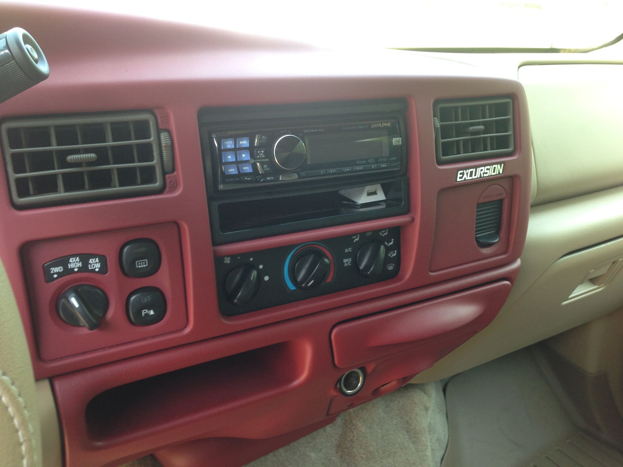

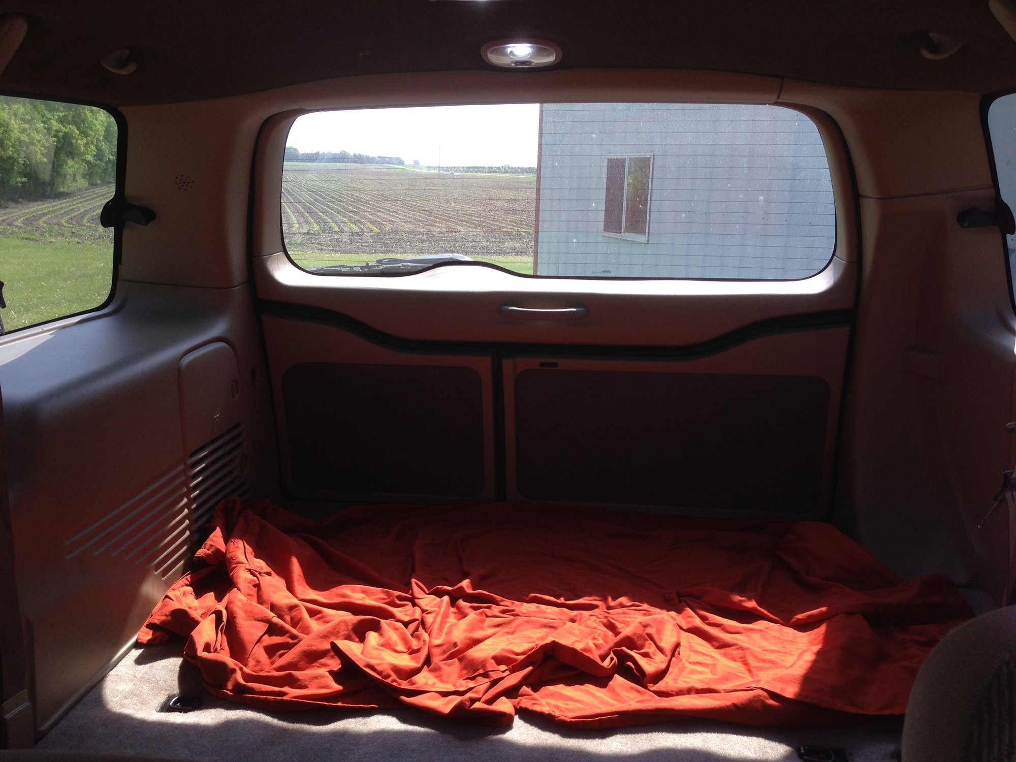

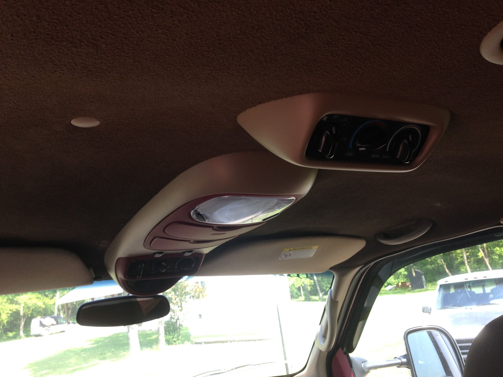

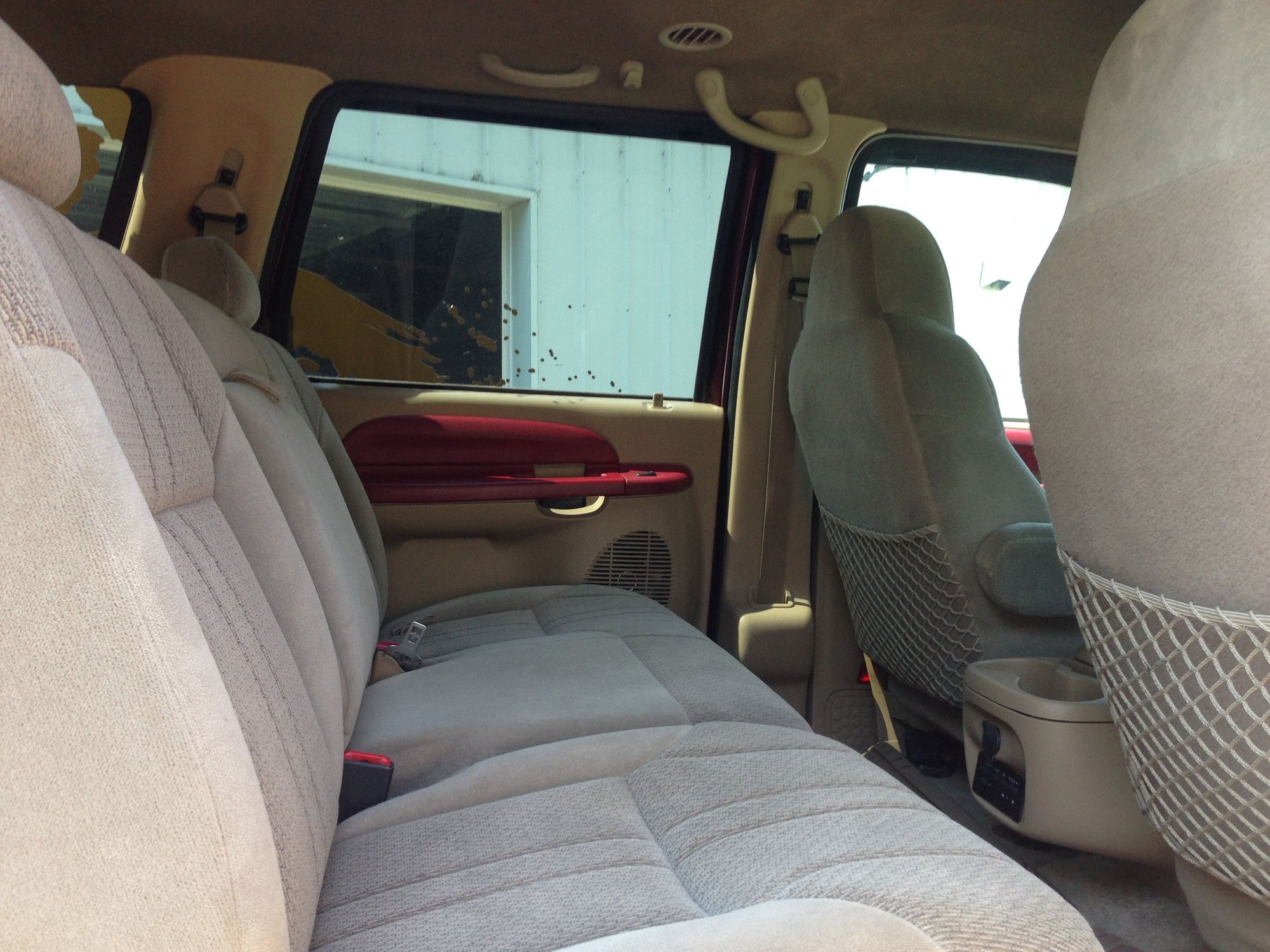

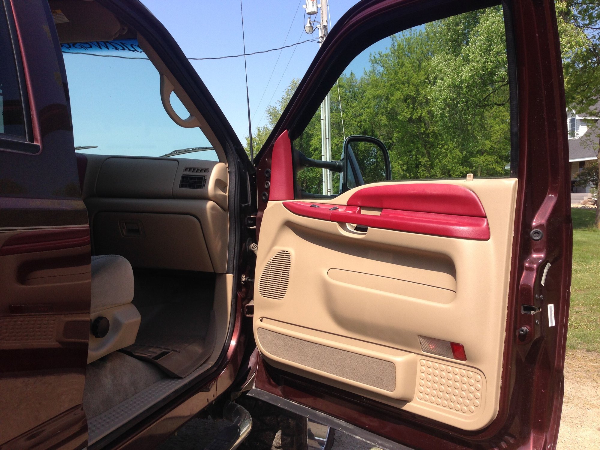

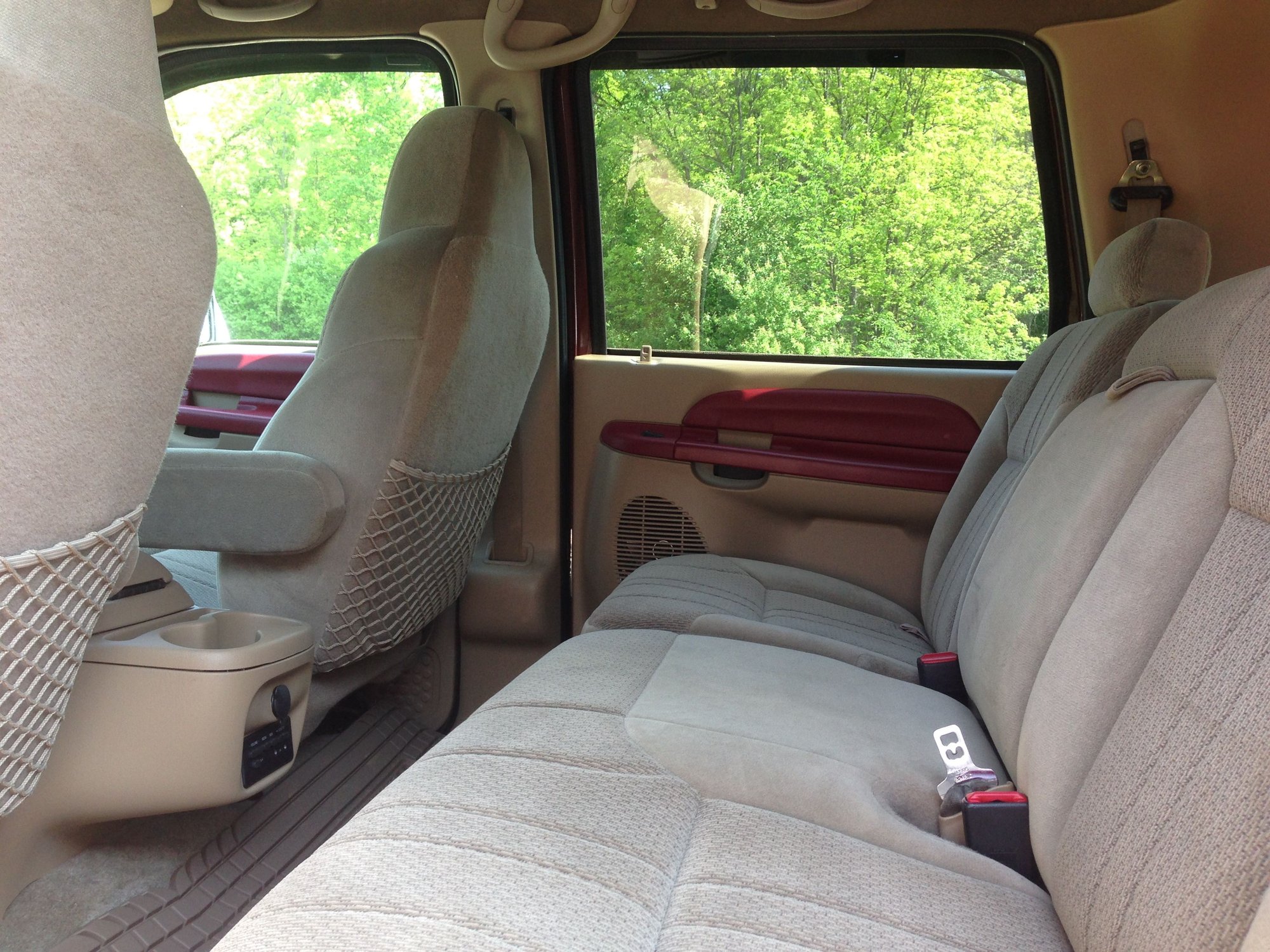

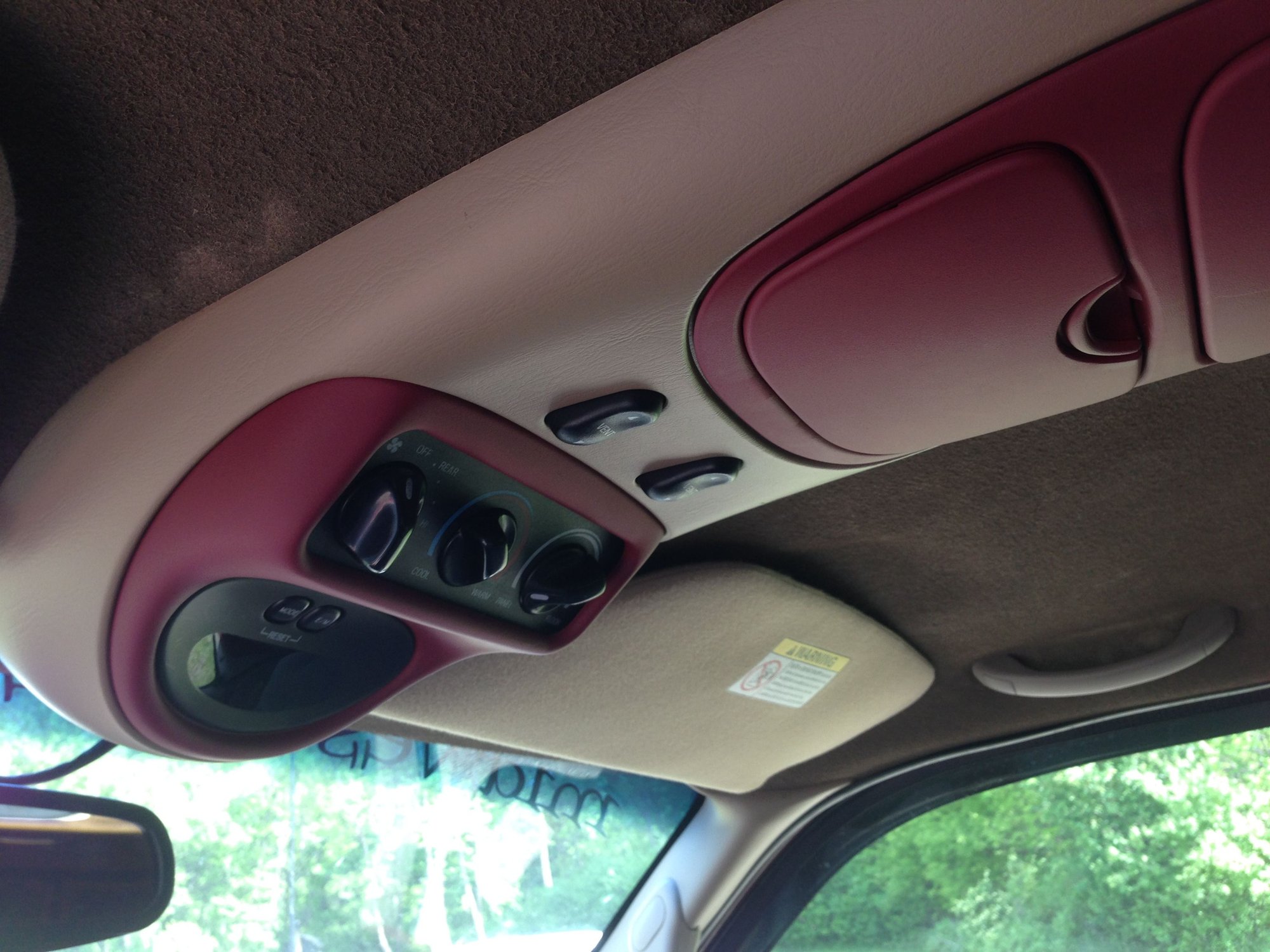

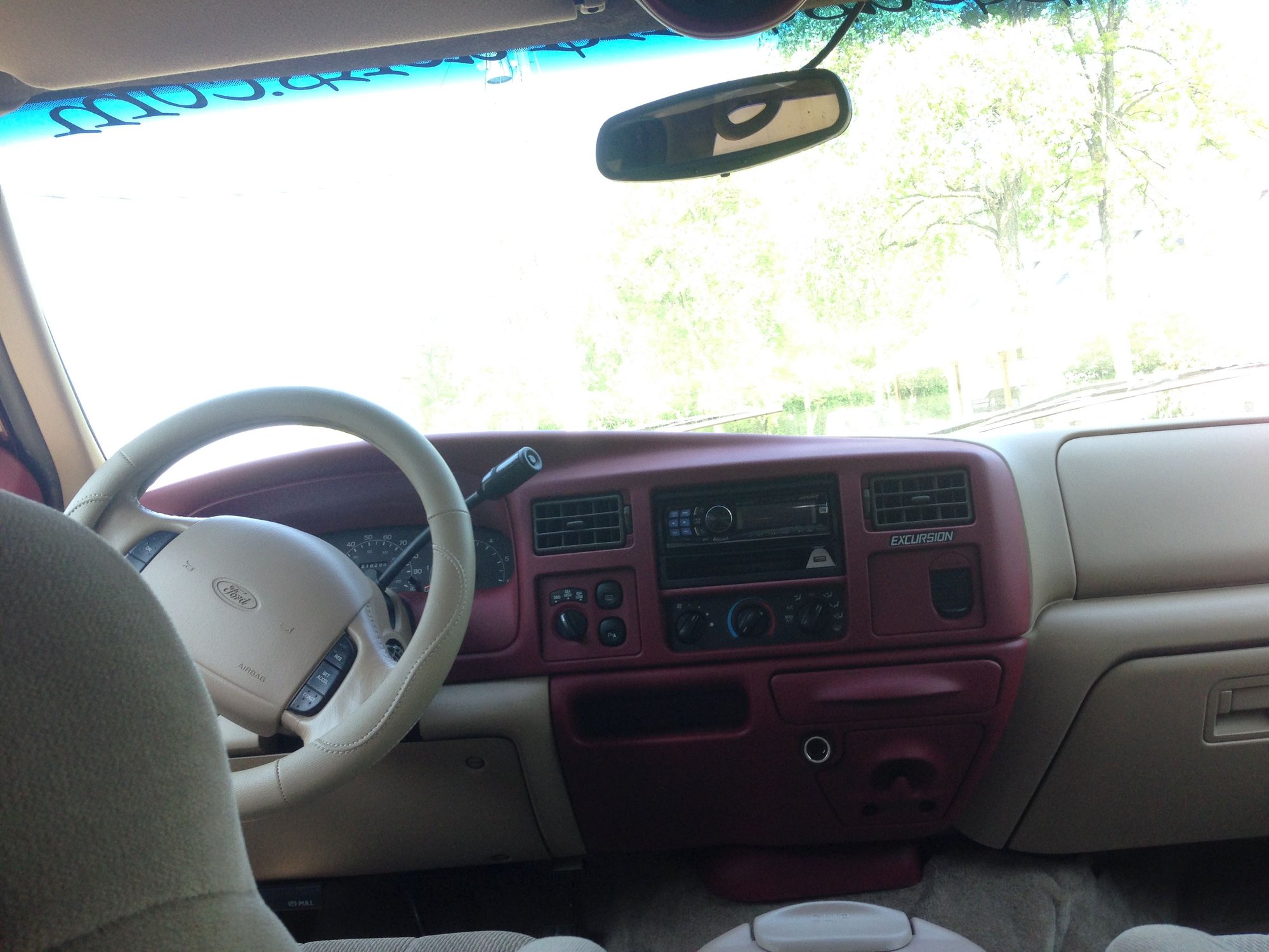

When I swapped out the interior of my truck with new pieces, I decided to paint it a brighter color. I first thoroughly cleaned each piece with TSP (Tri-sodium Phosphate) and a scrubbing sponge and rinsed it off with water. After it dried, I wiped the whole thing down with wax and grease remover/paint prep solvent. Once that dried, I used dupli color plastic primer, followed by some dupli color "Vinyl and Fabric" paint, which is meant for plastic interior parts:
Vinyl & Fabric Coating - Aerosol | Dupli-Color
I went with the "Medium Beige" and "Burgundy"
I've had it installed for just under a year now with no problems.
Here are some pics:
