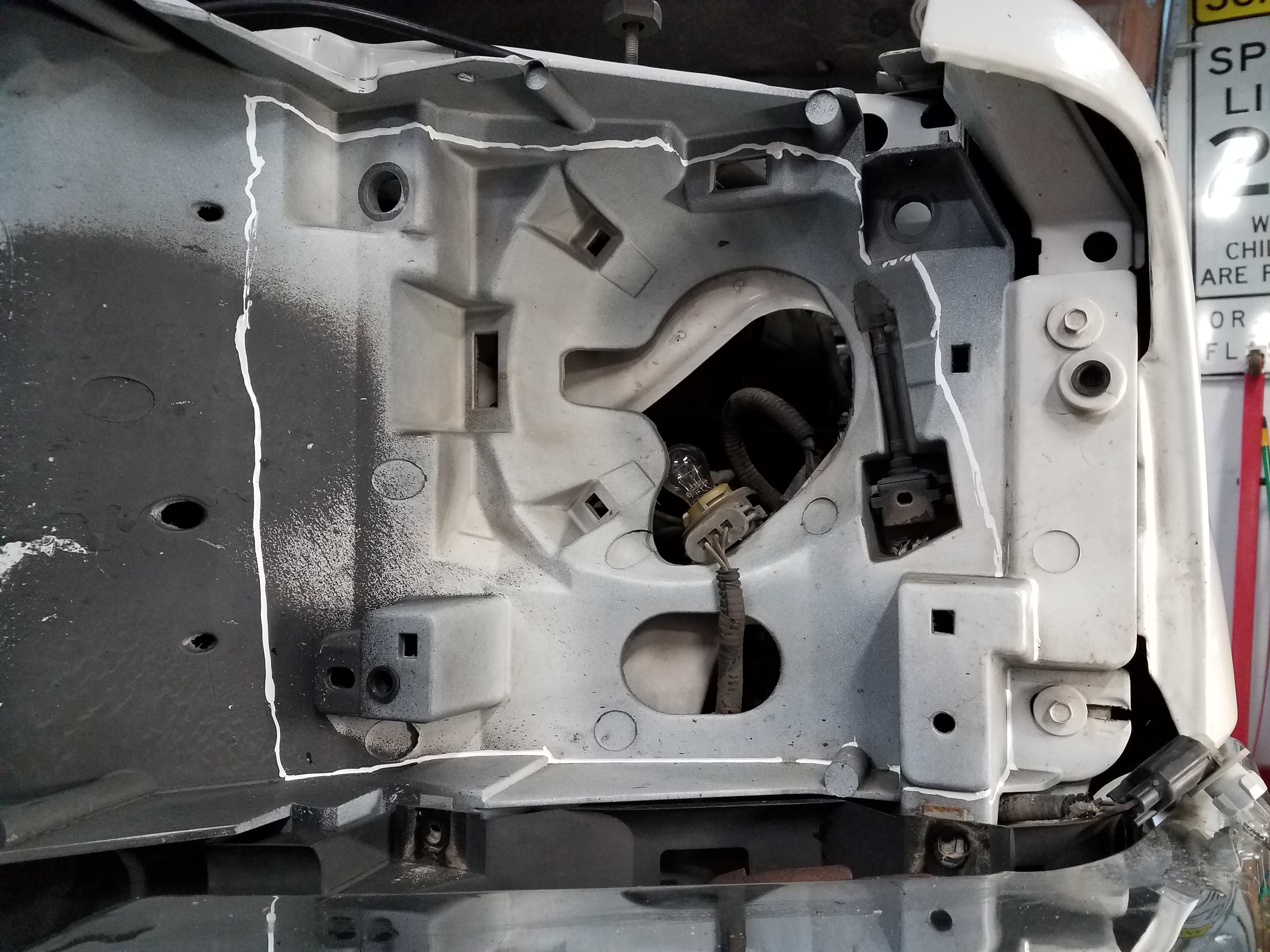

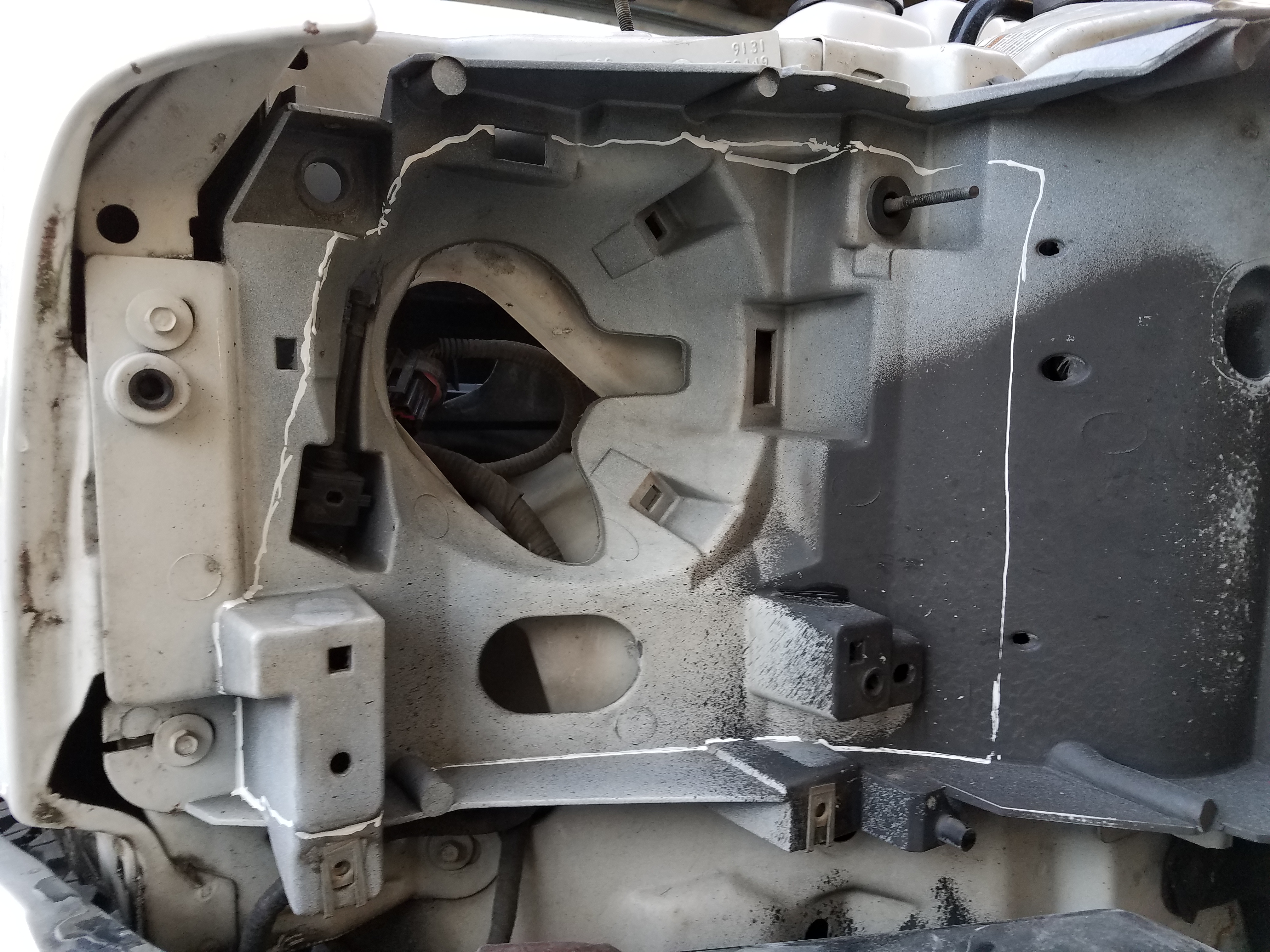

Turbo and I did some wrenching/cutting in his shop today. I'm still blowing header panel plastic out of my nose =)
Got 'er all done in about 4 hours taking our time and freezing my fingers/toes off in 28F temperatures. Never done it before so the first light took a while, but we were much quicker with the second light. Used the Riff Raff walkthrough, which was very helpful.
Turbo said it best, "It looks 7 years newer!" I like it a lot, very happy with how it turned out.

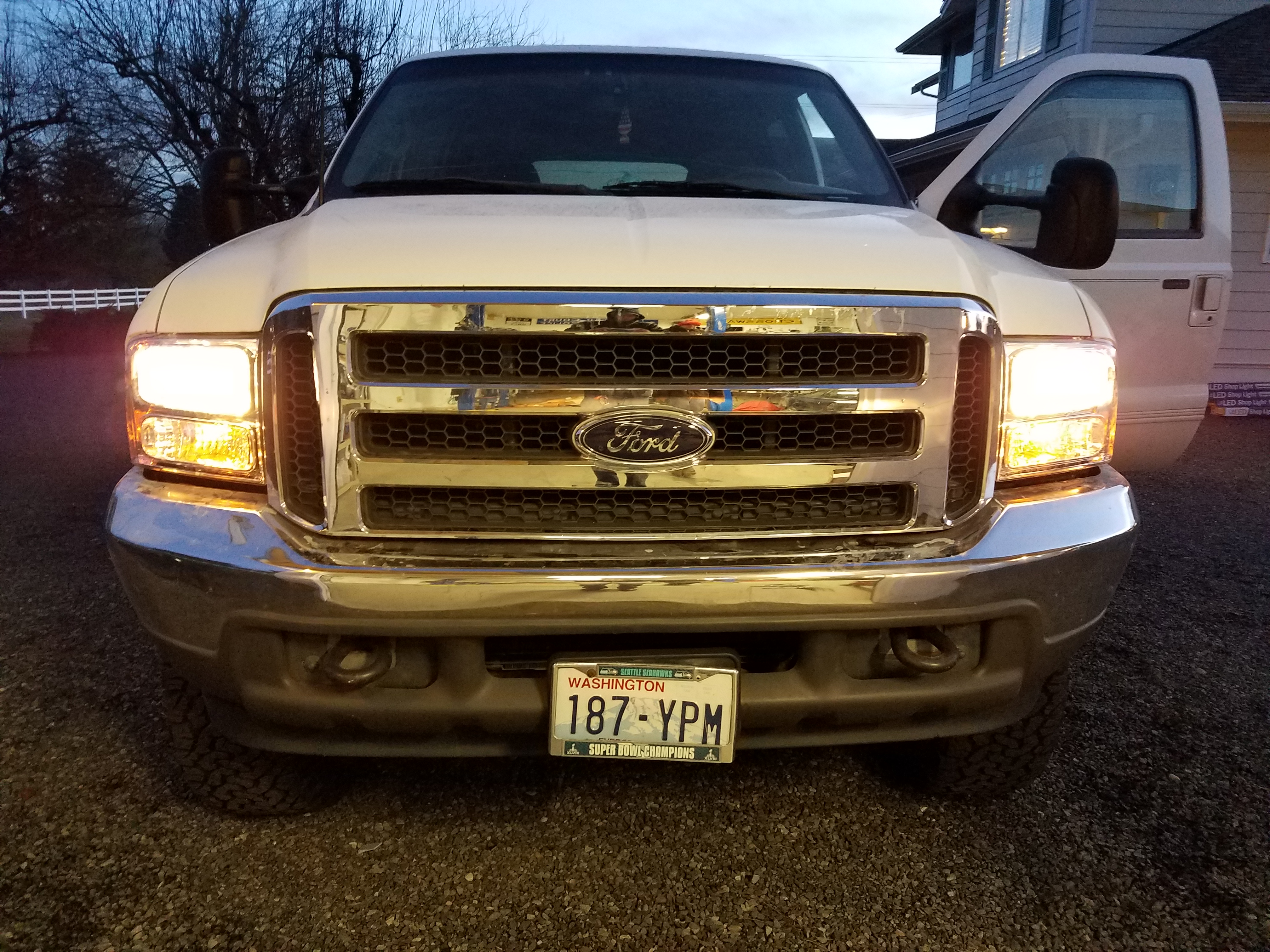

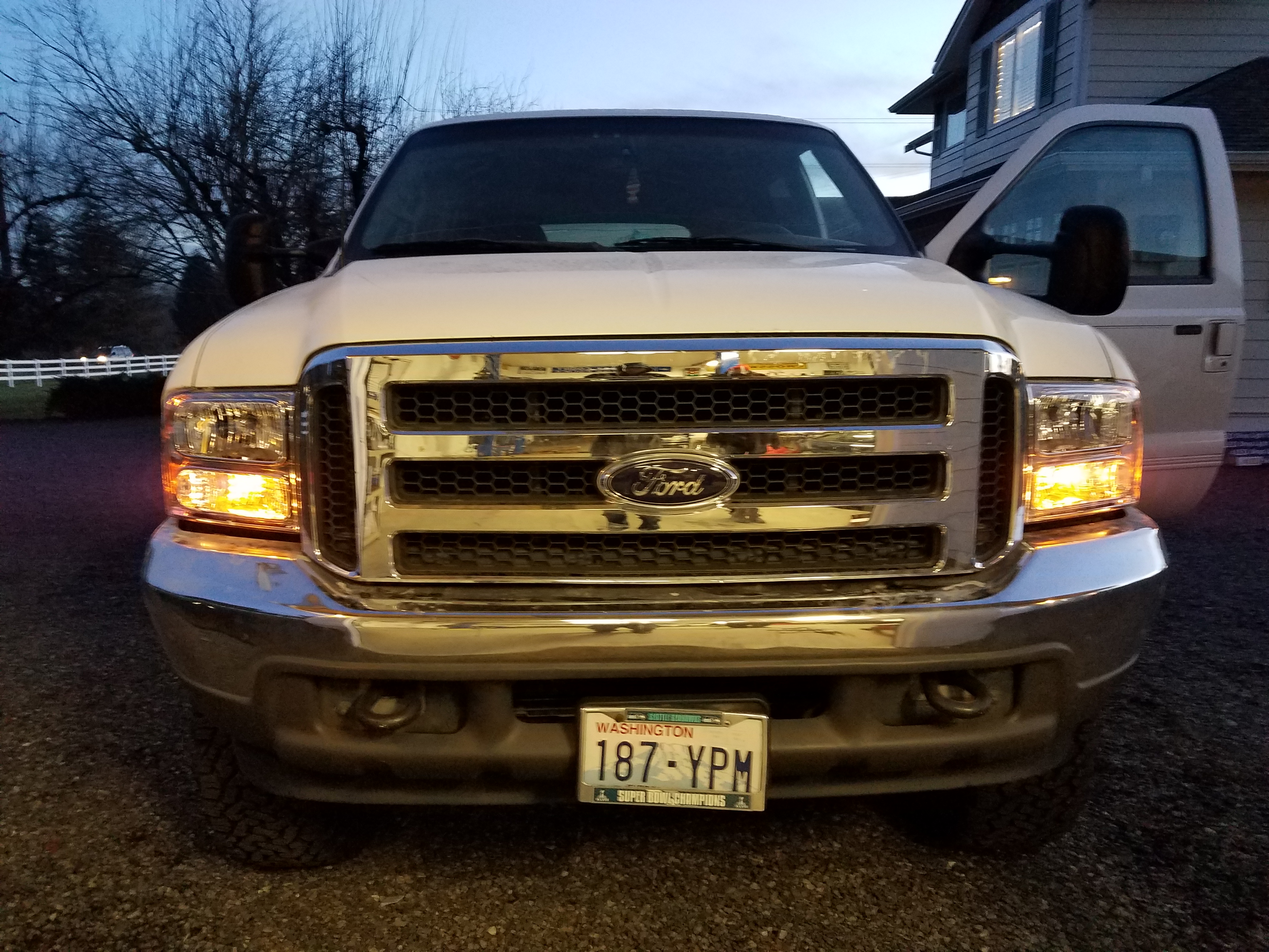

Finished product:
Attachment 288299
Attachment 288300

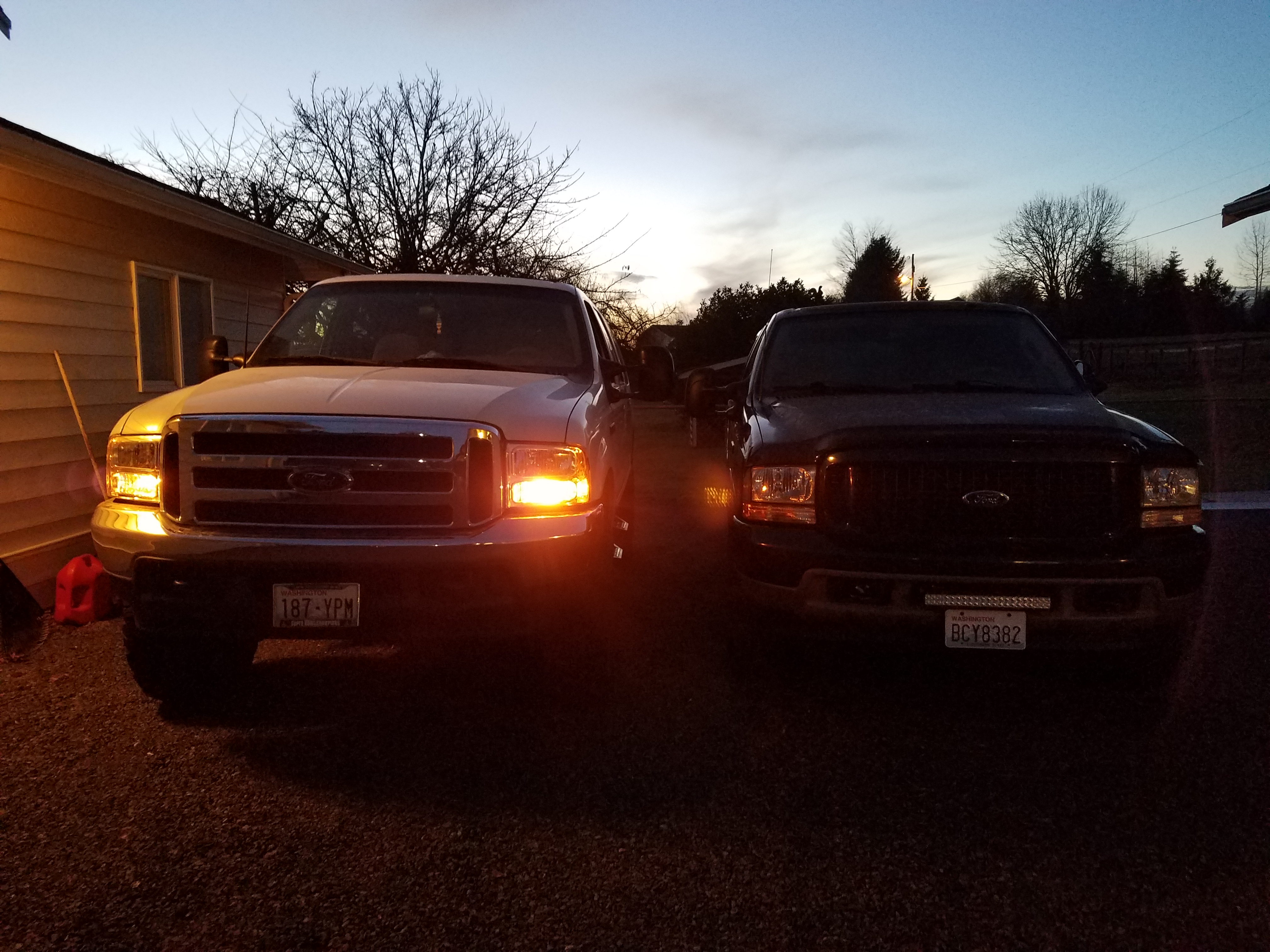

Running lights:
Attachment 288301
All On:
Attachment 288302
Family Exs (my V10 and Turbo's newly acquired 6.0)
Attachment 288303
