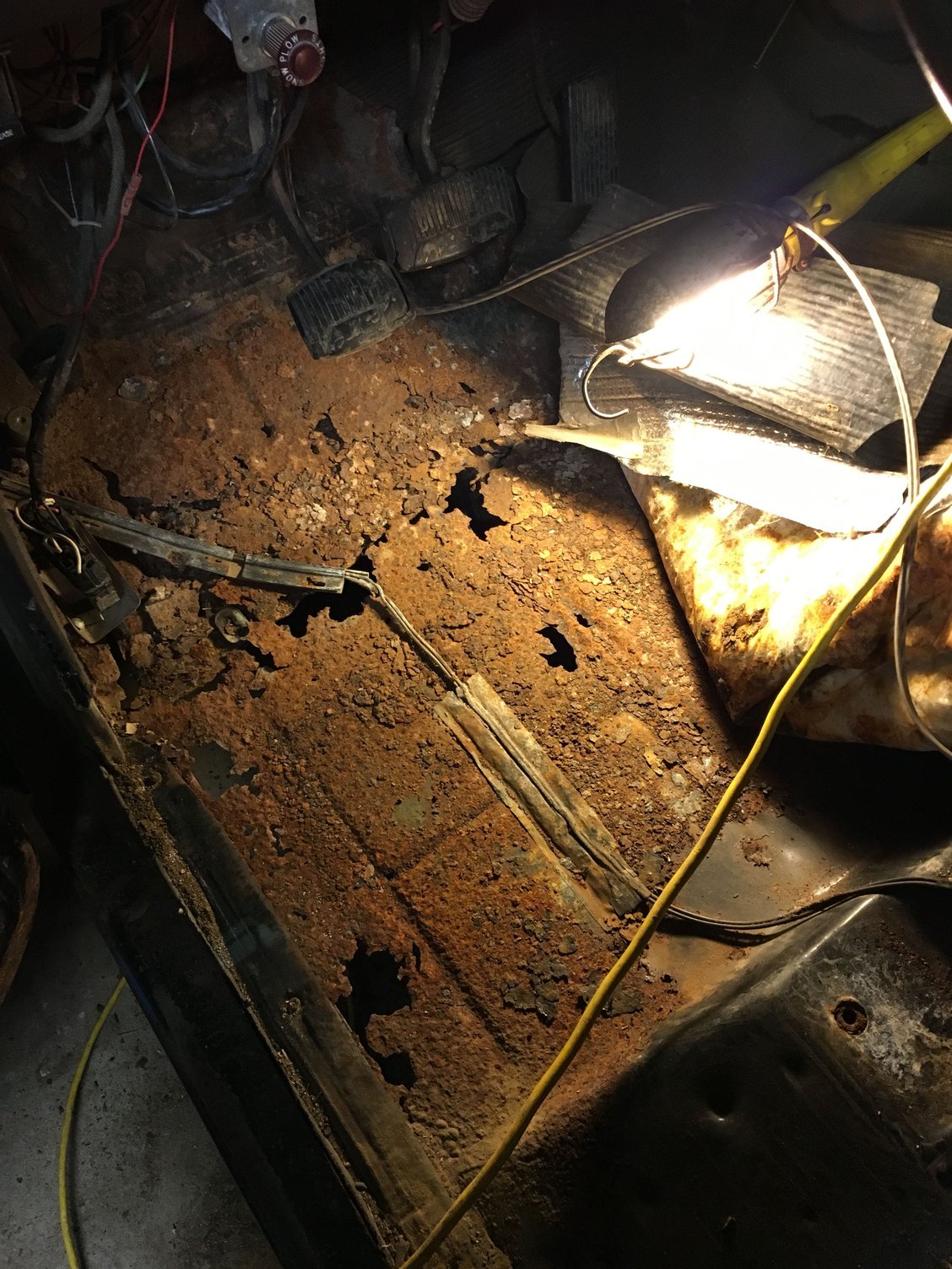

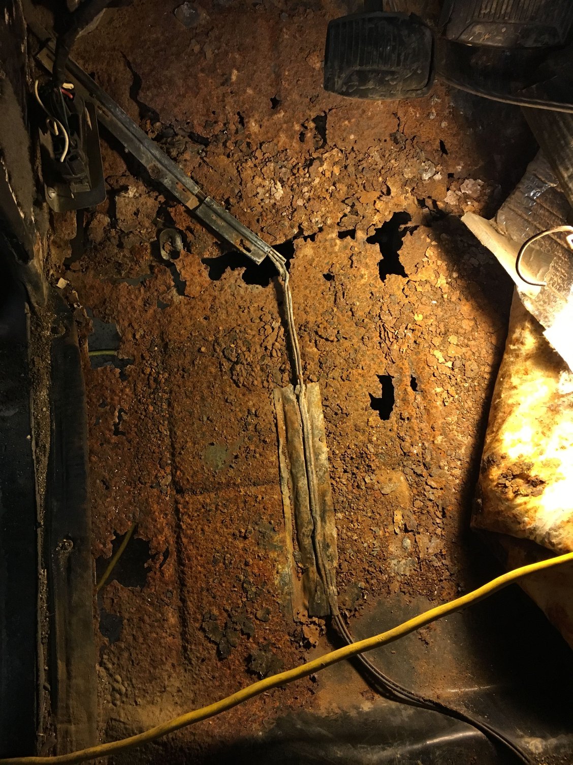

Hey FTE, I've recently ripped out the carpet and rubber mat in my project and found that my floorboards are extremely rusty. I'm going to replace the floor pans but want to know if any of you have tried bedliner on the interior and how it worked. Also, how would you hide wires without a carpet to run them under? Thanks!

Yes, yes they certainly are!
I've not seen it personally, but I've heard of guys using HercuLiner and Line-X. I think Rhino would be really good

I found mine years ago when I pulled the carpet up one day, it was no where near as bad as that in the pics above though.
I replated mine inside over top (inside) with some new 11 ga steel I formed to fit, tied in around sides / up firewall some number of years ago. Then I coated underneath really well.
A couple years ago I added some aluminum underneath to shield them down there below from road splash (they were no worse, I was just driving it more in bad weather) and I went over the whole inside floor with bedliner and got some of those "indoor / outdoor carpet squares which have rubber backs and made carpet sections that fit and fastened in place with SS screws and those finish washers and SS lock nuts under the bottom to pull it all together.

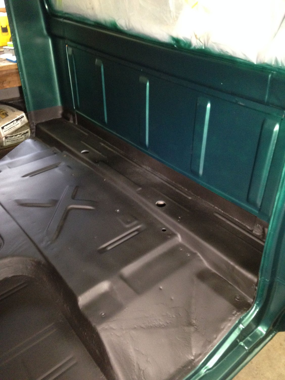

I was going to do my cab floor with Herculiner but decided to use 3M ruberized undercoating instead, I think it looks nice and has a good texture.
That looks really nice. I might have to try that, still trying to find a way to put carpet it in without dropping $170.
