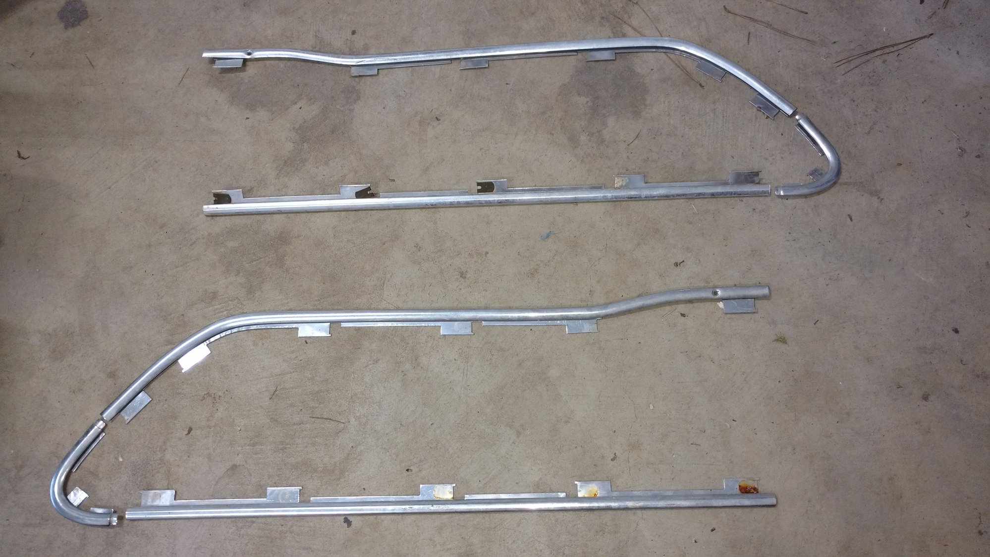

Hello All,
I found these at a junkyard within an hour and a half of the house. I was very excited because I love the look, but I cannot see a way to install them onto my truck. Maybe a Custom Cab only option??? Or maybe the holes were painted over in my truck...
Look to be in pretty good shape, not perfect but....
If these are not compatible with my truck then they are most definitely for sale. Anyone have an idea of what they are worth? I've got more pics if needed.
Any input is appreciated
I left some of the original clips on for reference purposes
These are fresh, I have not cleaned them at all. They may look even better after some polish ingredients.

I don't know what they're worth but it's much more if you have all the clips and maybe a few extras.

All clips were present, I only assumed they were readily available for replacing and did not snag them all. Should still be available at the salvage yard if you all think it's a big issue.
Any ideas on which models the trim was available? If CC only, is there a way to affix to standard models??

AFAIK, trim was Custom Cab only
Any truck that was not originally equipped with the trim will not have the required holes drilled in the doors.
You would need to make a template & drill your doors to install.
The clips are available reproduction, as are the inserts......

That's not a bad price at all. The clips are reproduced, but at $1.60 each and you need 26 total that's over $40 just for the clips so if you can get them it never hurts.
The corners are the pieces that are most often missing. Only one clip held them on, other than where they come into contact with the upper or lower pieces. People would hit them with their elbows and loosen them up and eventually they fall off if you don't keep an eye on them.

When salvage shopping some time one gets lucky, a used set of door panel trim aint cheap. Not a purest, just not sure I would try refab. standard cab door to CC, imagine it would be labor intensive, as TA455HO mentioned, there are a minimum of 26 holes and must be perfectly aligned. If the door panel inserts need to be replaced then looking at reproductions at around $100 plus per pair.
IMO, would not purchase the clips unless decide to install in your vehicle, recently purchased the clips thru Carolina Classics.

My bodyman Al and I had to add the trim to my standard cab passenger door. He took lots of precise measurements to get them to fit. I recall that it was a pain to get the clips to click into the holes, even on the original custom cab drivers door.
Here's a link to my build thread, around page 20:
https://www.ford-trucks.com/forums/1...-build-20.html
