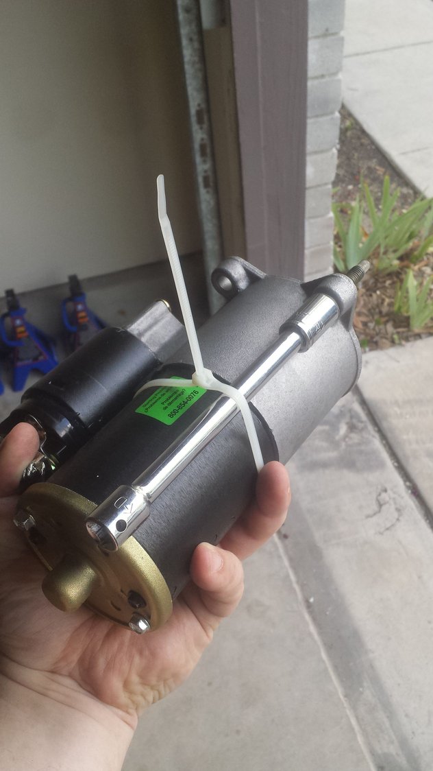

When putting it back together, I put the socket and extension on the bolt, through the starter hole, and then ziptie the extension to the starter body. That way your tool is already on the bolt ready to go and bolt is held in place; no hunting and swearing.

That's a good trick!
Old Dec 30, 2016 | 02:15 PM
Modoc's Avatar
Modoc
Posts: 1,456
Likes: 128
From: Shasta County, CA
Excellent idea!
