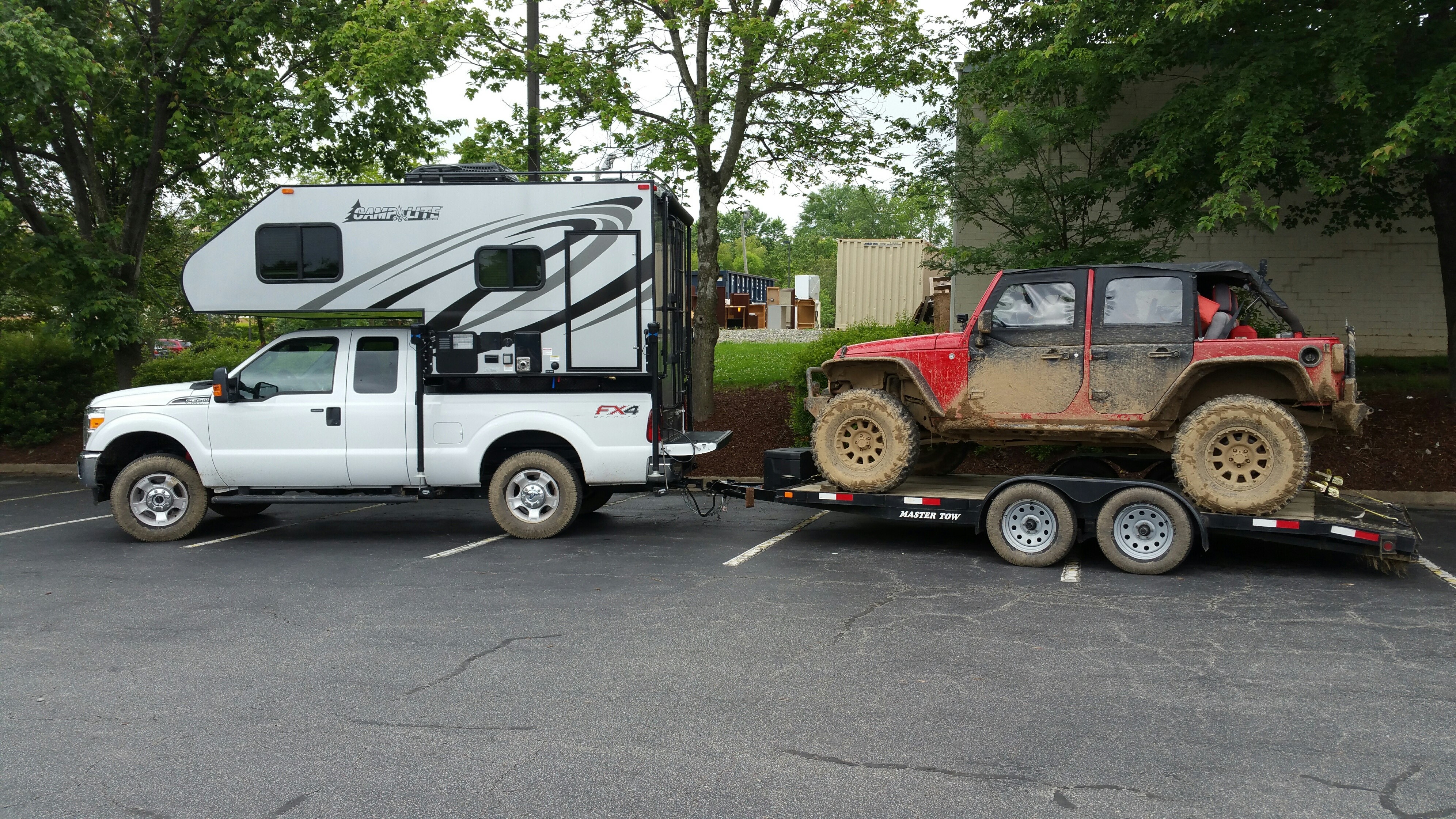

Truck Camper in Short Bed with Bumper Pull
Name:  Truck Camper Jeep.jpg
Here's my set up with a short bed.

Originally Posted by JeepMD
Attachment 168905
Nice looking setup. Pretty much exactly what I'mooking to do but I'd go for a bigger camper if I can manage it.
