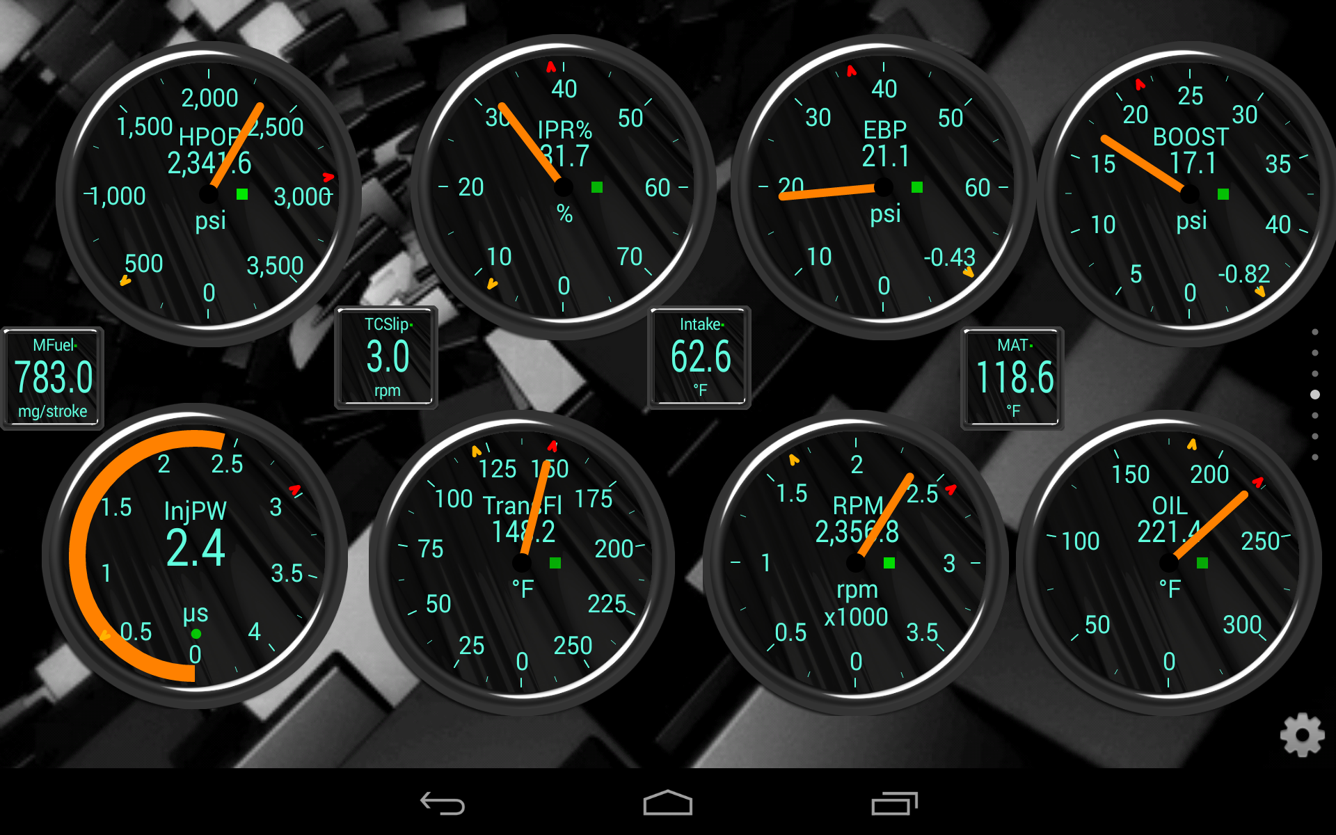

what app are you using on your tablet I like the layout of those gauges

That's the Torque Pro app. It's definitely worth $5 plus the cost of a Bluetooth OBD dongle.

Brad, what are you using for your display in the pic above? Tablet? Joying/Android? etc.?
I actually have both of those a tablet and a obd Bluetooth reader but I've never seen the option for that style of gauges
you custom built these didn't you! Very clean and useful

That's a screen shot from my Nexus 7 tablet. The gauge style and background are add ons you can download. I can't remember if I found them in the Torque app, or from the Google Play store, it's been a few years. I loosely copied Tugly's layout.
