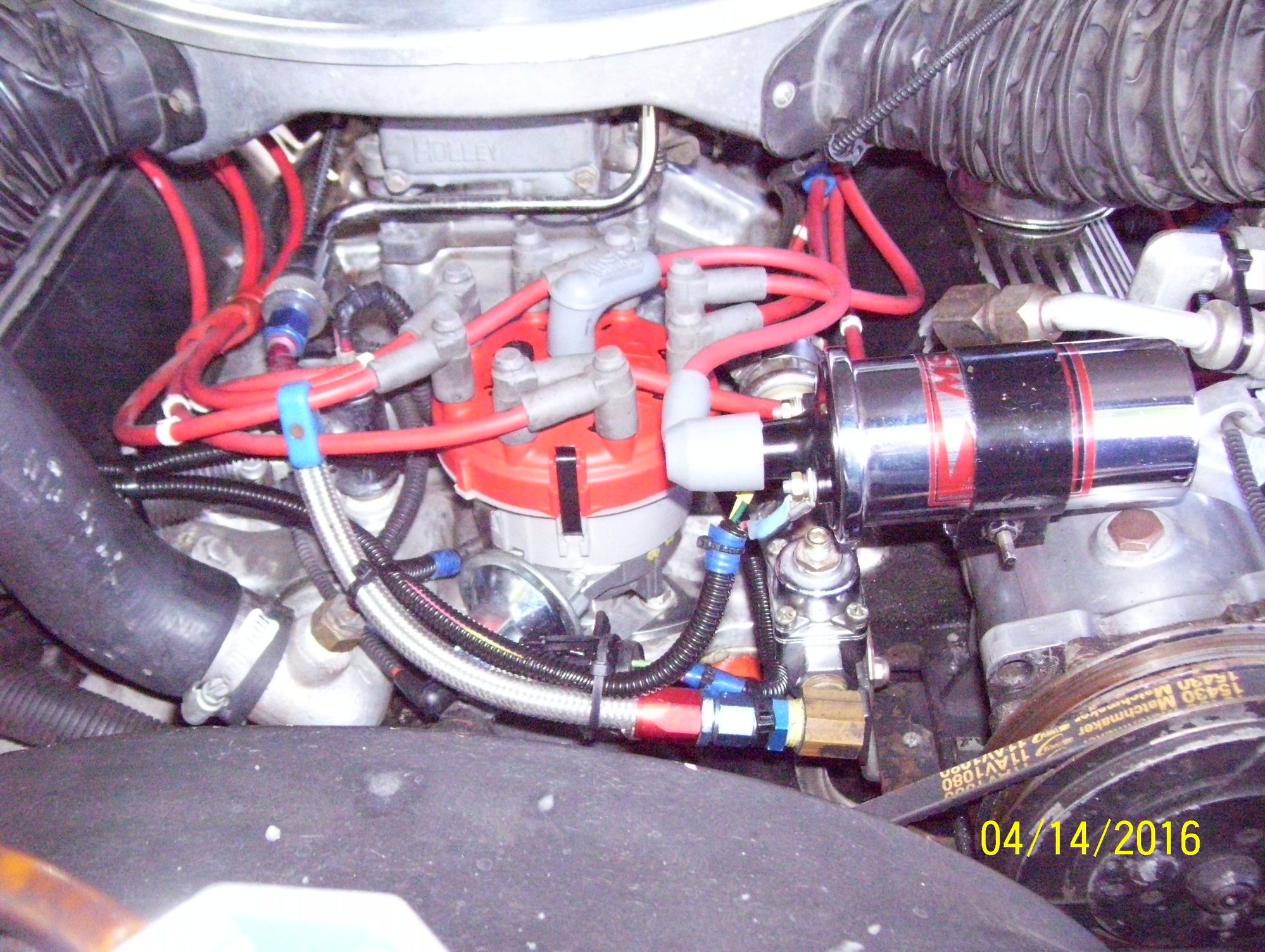

    I have it just hooked on the coil with no ignition box of any sort and it works excellent!! I have not had a single issue with it since the install. When I purchased it I was rebuilding my original one and after I priced it out, it cost more $$ to fix the old turd to make it kinda good compared to getting the new beautie that I have now and to use a modern style wire like the Ford Racing which are very cheap for a 9mm wire.. I didn't think to go on Summit and look at the description. Good thinking JEFFFAFA :thumbup

    If that's a oil filled Blaster II coil an when you burn it out then you'll find out that MSD warns against mounting in it's side like that.
    I think they did not filled it with very much oil cause it will over heat.
    This info is even on there web page when ordering it not you have to look for it.
    I had about 200miles on mine before it went out and had to have my truck towed for the first time.
    In that case the info I copied from there must be universal for their Dizzys and not specific to yours and the FE one I posted. What you say makes sense if you look at the pic that shows the wiring,springs etc that come with this particular FE dizzy. Is there something similar to a Pertronix unit inside your Dizzy?
    Orich
    Your not supposed to mount it on it's side?!?!?! Where did you mount it now? I noticed on the front of the head there is a open threaded hole. Can that hole be used as a mounting point? Thanks for the info!!!
    I found out that the oem ford dura II coil is the same as the MSD BlasterII
    so order two of them one for a back up

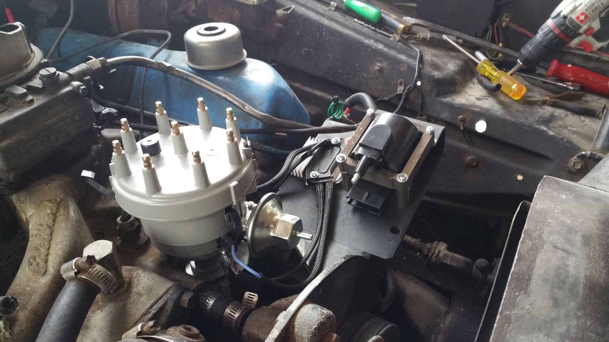

    Finished yesterday and it fired right up! Even drove it a little. Has some bog under load, but I still need to rebuild the carb and play with the timing (and hook up the advance). Where were you guys back when I had my 76?! Didn't even know this conversion was possible. Here's to the internet! You guys are great!
    I still plan on posting all the current part numbers. It took some digging, but every one of the parts I used is readily available at Oreilly, Autozone, NAPA, etc.
    More to come after Christmas! Happy Holidays everyone.

    Congrats! Looks good. I like how you mounted that module to a heat sink. There should be a vacuum nipple on the right side of that Holley. Hook up your vac advance to that. Between that and setting the timing I bet your bog will go bye-bye.
    let's hope so! Don't need perfect, just good enough to cruise around from time to time. Here's a better pic with the Ford 9mm's.

    Yep. And right there on the right side of the carb, in front of the choke, is the plugged off vacuum nipple to hook up the Dizzy's vac advance. I don't see the power wire going to the choke cap. Is there both wires hooked to it that I can't see?
