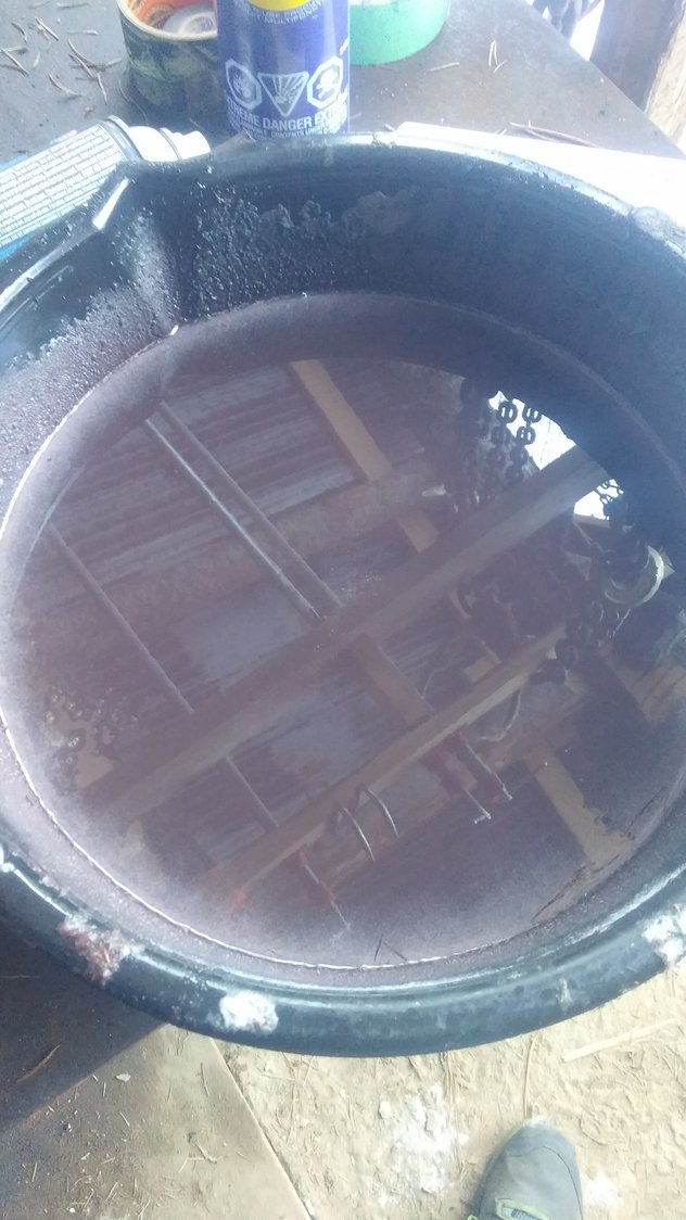

Drained the transfer case and this is what I found 4 month and 2000km old Royal Purpal synthetic ATF
So I put some 75w140 synthetic in it because thats all I had in the shed. Drove into town and no annoying noise. Actually the truck seems to drive quite a bit quieter now.
Now it is time to start looking for a spare t-case.
