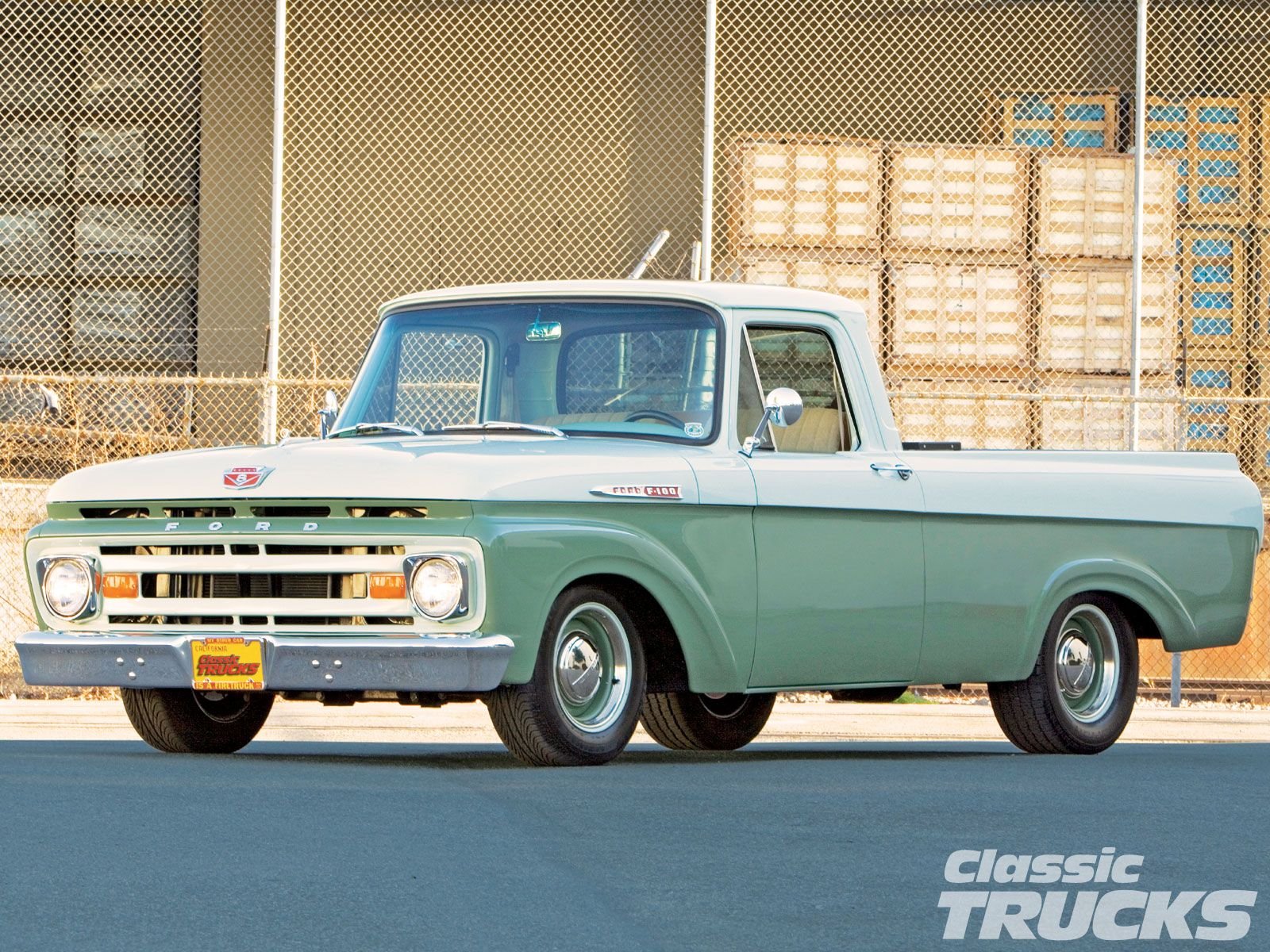

Can you tell by a picture if this is a unibody? 1978 460, D3VE heads, C6 transmission, Edelbrock intake.

Yes you can, and that is not one. A uni-body has one continuous body from front to rear, no separate "bed". On the doors, they appear to be from a 65/66 because of the "custom cab" on them, so I wouldn't trust the door tag being correct.

I didn't realize that the body was one piece. I thought it was an integrated frame.
The picture you post is a beautiful truck. I can understand the attraction to this futuristic design.

Uni's are 1961/63 F100/250 2WD only, the bed is welded to the cab.
The Styleside pictured in post #1 is not a Uni, as it's a 1964. Has 1964 body side mouldings, 1964/66 F100/250 2WD & 1966 F100 4WD Styleside bed.
Notice the '64 door has a "dog leg" scallop line, all non Uni doors have this dog leg. Uni doors have a straight thru angled scallop line that matches up to the beds scallop line.
Custom Cab nameplate same for ALL 1961/66 F100/1100's, Uni makes no difference.
The 429 or 460 has been swapped into this truck.
I thought that the Custom Cab on the doors for 61-64 was built into the handle, whereas the 65/66 had it as a separate trim piece that was mounted up closer to the glass such as in the OP's pic....?
C1TZ-8125622-A .. Custom Cab Nameplate = 1961/66 F100/1100.
The Custom Cab door handle guards were an option for 1963/66. When these were factory installed, there will be no Custom Cab nameplates...or body side mouldings.
Swoosh1958: Ford = Flareside, a stepside is a Chevrolet.
