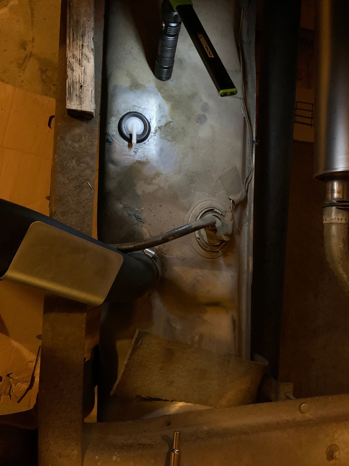

1973 F100 side tank fuel filler hose
Truck has an 8 ft bed, 2 tanks under the bed with fuel doors in bed side. 38 gal rear tank, probably a 19 gallon side or mid tank. Vent and filler hoses were radiator and heater hose. Bought correct replacement hoses from LMCTRUCKS. Rear tank both fit. Mid or side tank the filler hose is clearly too large a diameter for fuel tank spout, which is around 1.8 inches OD (1 4/5 in). Old Radiator hose that came off tank was around 2 in OD. I assume tank in truck not for this truck. Any experience in finding a fuel filler hose that will fit?
photo shows too large filler hose in place with shims that will probably leak when tested.
