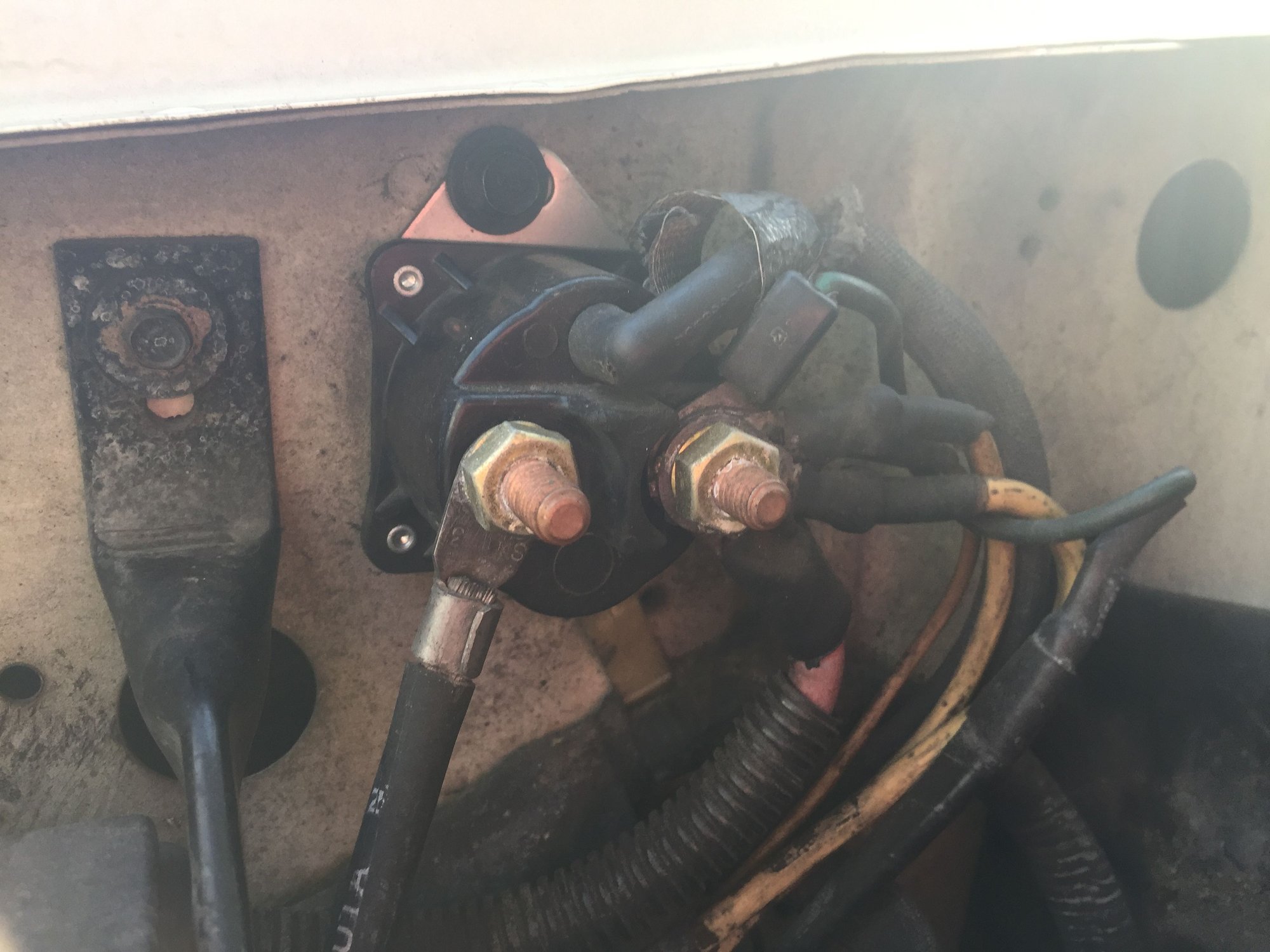

Let me start by saying im new to working on cars/trucks. I bought a 1989 Ford F150 Custom with an I6 and 2WD as a project/hobby. Currently im having issues with it starting. When it does start, it idles down and dies. I checked the battery and starter at Advance Auto and said they were good (for what its worth). Im in the process of checking the starter relay/solenoid along with the wiring that goes to/from. I disconnected the solenoid from the fender well in order to brush off any corrosion, rust, etc. but now I dont know which wires/fuses were connected where. I dont even know if the PO had them connected right. So I purchased a new Motorcraft Solenoid for the heck of it (only $20) and want to make sure I connect everything right.
In the attached picture you see...
3 yellow connections (circled in yellow)
The positive battery connection (circled in green)
What i believe to be the ignition lead, black L shape (circled in blue)
A defective/messed up 14GA fuselink (circled in red)
The other end of positive battery connection (circled in white)
Whats not pictured is the negative end of the battery connection.
So tell me, what goes where?!?!?!?!

I have the same truck. Had a similar problem. Replaced the solenoid and then the started kept staying engaged after the truck started and blowing the starter and the solenoid. Happened 3 times before I figured out the aftermarket solenoid is the problem. (So annoyed at my solenoid). The aftermarket have 3 posts and the legit ones have 2 posts. Hope this helps. I've owned my 89 for the past 10 years and had a wrench on every part of it at some point it seems.... haha

Make sure the solenoid is attached snug too, since that's the ground!

I don't see the cable that goes from the solenoid to the starter.
All the wires go on one post along with the positive battery cable(circled in green) EXCEPT the cable that goes down to the starter.
I'm not sure what that is supposed to be circled in red. The cable on the end of it looks big enough to run to the starter, but a 14 gauge fuse link wouldn't work unless it was converted to a 1992 or newer starter.

Turns out that the new solenoid Im waiting for Amazon to deliver today was/is the wrong one. I found the 2 post unit after seeing it on the NAPA site listed as an "Accessory Relay".
As for the 14ga fuse, I have no idea.
