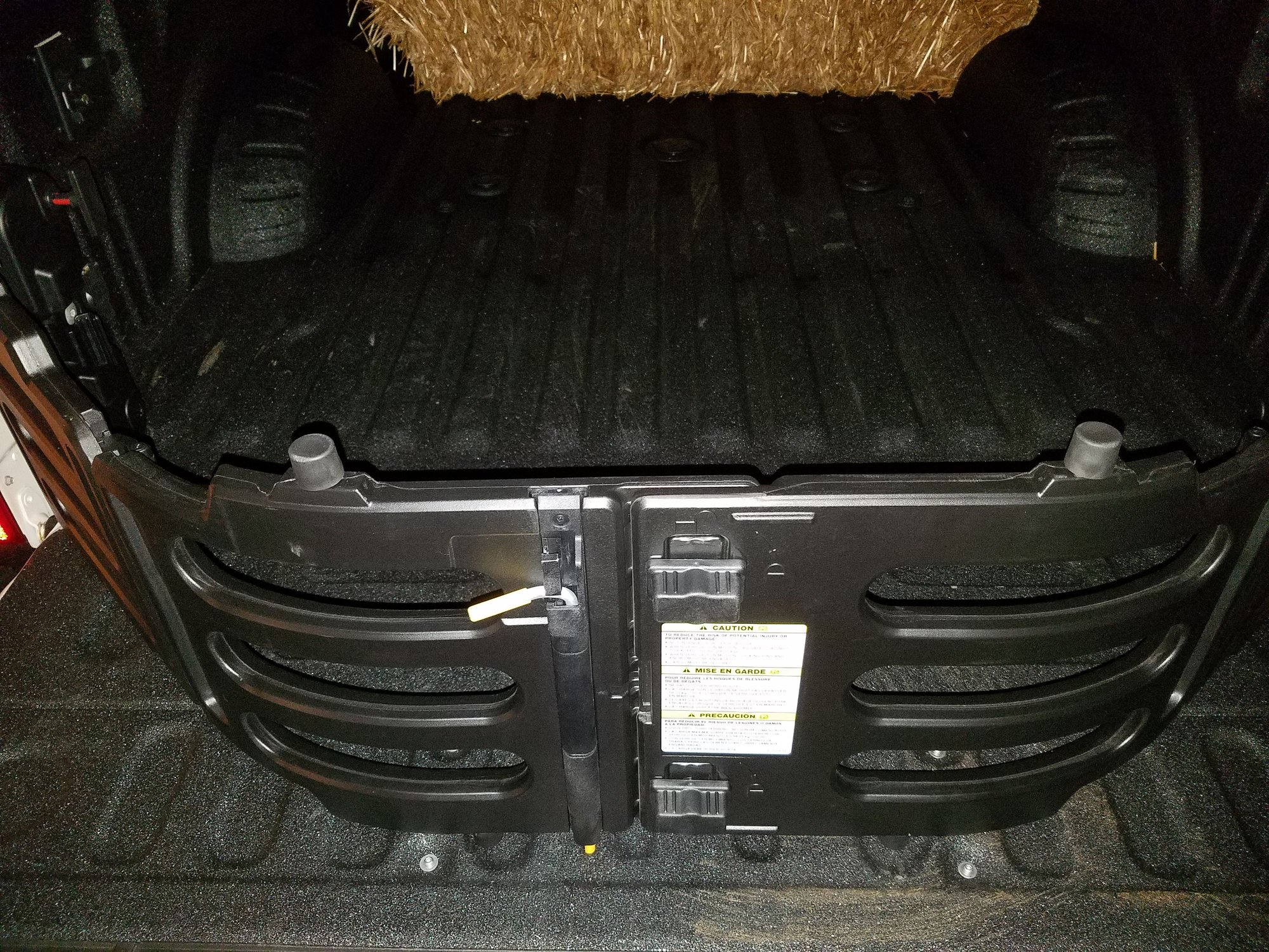

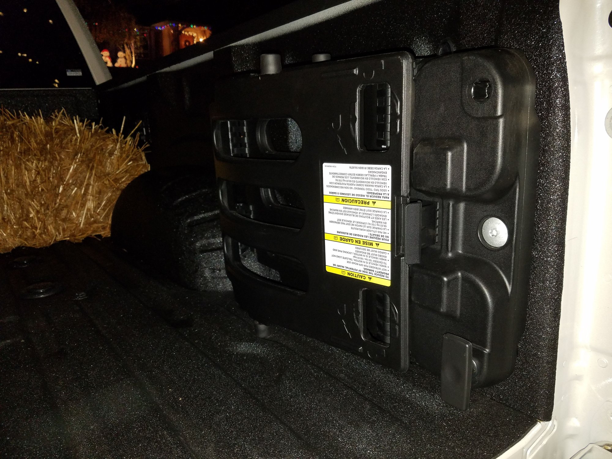

Originally Posted by Mgjfam
Tuclai .... please let me know if it fits!
Thanks!
It fits, they only thing I noticed were if you torqued it to the specified torque setting then it will be very tight spinning from inside bed onto tailgate. This is due the the spray on bedliner adding thickness and rubbing it, I can live with it for now not being torqued to spec, I will look at adding some washers when I have time. I like the ford OEM because I also have a rollup bed cover and it works with that vs. the standard AMP research ones which will not work if you have a roll up bed cover. And it being able to fold is a big plus too.
Looks like in the "stowed away" position that the fifth wheel trailer plug in the bed is blocked, can you confirm for me? Looks like it would have to stay "built" in the bed to be able to use the trailer plug?
This is correct. This is why Ford won't let you build a truck on the website with the gooseneck/5th wheel prep kit AND the foldable bed extender. But you can remove it when you need to tow gooseneck or 5th wheel.
