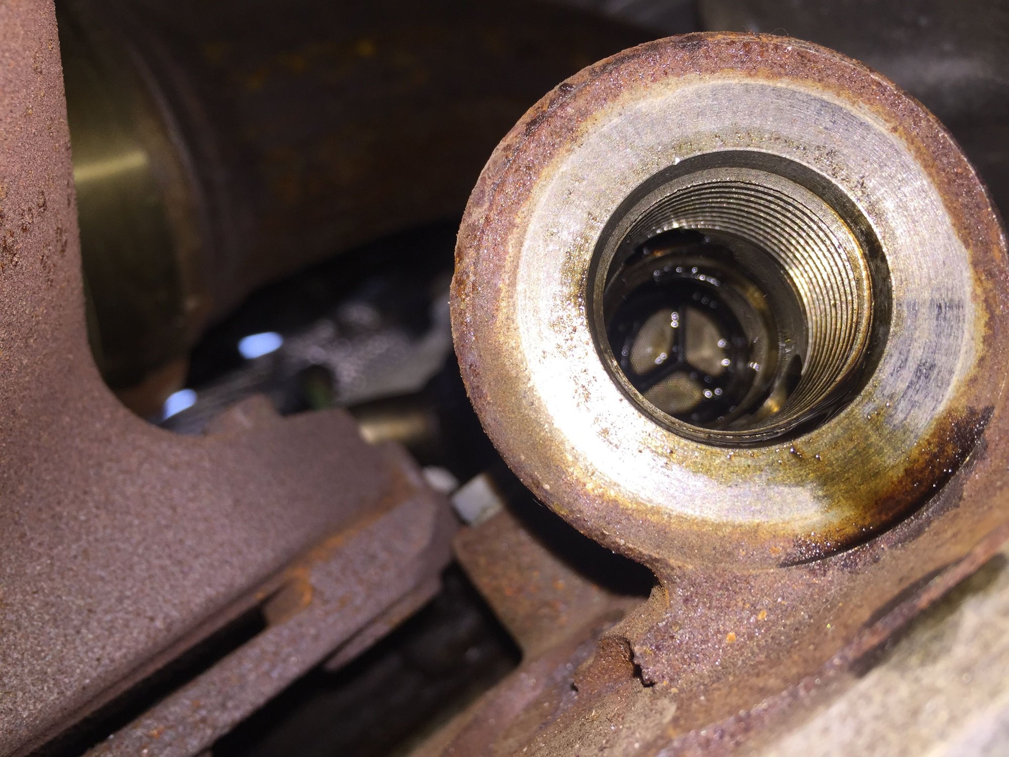

2004 F350: I haven't posted in few months. I put an air cooled bullet proof oil cooler on and all has been well until last Friday. Turns over fine but won't crank. torque app says ipr at 83% but hpop only getting up to 290psi. Base oil pressure not reading on the dash gauge but pumping thru oil lines. When I parked it is was running fine! I pulled the IPR to find there is no screen on the dang thing. It must be in there somewhere?? Of course you can't see in there. I'll try a mirror tomorrow to see if I can see it. Unless someone gives me a clear cut course of action, my thoughts are it's probably the hpop and will start to tear it down. Just wanted to see if anyone has any thoughts. ???

After re reading you were into the HPOP resevour it seems logical that the IPR screen could have caught some debris. If the screen is missing then a new IPR may be needed. Sometimes they can be cleaned and re used.

Use your phone to take a picture of the screen stuck in the HPOP. Mine fell off while removing my IPR.

I used long needle nose pliers to pull the screen out. I had the crank no start issue, too. I had to replace my STC fitting. It starts and runs fine now
