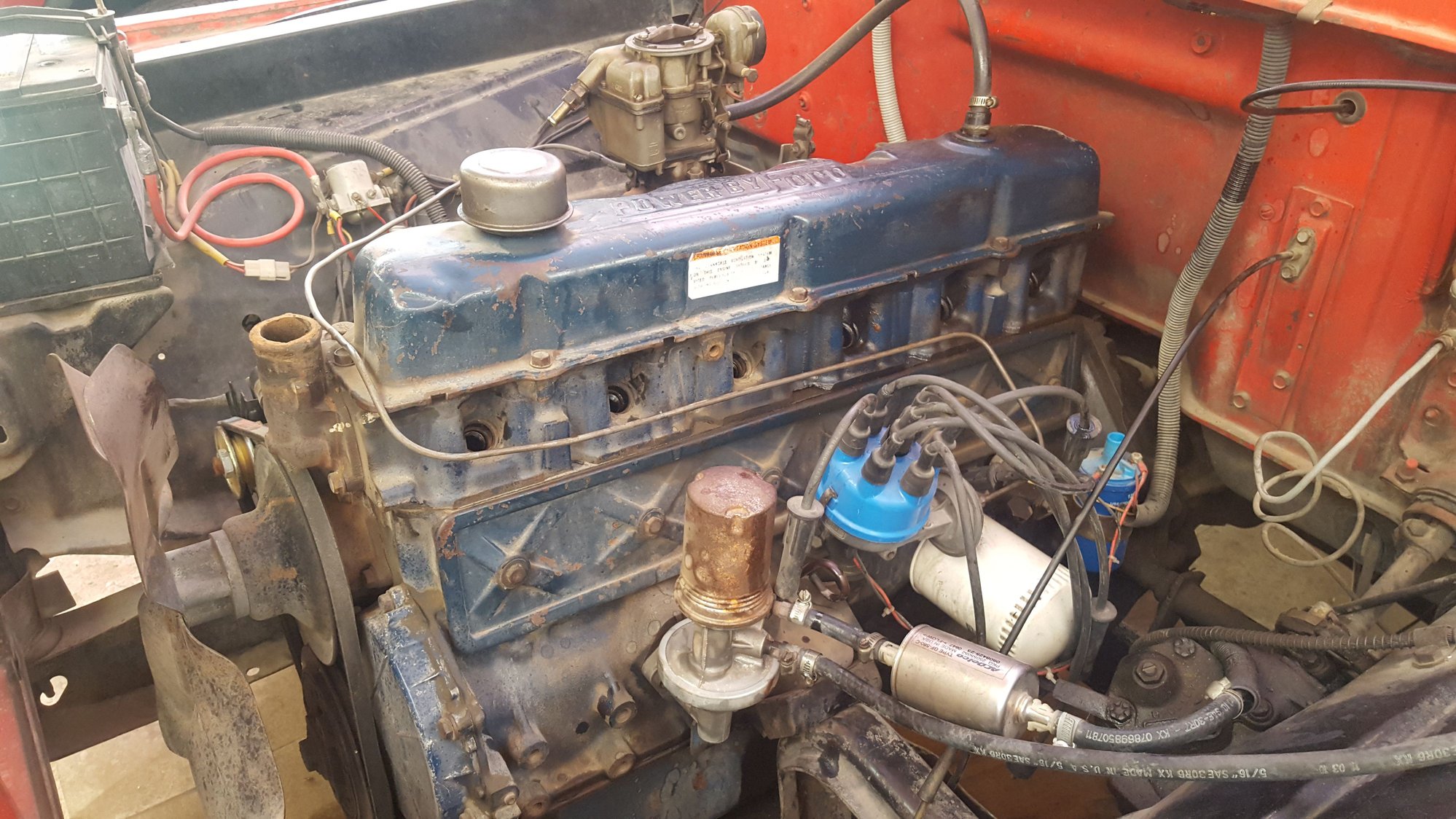

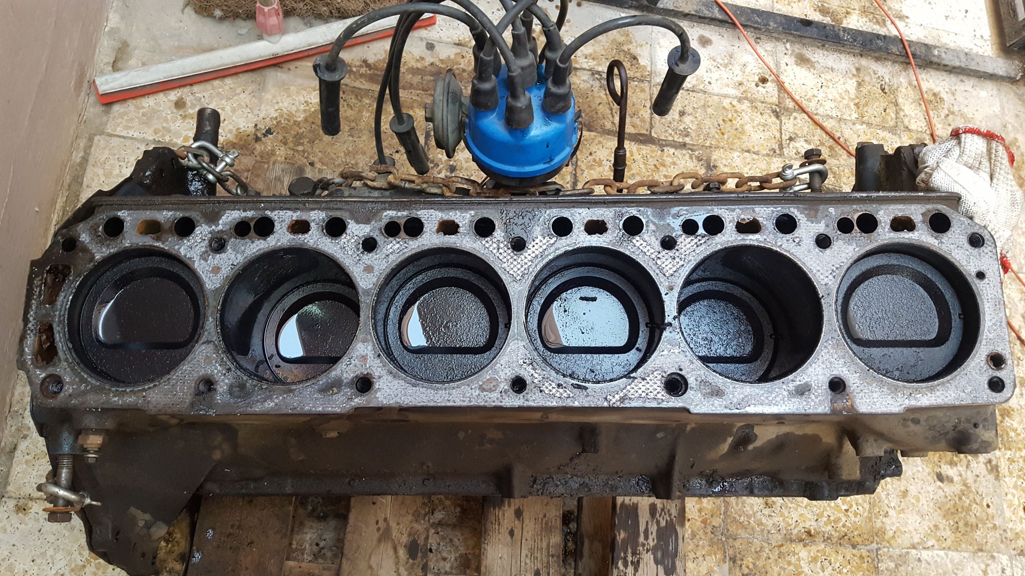

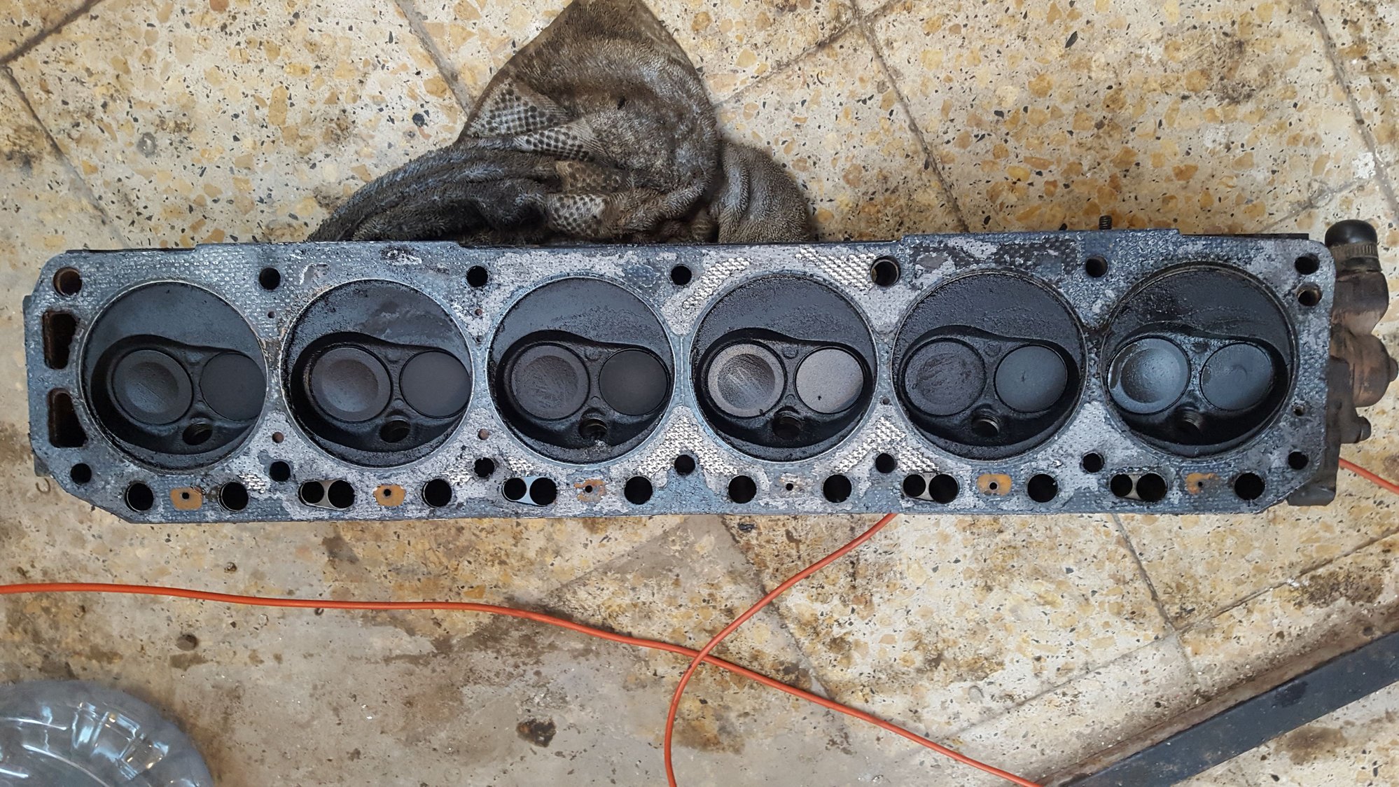

I am attaching some photos as it might help. Thanks for your sharing.

That engine looks good for 13 years of driving on it. It is possible that the cracked exhaust manifold is contributing to the misfire. On my V8 motorhome I'v cracked two manifolds and both times the engine had an erratic idle, probably due to sucking cold air back into the cylinder through the crack in the overlap cycle. I would clean up the head and do a valve job and re-gasket it. You will likely find coked up intake valves. Its too bad you did not do a leakdown test on it as that is more definitive than a compression test

I should have done the troubleshooting before tearing down the engine.
Anyhow I am planning to re ring the pistons, put a new main bearing rear seal and re install the head and do the leak down test. Hope it will be OK.

Check the piston skirts for cracks - a very common problem on hi-mileage engines. If you find you need new pistons go with the late model hypereutectics.
Reassemble w/ a FelPro #1024 premium head gasket.

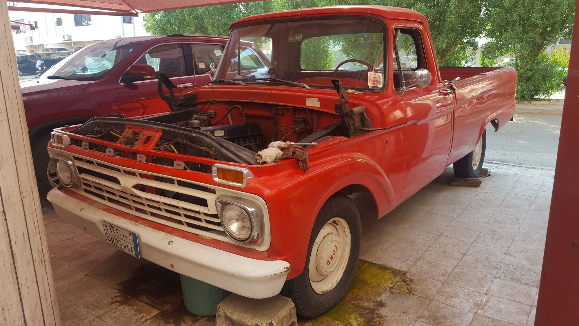

You're welcome. It looks like a nice project and doesn't look all that bad to me considering the sandy, windy operating conditions it must have been exposed to. Getting the right parts over there must not be easy. Good luck with your project.

That. Is. a Nice. Truck!
Wow!
I'd fuel inject it... or leave it as is... tough call, and not mine to make Whatever you guys do, take photos and post them!
