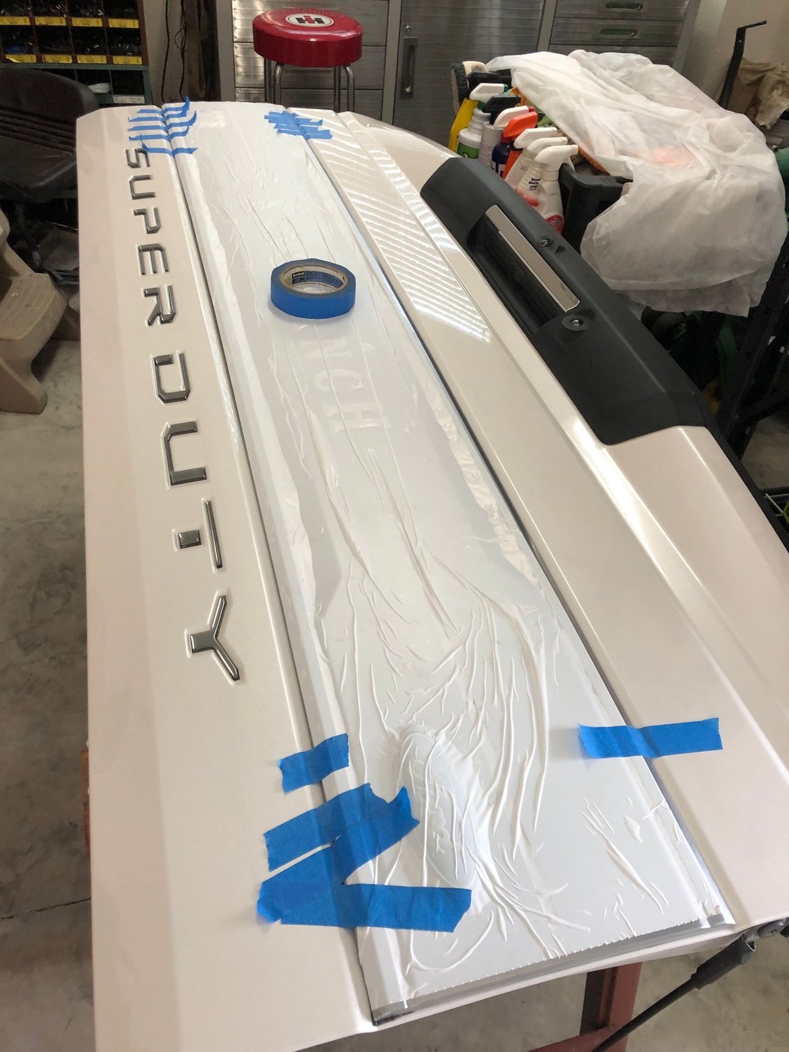

Appliqué install...purchased from Ford dealer, 3m outdoor extra strength tape from Amazon. 5 rolls. Clean well. Very well! 3m adhesion promoter #4298 from amazon 5 pk. Not a bad job. Will take 2 at certain points
