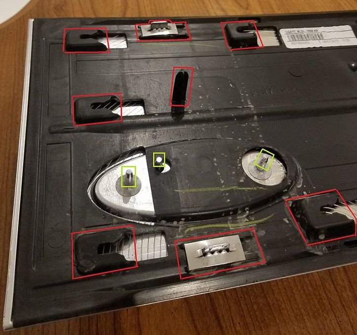

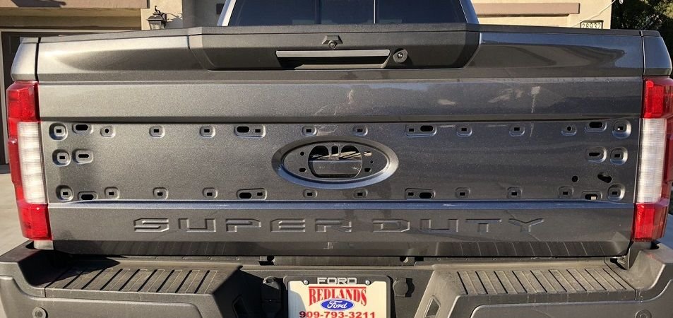

My dealer’s parts guy quoted me $450 + sales tax for the KR applique. Buying it there allows me the option to refuse delivery if it arrives damaged. Adding this applique may be one of those situations where the correct path is not realized until all the parts are in hand. But before I order, please entertain a few questions of mine. After studying this photo of an OEM pre-punched tailgate, I’m left wondering if separating the inner and outer layers of the applique is really necessary.
In lieu of separating, couldn’t the high spots (see red boxes below) of the inner layer be trimmed/removed to allow clearance? Did the areas in the green boxes need trimming? It seems logical to me that if this applique comes installed on the Ultimate-option trucks with both layers, shouldn’t both layers remain intact when adding the applique to a non-Ultimate truck? I would leave the central alignment pin intact to use with the hole behind the large blue oval. Of course that means I’d have to remove the large center blue oval.

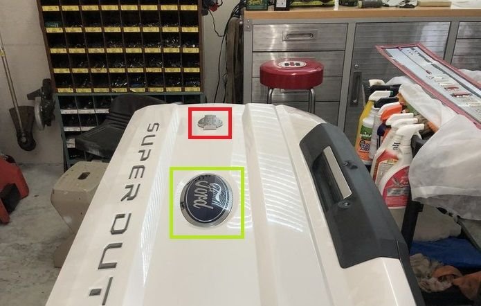

And that brings me to my last questions for Swampyankee. Were the large blue oval and KR badge emblems removed prior to double-back taping the applique in place? Or was only one removed?

I may have answered my own question in regards to leaving both layers intact. The non-punched tailgate (like mine) on the left has a gradual recess angle whereas the pre-punched tailgate appears to have a distinct step in the same area.​​​​​​​

the blue oval and KR emblems were left in place...
i do not not see how you could leave the inner (black) piece in tact and complete this mod on a “non-chrome packaged” truck

Thanks for the emblem info. As I mentioned in post #17 above, I am now seeing why the two layers cannot be left intact, Thanks again!
