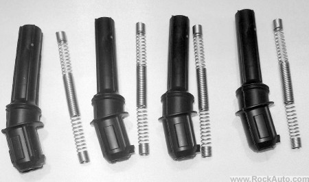

Final Update....thanks to Amazon I was able to get a new set of coils/boots/springs and Motorcraft plugs for $58.00. Took about 5 hrs to install and today I put about 100 miles on it without a "stumble." Old boots looked alright for the most part but I pulled NGK plugs out with some having very little electrode left and definitely over-gapped.

NGK were not OEM plugs, and looking at your picture of one, solves the question that these Mod engines Need Motorcraft plugs.
Were you surprised to find how deteriorated the plugs were??
The cost of new springs and boots I think out weigh the time just to get in there and replace the plugs, cheap insurance.

Yeah, Wildman, a few of the plugs stunned me. We're talking about just the tip of a needle remaining. Don't know how it ran and idled as good as it did! Never took one of those coil assemblies apart and like you said it was cheap piece of mind to replace the whole shebang.
