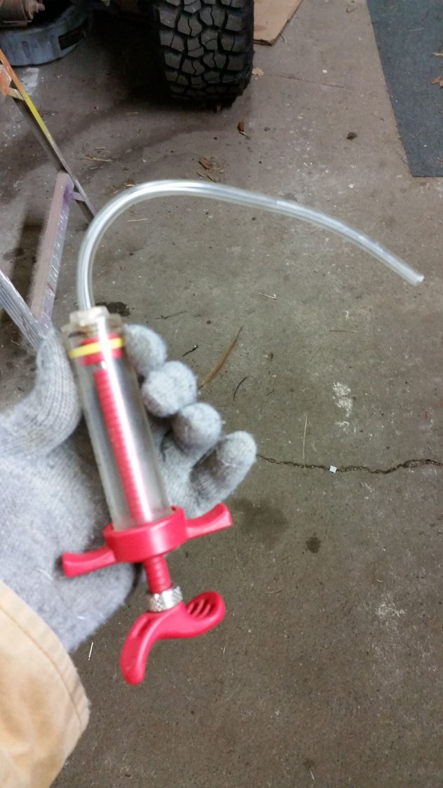

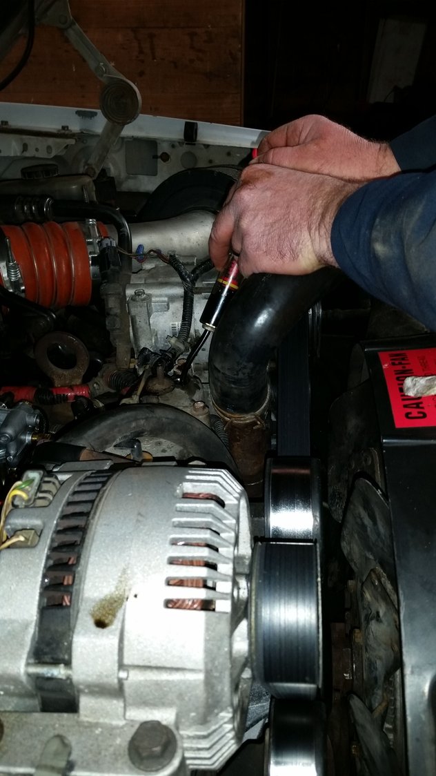

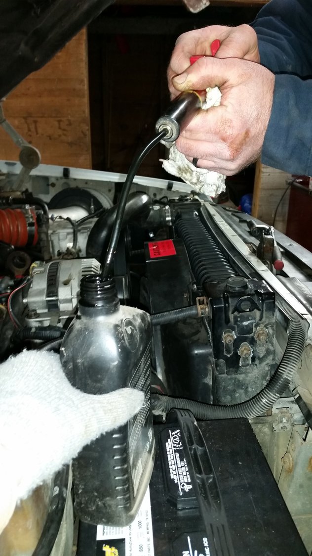

Our homemade siphon for the hpop

If you are siphoning the HPOP reservoir out to get ALL of the old oil out, then you can't stop there. There is close to a quart of oil in each head that will have to come out also, or it was totally useless to siphon the HPOP reservoir out. The best way to get it out of the heads is to pull the oil galley plugs on the back of each head and let the oil drain out down the back of the engine (kinda messy). If you do this, I recommend putting new o-rings on the plugs before putting them back in. There is two or three times as much oil in the heads as there is in the HPOP reservoir.

^^^ Bill is correct. There is about 2.5 quarts in the HPO system. If you change your oil regularly then you won't need to worry draining/siphoning the HPO system. However, since this is a new-to-you truck what you're trying to do this time isn't a bad idea at all!

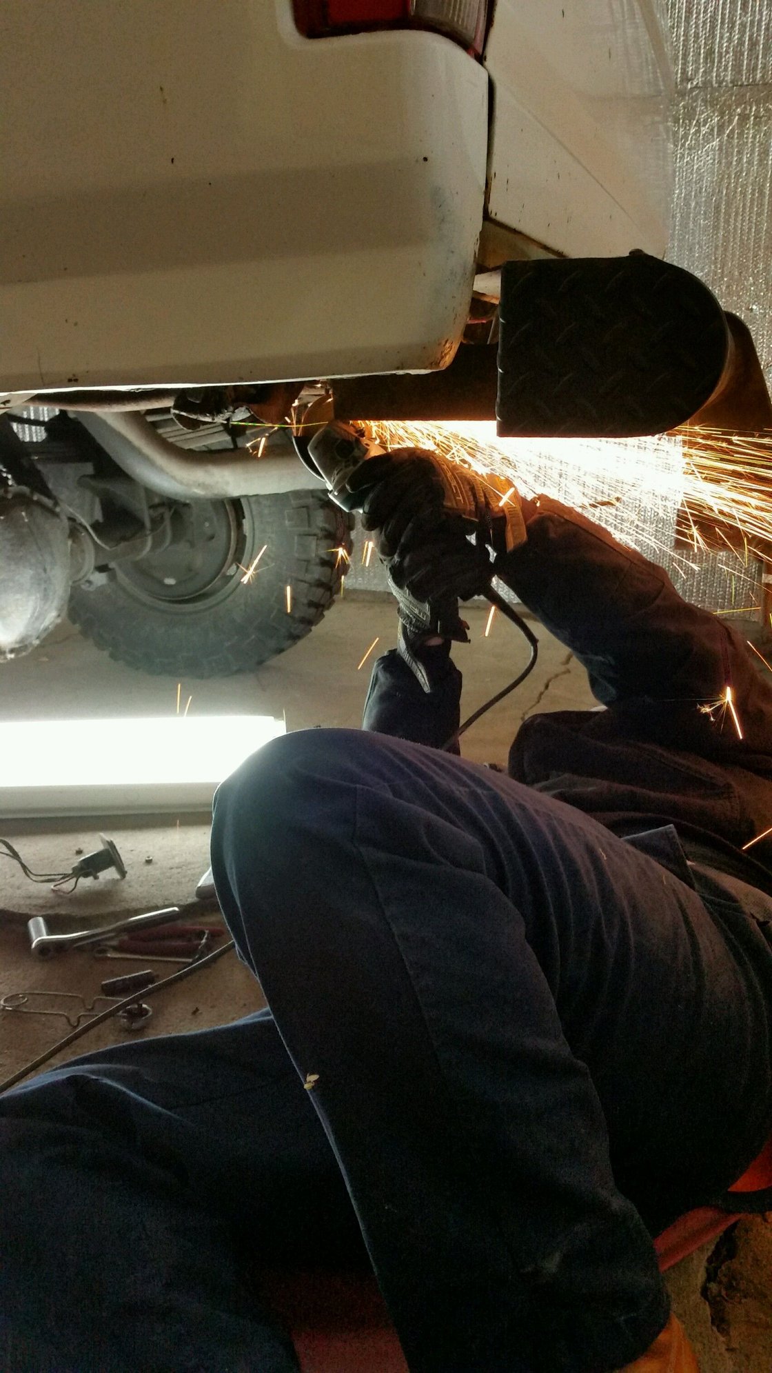

grinding the welds off the rear ranch hand bumper to remove it
