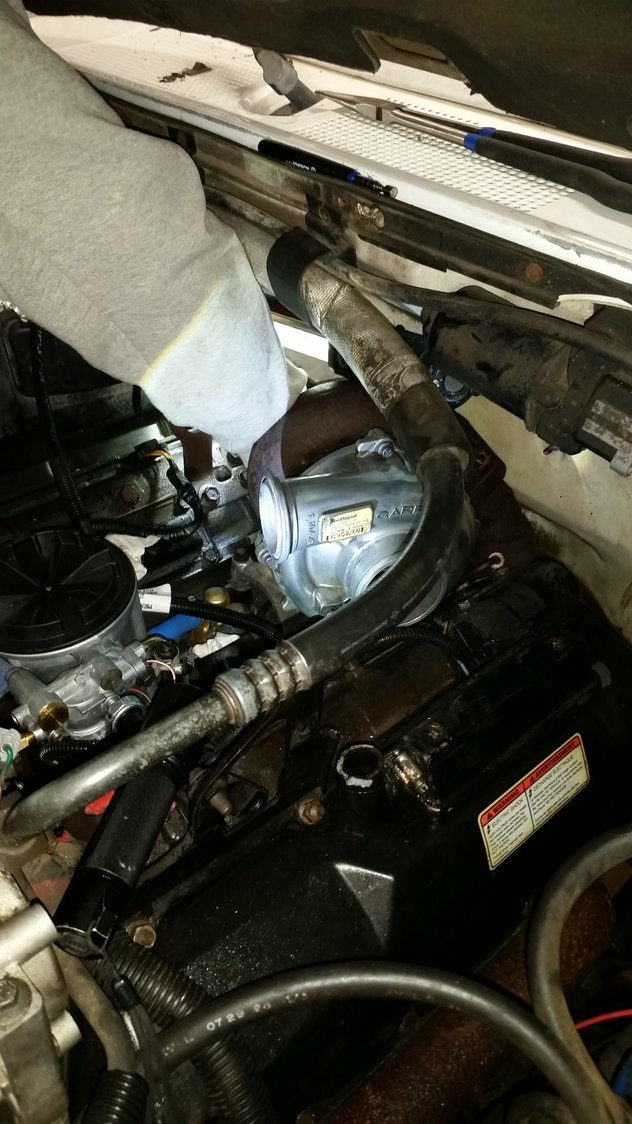

Getting closer!! We will finally have the truck running tonight

You have to be part monkey to work on these trucks lol

I'd suggest a topside creeper for working on these trucks...hth
mojo

I use an old couch cushion or an old blanket folded up and lay on that.
If I had a matching spare hood.... hood stack!
All these pictures make me want to go wrench on something.
