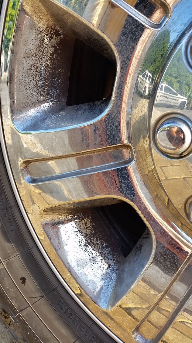

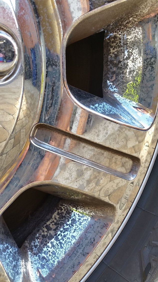

So I scrubbed them way longer than I should have. they seem to be plastic over metal if that is possible. I used purple power degreaser after trying just wash and wax soap. No luck! any idea how to get these Crappy wheels clean? And yes they are factory Ford wheels.

Looks to be brake dust, get a specific cleaner for that and see if it works

Those look like chrome-clad wheels. They do not hold up to a heavy scrubbing and some chemicals. I used Meguiars Cleaner Wax on the ones I had on my F150. Took most of the stains off.

They have a plastic sound to them when u tap them. almost like a hubcap over a wheel. Didn't know Ford put those on a Lariat?

Try some mild metal polish. I've had good results with the green Intimidator Pro Polish or White Diamond polish. just test in a small area first because if you get stuff that is too abrasive it will leave scratches on the chrome.
Most of that is brake dust damage but if you're close to the ocean the lighter colored stains could be from salt too.
