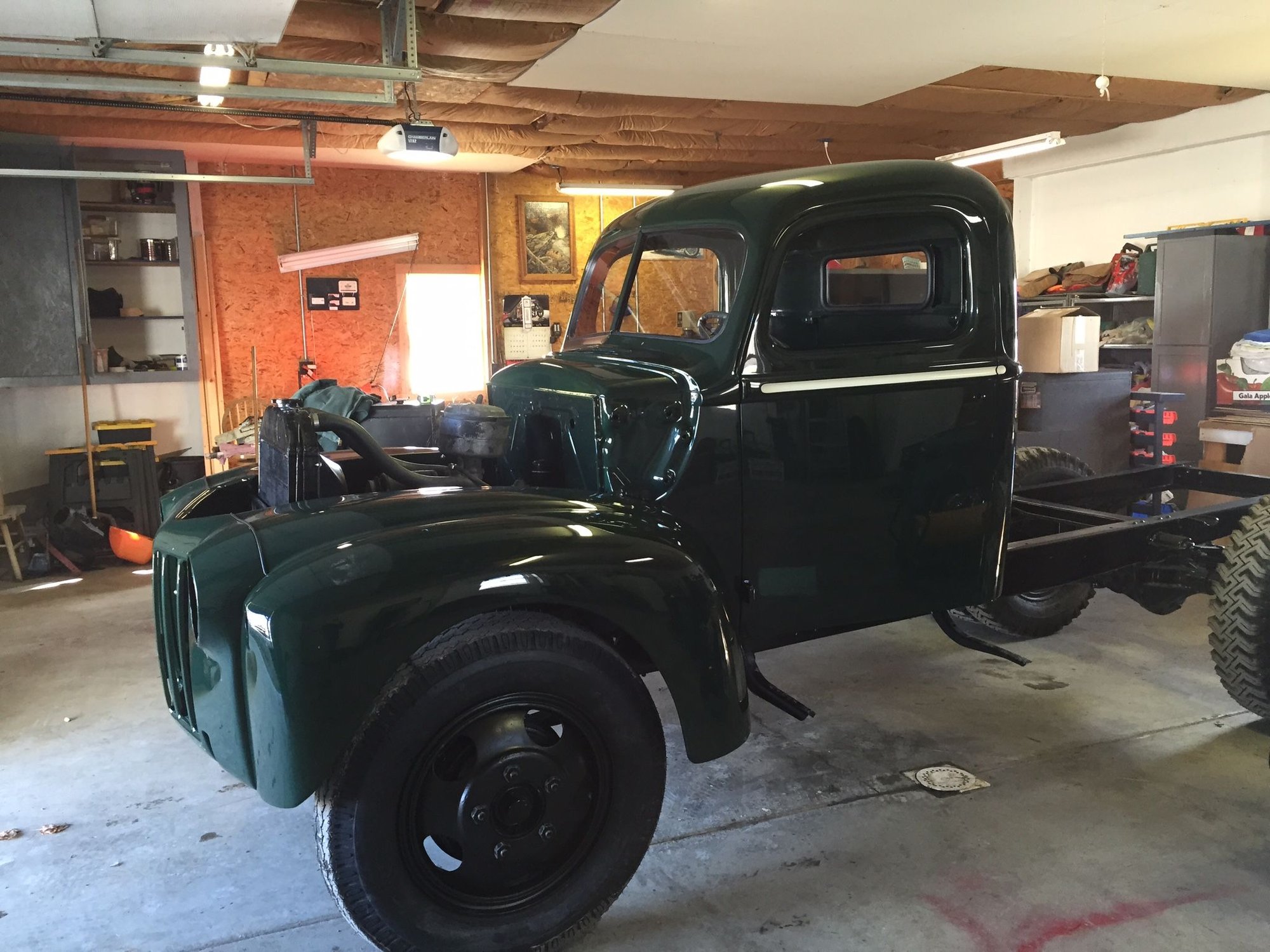

need some info, found a 46 1 1/2 ton grill assy fenders and hood, will they fit a 47 half ton?

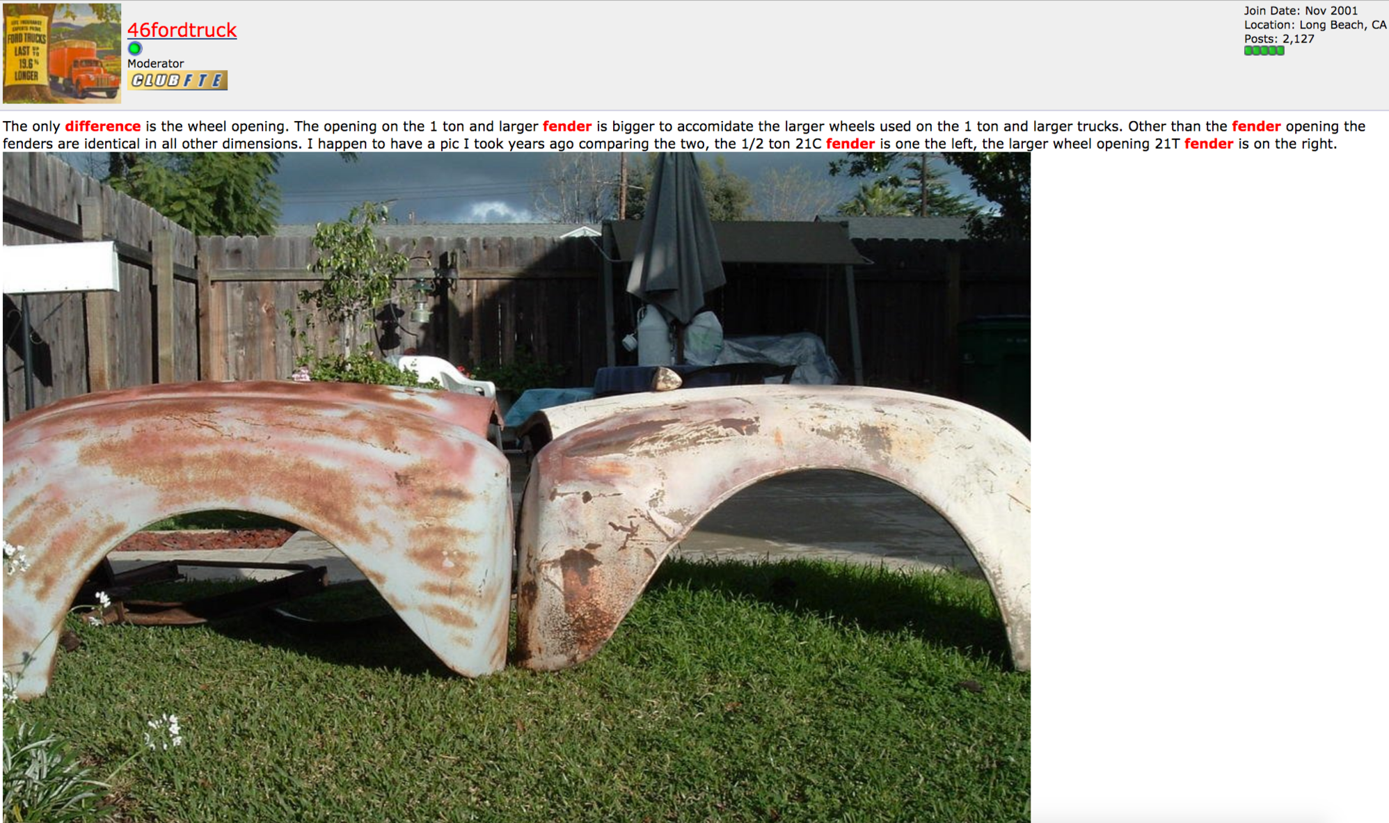

Yes but the wheel openings are larger

This is a 1.5 ton truck fender with a 7.50x20 tire/wheel combo. It wouldn't look good on a 1/2 ton truck with a smaller tire/wheel.
