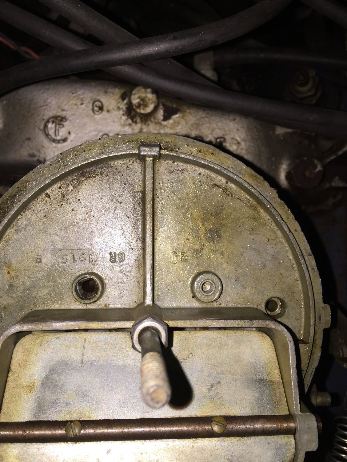

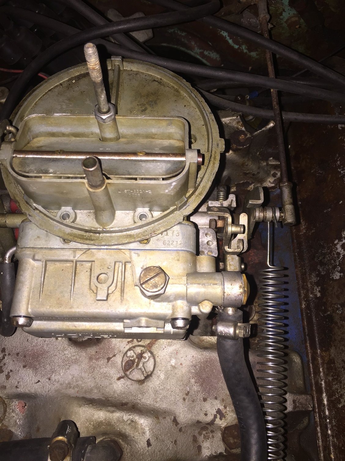

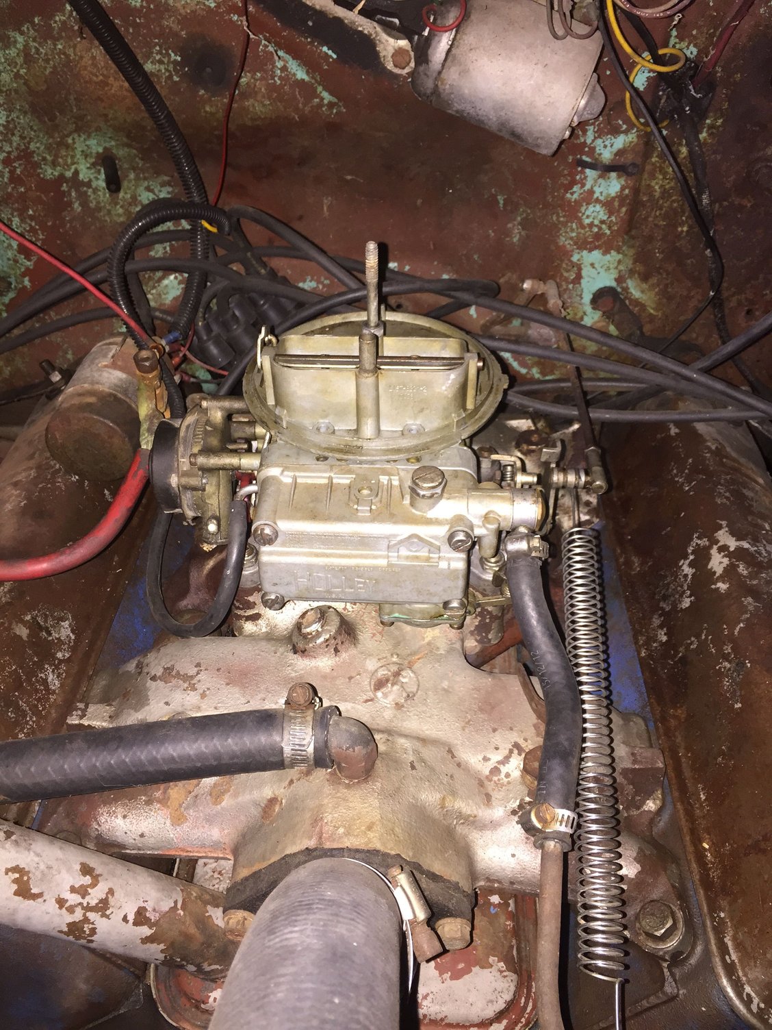

Need help identifying this carb please. My research leaves with with nothing remotely close to what this is. There is no ID tag as you can see but there are some numbers that maybe look familiar to you all. James

The numbers on the front of the choke air horn are the ones to ID it. Look for a list number, tons of websites to tell you what it is.

2 bbl holley should not be to hard to find go by the year and engine size
looks like a common holley good luck is that a 289 by chance

Y block, not small block Ford(289)

That is a Holley 2300 2bbl - with an electric choke conversion. Standard equipment on the 292 Y block

I don't think that is an original. None of mine have the banjo fitting fuel inlet. Probably an aftermarket unit.
