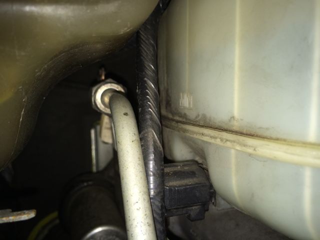

I went out and had a look and took a photo.
Check the engine side of the reservoir and see if the connector
is still attached and in good shape. It might just be that the
switch is stuck. I think it may just be a reed type switch.
Fender side of the brake fluid reservoir
Engine side of the brake fluid reservoir
Sean
6.0L Tech Folder

I've looked at it a few times but I guess I assumed un screwed somehow. I see the pig-tail for sale so I guess it's an integrated part. perhaps I can jiggle the wire and possibly removed the screen, drain and wiggle something down in there. It really sucks because cruise control isn't working now.
