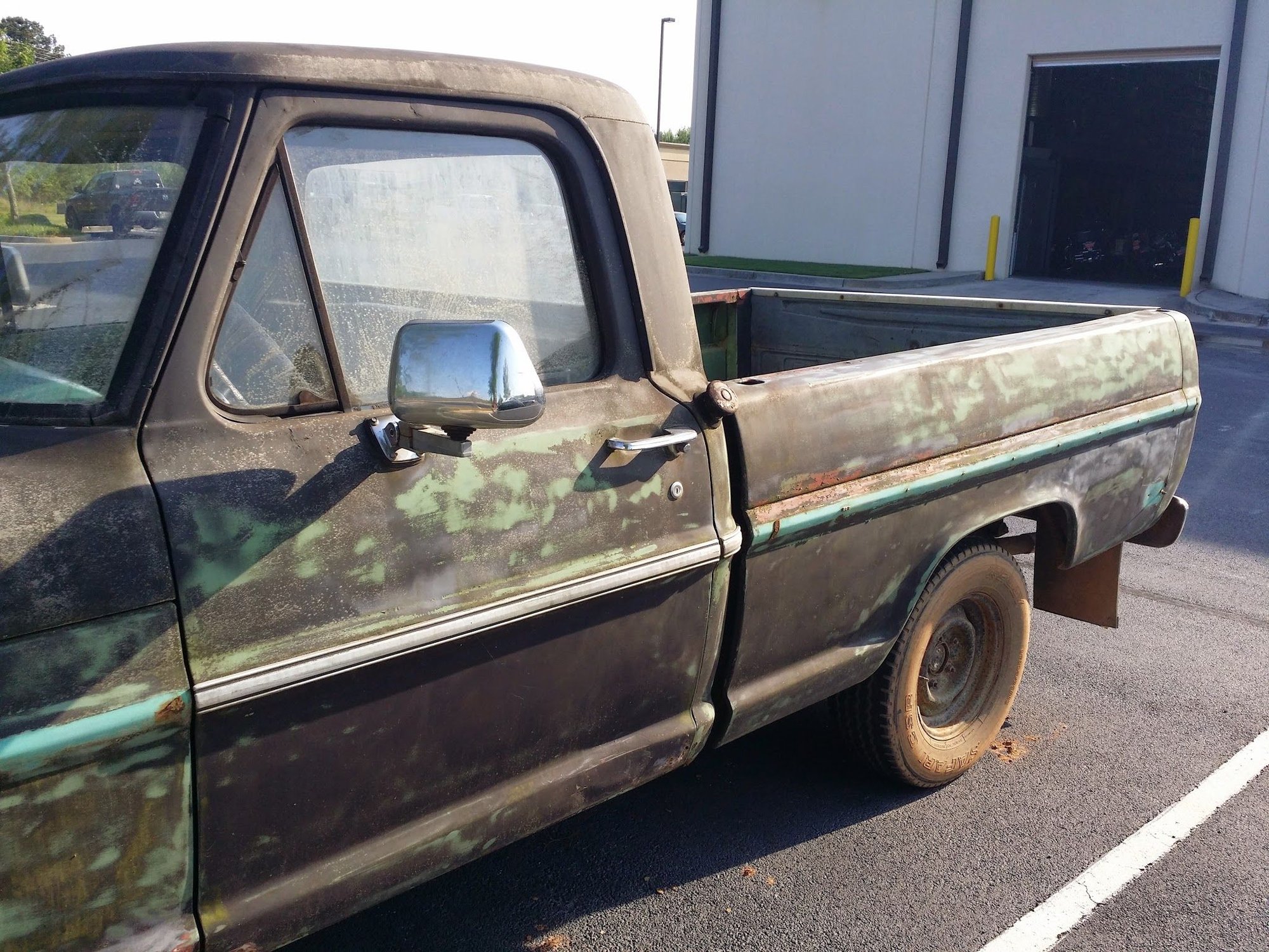

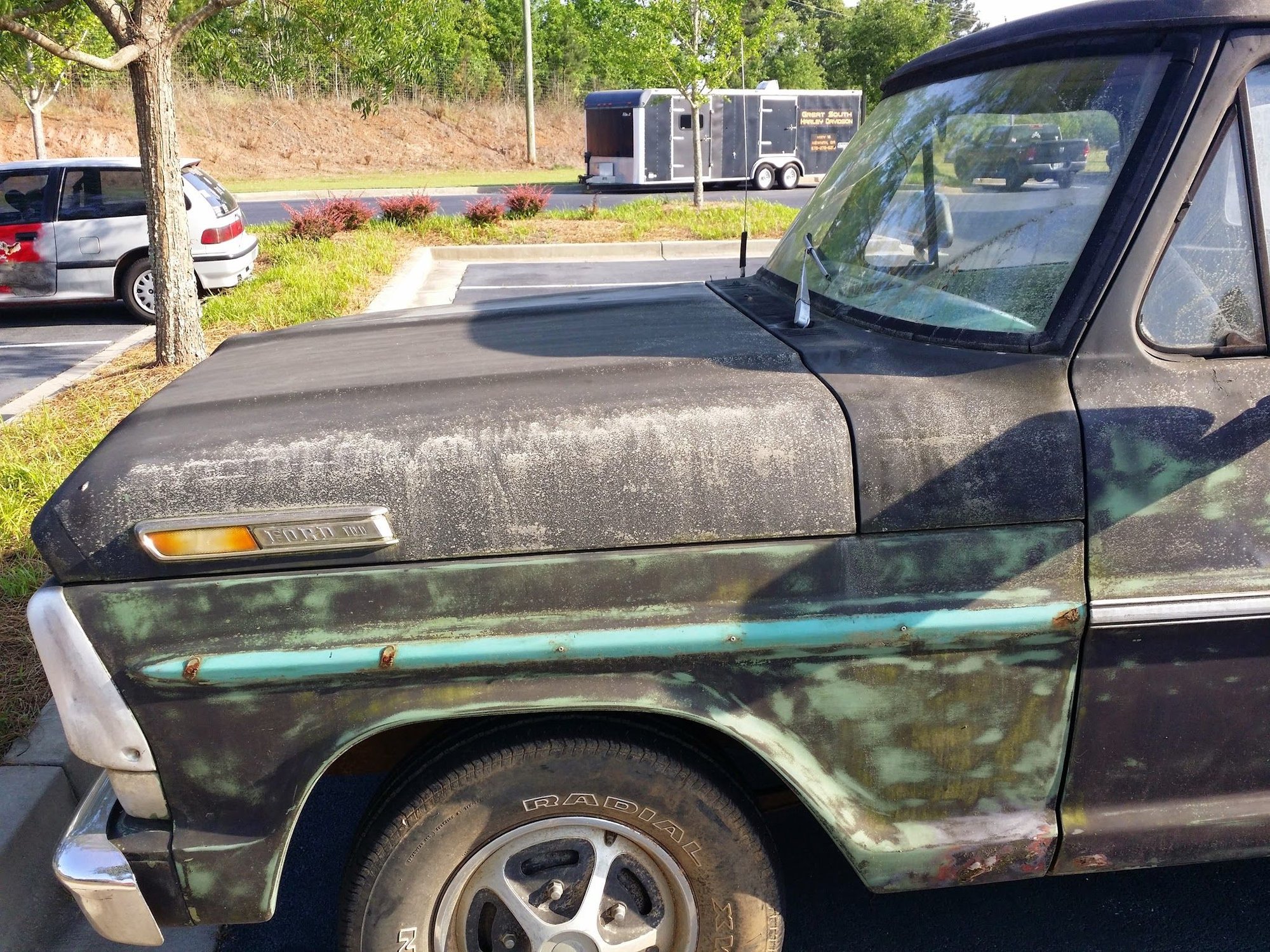

Ah OK. I'd like to turn it into kind of a rat style truck. The paint is in pretty terrible shape but he put on a flomaster exhaust so it's got a great sound to it. I'm hoping to get a relatively cheap paint job to get it black and have a cheap fun truck to ride around in.
I'll ask about the VIN.
Pictures of exterior - he has replaced the tires and wheels since these photos.

Don't paint it! You want a Rat Rod looking Truck, keep it like that polish it a little and then clear coat it. That truck has earned that look. I'm doing that with my project (68 F-250). I am going to buy new trim mouldings though, mine are beaten up and some are missing.
Enjoy, it's always cool when your in a Home Depot or Lowes and someone in a new Ford stops you and ask what year your driving. It drives my wife crazy, since she wanted me to buy a newer model.
