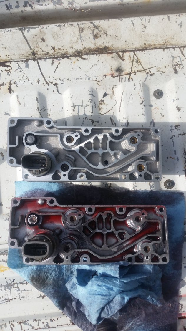

The newer style solenoids have an extra hole in them for fluid to flow. using the older style blocks this hole on the valve body causing reverse feed of fluid in 1st and 4th gear which equals big problems

I'm not sure where you read that from? It's very common for people to swap the older solenoid packs onto newer transmission cases.

I didn't read it anywhere. I compared them both in person. the top pack is out of the 95, you can see the extra hole. that's when I read about the reverse feed. using the older solenoids blocks this passage on the valve body

People swap these older solenoid packs into newer transmissions all the time without issue. Also, keep in mind that the newer replacement '84-'94 E4OD solenoid packs have that hole too.
FWIW, when we did a shift-kit install in a '96 E4OD, it didn't have that hole.
