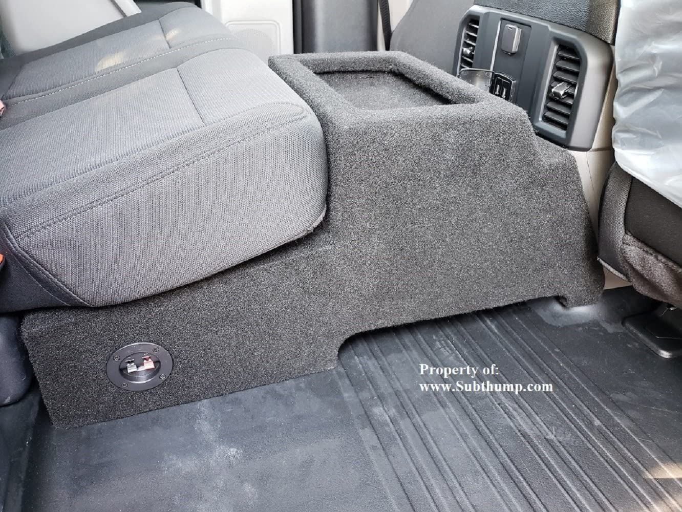

I'm about to remove the single rear seat (passenger side) and build a box right there! HA!
I don't want to use a shallow mount sub, and can't find anything that will house a full-size sub that will fit under or behind the seats (well...not the sub I want to use. 5-7/8" mounting depth)

Why not just get an under seat enclosure that’s made to only go under the passenger side rear seat or a behind the seat enclosure.
Also, you won’t spend anywhere near $3K plus and you’ll still have storage.

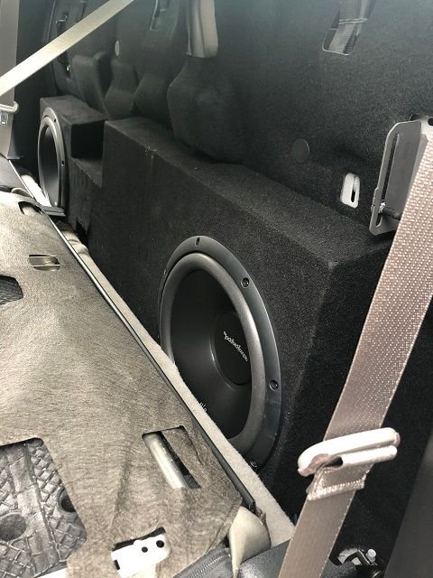

Here's a picture of the box behind my rear seat. I have shallow mount subs (5 1/4" I think). It's a pretty tight fit but the seat backs do click back into place easily. My amp is in the storage tray under the rear seat. My truck is a 2019 XLT CCSB.

NICE. Prefab or custom? Sealed? Be ideal if there was a kit to move the seats inboard for additional room.
I'm with ATC, remove the pass. side and run a 2.5-3 cube vented, downfiring enclosure with a single 12" or 3.5+ cube vented 15". I am a hardcore DD Audio fan. Used to like RE as well, but way out of touch with car audio to know current offerings so even more inclined to stick with DD. I am resisting the urge to return to bassheaddom. Especially after having just sold my vintage Cadence monoblocks. I also listen to 90% rockabilly. Have 2 powered, vented 15's for the house. I have a small database of custom enclosures and LOVED designing custom boxes down to 1 thousandth of a cube considering displacements and port correction, observing ideal rules, etc. Even some adjustable tuning.

Hmmmm...I really wish they made one for a Supercab!

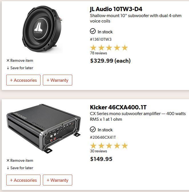

Since posting that, I think I have figured out my sub and amp. I still haven't made up my mind yet on a box.
I'll get a separate 2 or 4 channel amp at another time for my door speakers.
https://www.crutchfield.com/p_13610T...-10TW3-D4.html
https://www.crutchfield.com/p_20646C...CXA400-1T.html
