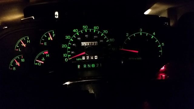

Does this look like a bulb may be burnt out?
It is dark between 5 o'clock on the speedo and 8 o'clock on the tach.
Where are the dash lights and what type are they?

Looks like a dead bulb to me.

How many bulbs are in the cluster?

There are 5 #194 bulbs in the cluster, for illumination.
2 #37 bulbs, for turn signal indicators.
Around 20 #37 bulbs, for the various notification indicators.
There was a bulb and holder missing, for THEFT and I don't know how important it is.
I replaced the 194's and the 2 37,'s and left the rest alone.
