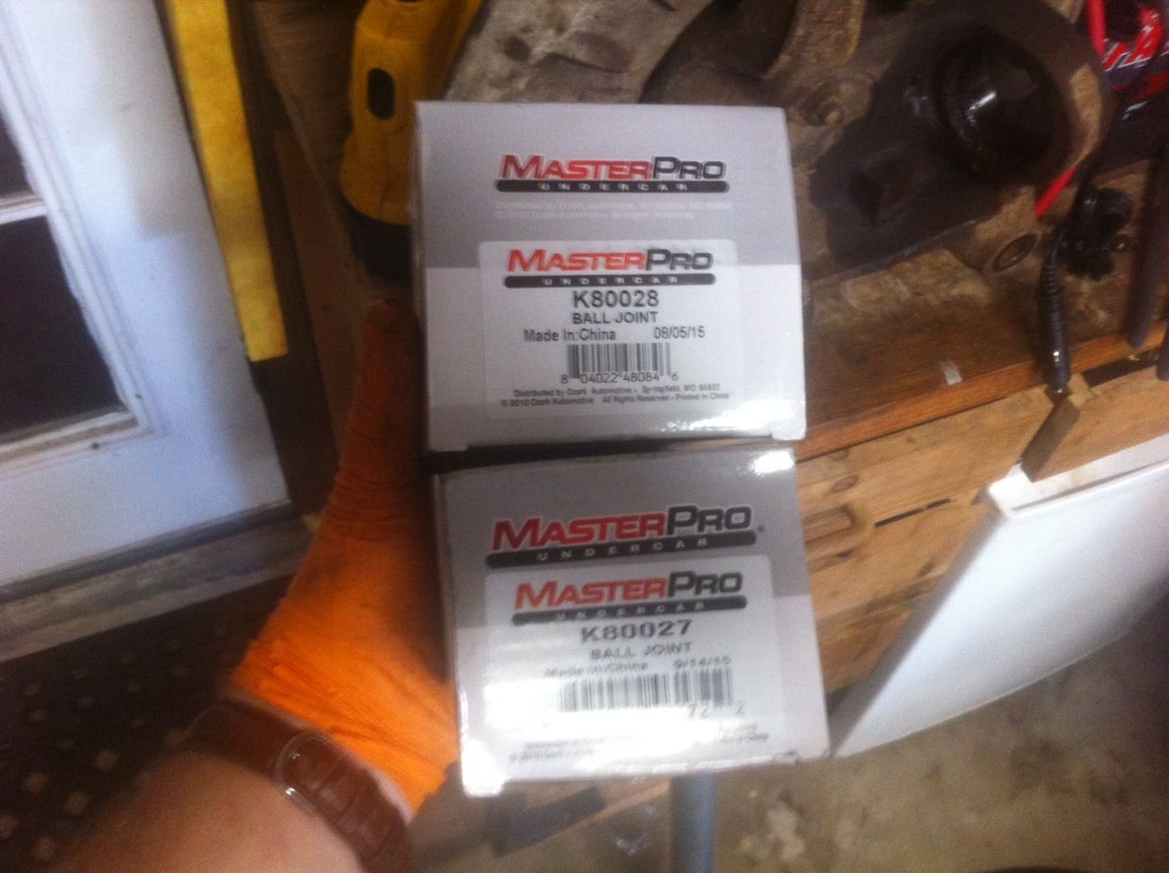

Sorry for the slow answer. Your avatar isn't kid friendly so spending any time on the thread at home is out.
Other than the special tools listed, the only thing I needed was the ball joints themselves. Parts numbers are in the pic on the tail end of post 500.
https://www.ford-trucks.com/forums/1...l#post16672726
Master Pro K80028 x2
Master Pro K80027 x2

Yeah ok I see the ball joints in there.
