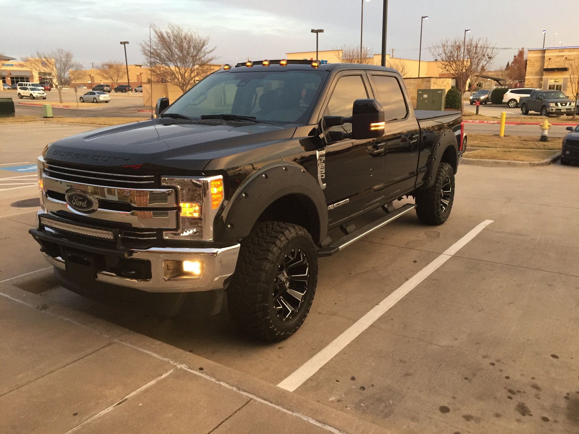

I had them installed on mine, but they're aftermarket LED's. I'll take a picture in a little bit.
Old Jan 24, 2017 | 08:33 PM
Skiline00's Avatar
Skiline00
Joined: Jan 2017
Posts: 27
It can be done...

Originally Posted by Skiline00
It can be done...
Looks great. Where did you buy the lights, and how much to get them installed?
Old Jan 24, 2017 | 10:51 PM
  #29
Skiline00's Avatar
Skiline00
Joined: Jan 2017
Posts: 27
They're Recons. A local 4x4 shop did the work and ordered the lights, not sure where they ordered them from. They only charged my $350 total but the owner admitted he under quoted me, said he had a guy working on it for the whole day. ��
Old Jan 24, 2017 | 10:54 PM
  #30
Skiline00's Avatar
Skiline00
Joined: Jan 2017
Posts: 27
He also added that once you pull the hardware, the headliner is held in place with magnets (not sure how this works with the aluminum roof), he said it was really easy to work with.
