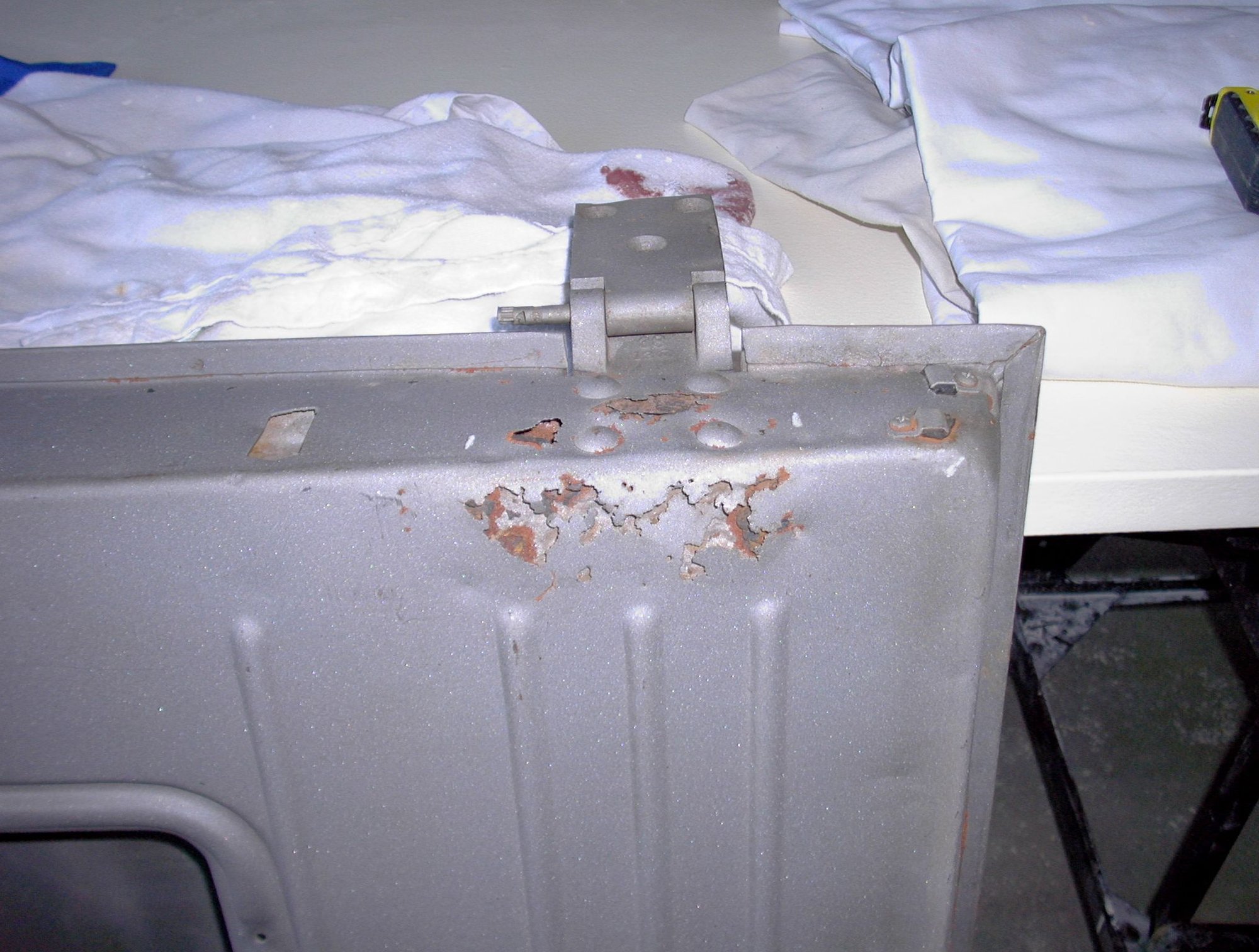

Here is one pic of rust damage around my door hinge that I removed and welded up. Can you buy 18 or 20 gauge metal to repair the door skins ?
